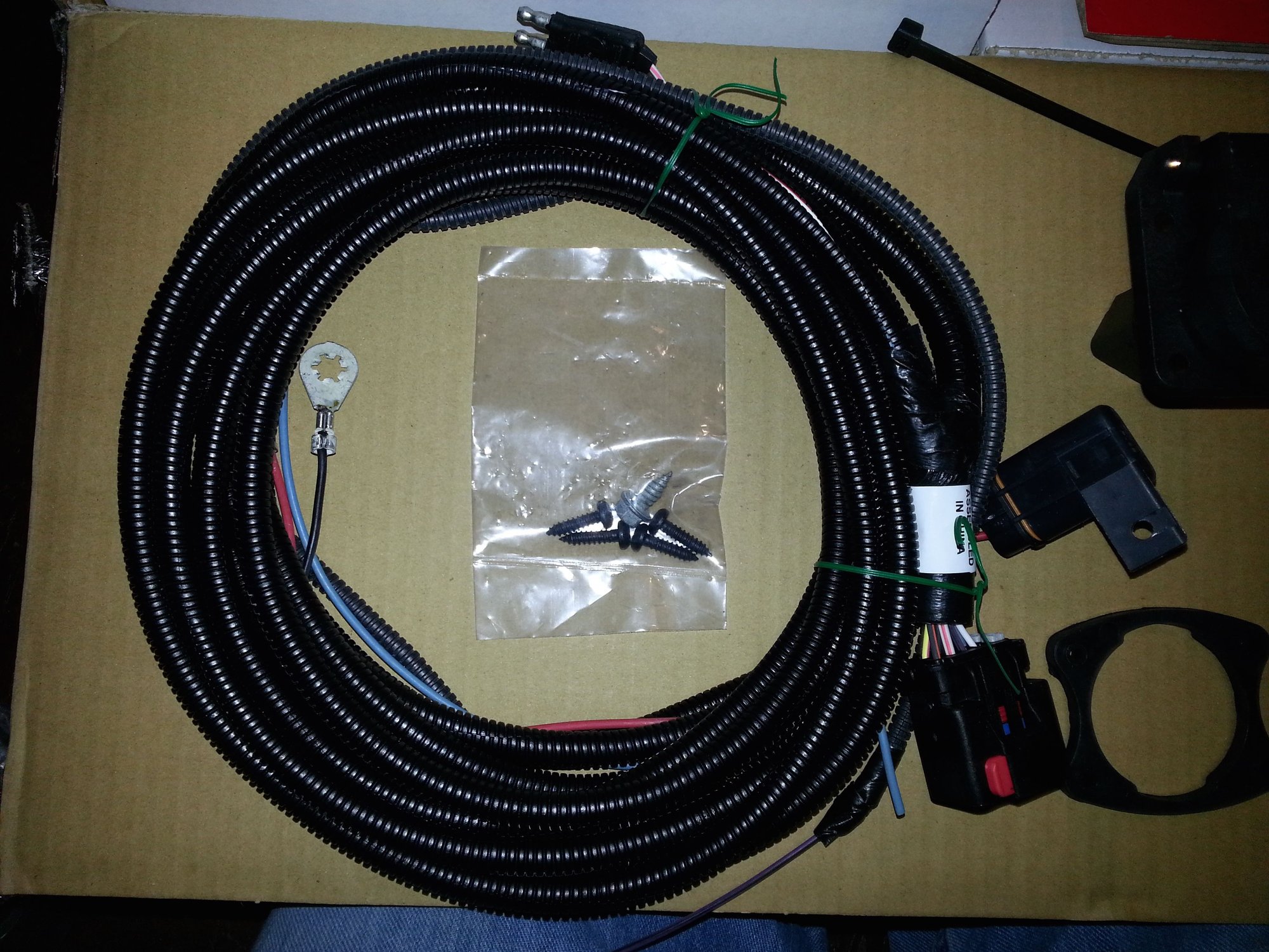

So I need to figure out what the actual "tow package" was for the Ram 1500. I know there was the factory wiring, that is a known factor, but not sure about what all else was included.. hitch/receiver of course.. and I "think" a special shifter (automatic) that has a graphic for you to push the "OD" off when towing.. not sure on that, but other vehicles who have towing have that type of graphic so it makes sense. I already have a trans cooler on the truck, just the static cooler, nothing fancy.. and I know on tow vehicles they always have an auxiliary trans cooler...

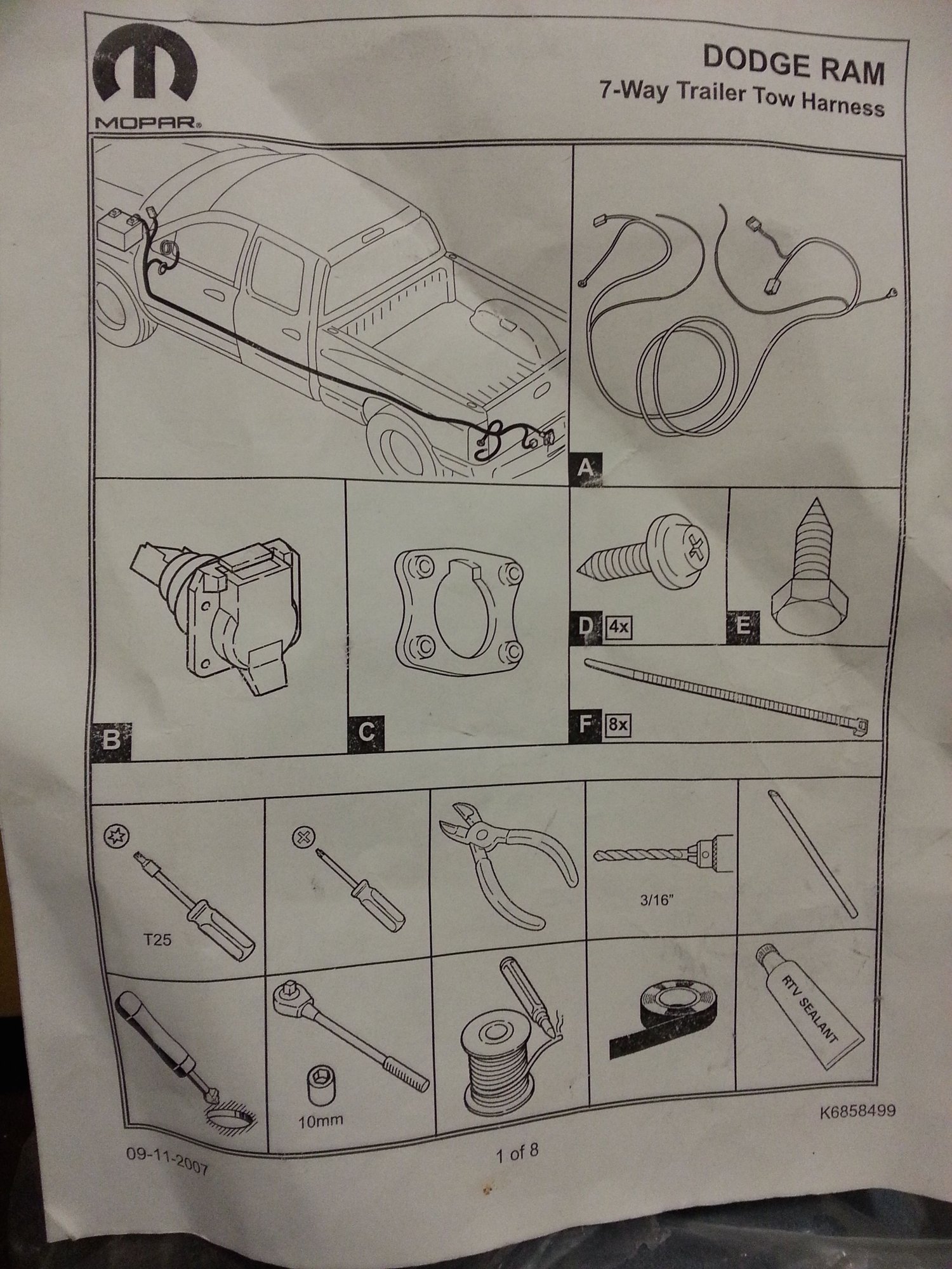

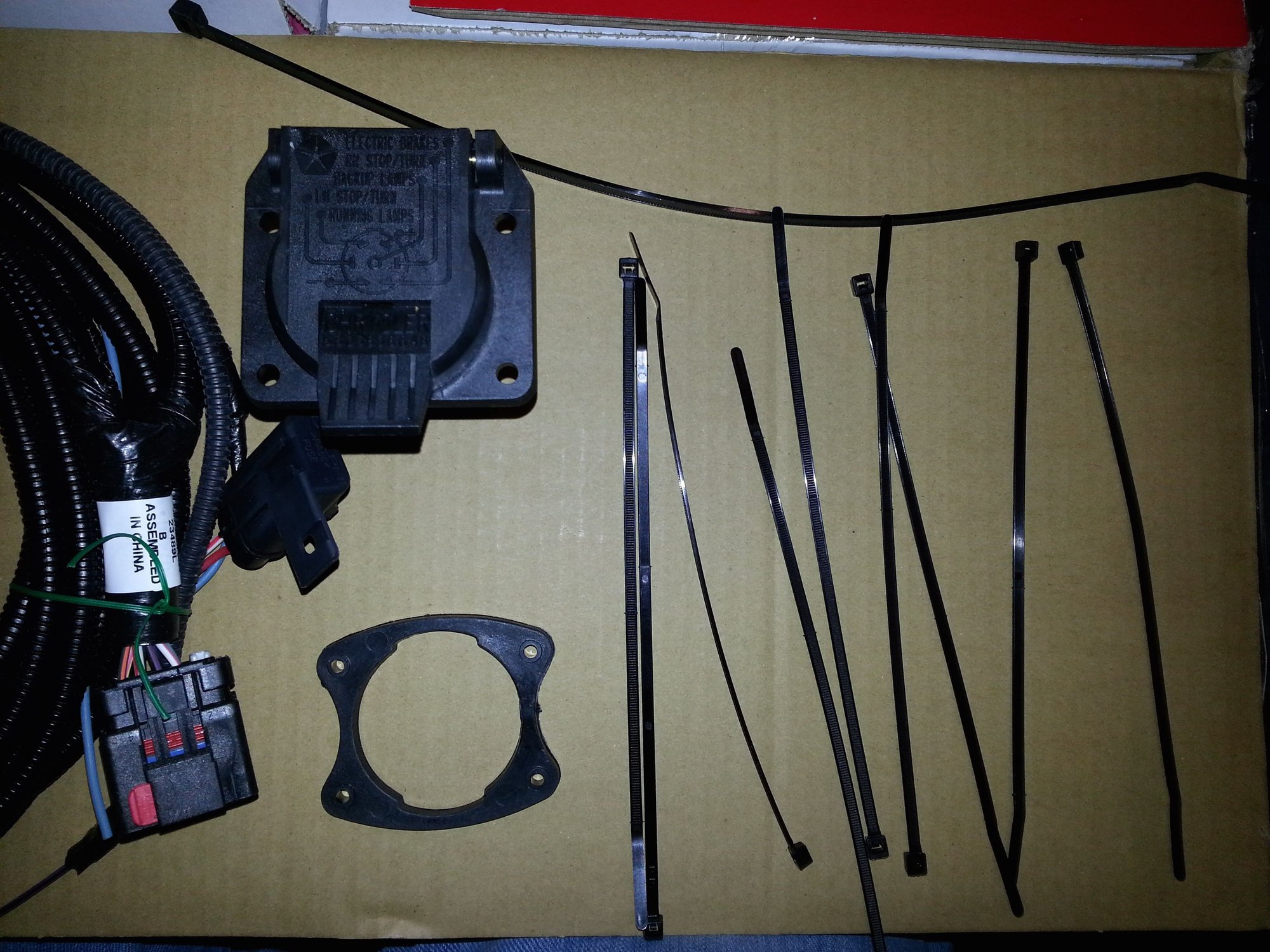

Above was taken from my "build" thread. I need to know what all is included in the "tow package" as I want to add in all there is "FACTORY".
Here is the factory tow harness:
Having issues uploading pics. I am going to see what is up and come back and refresh this thread..

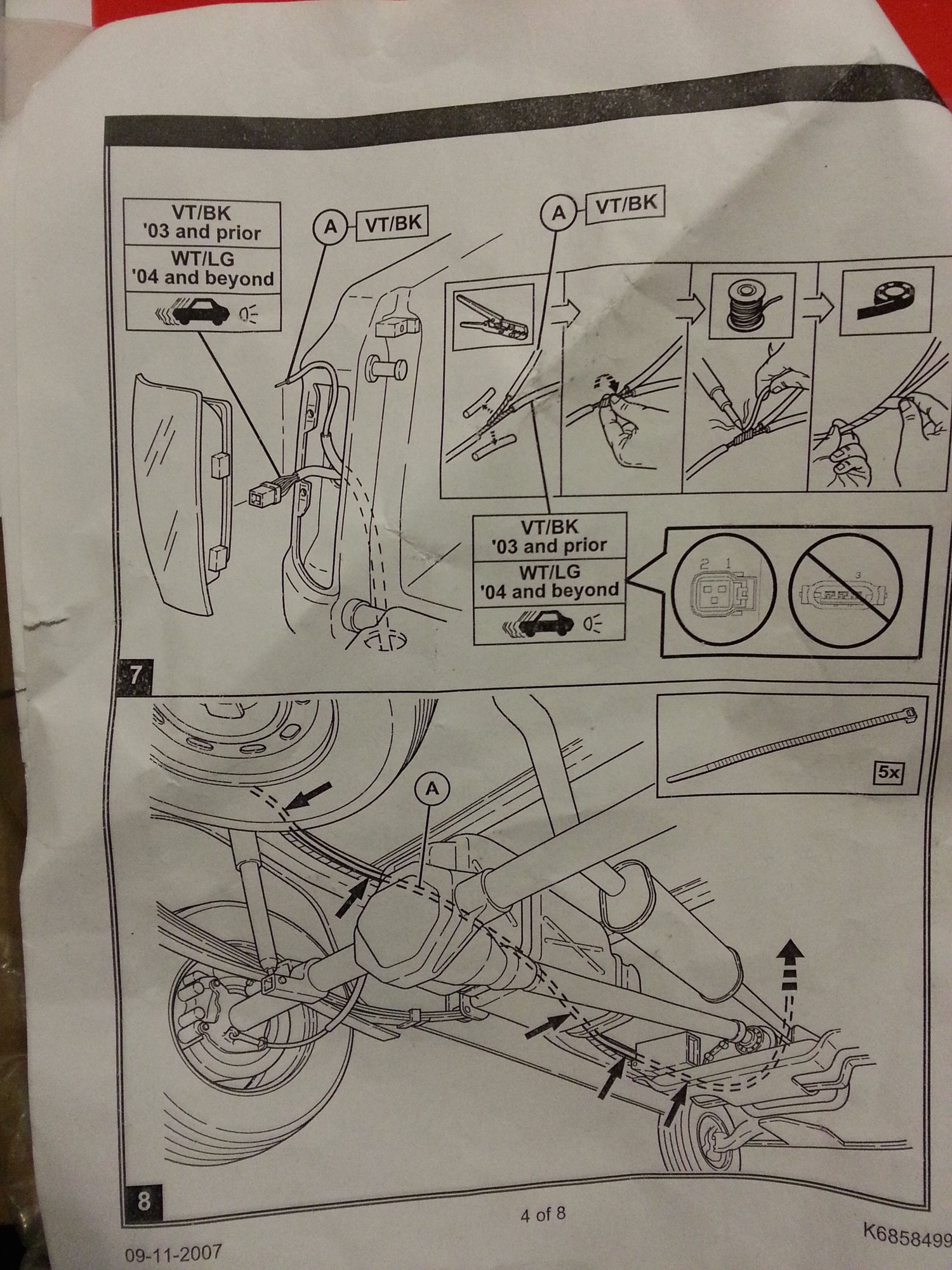

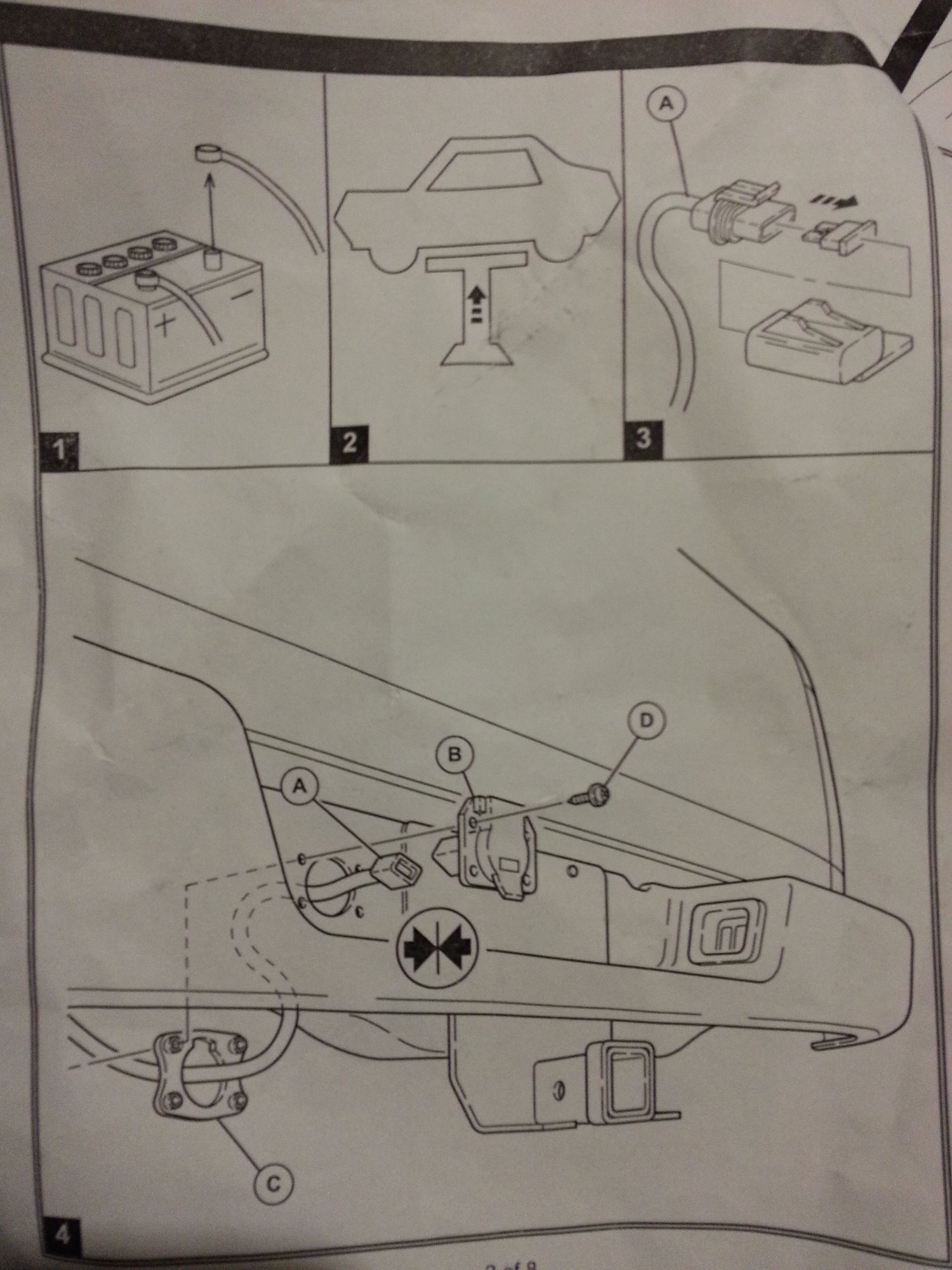

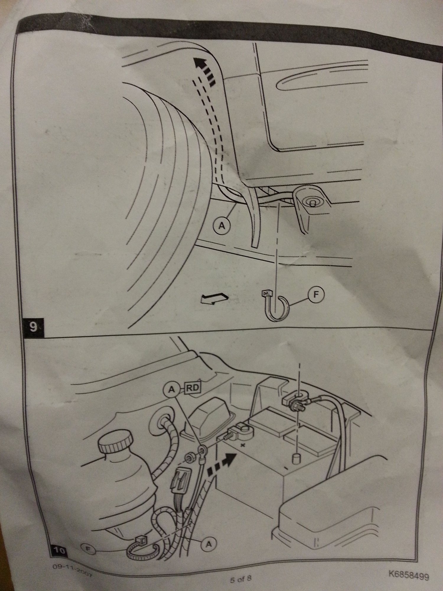

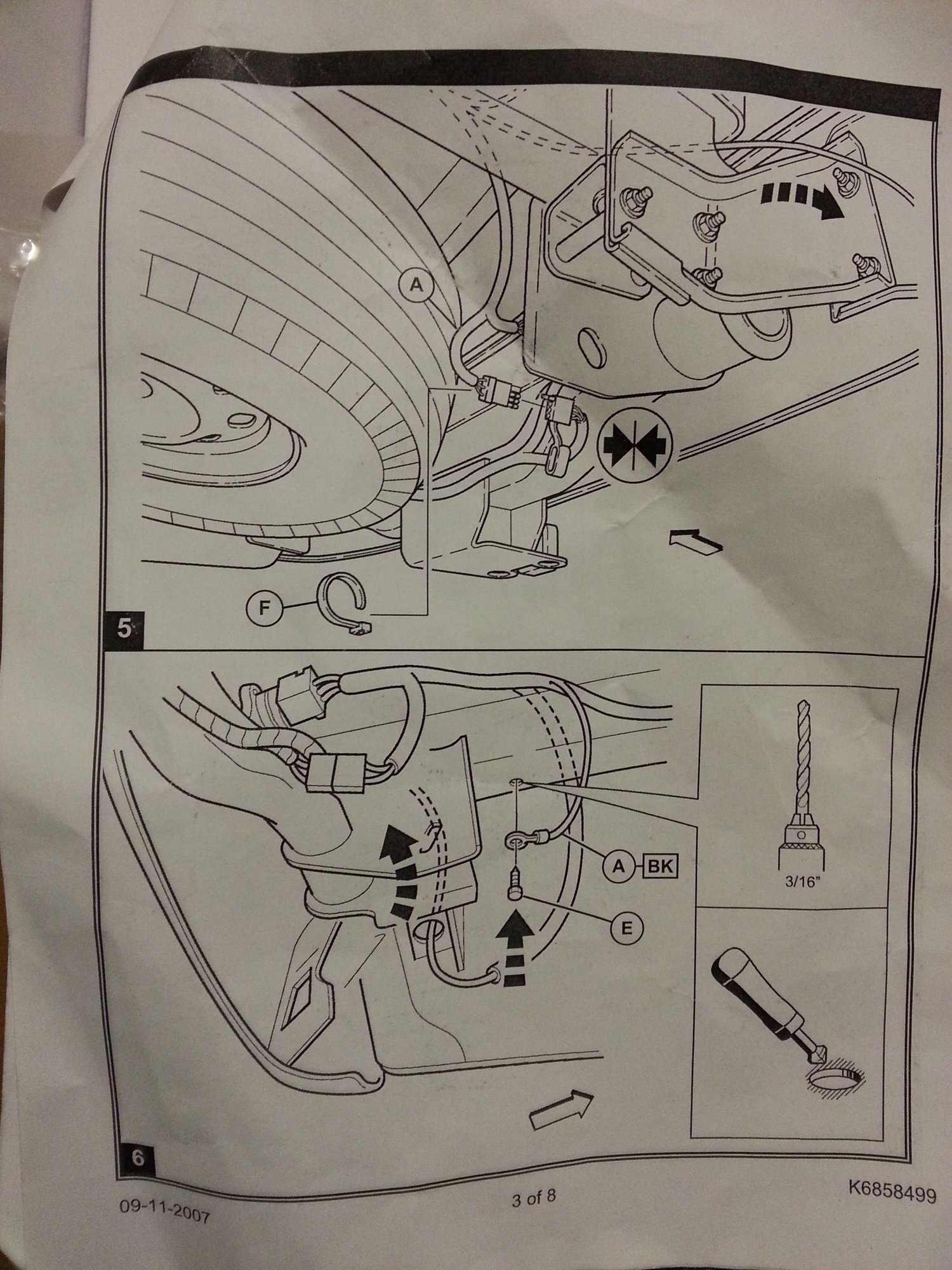

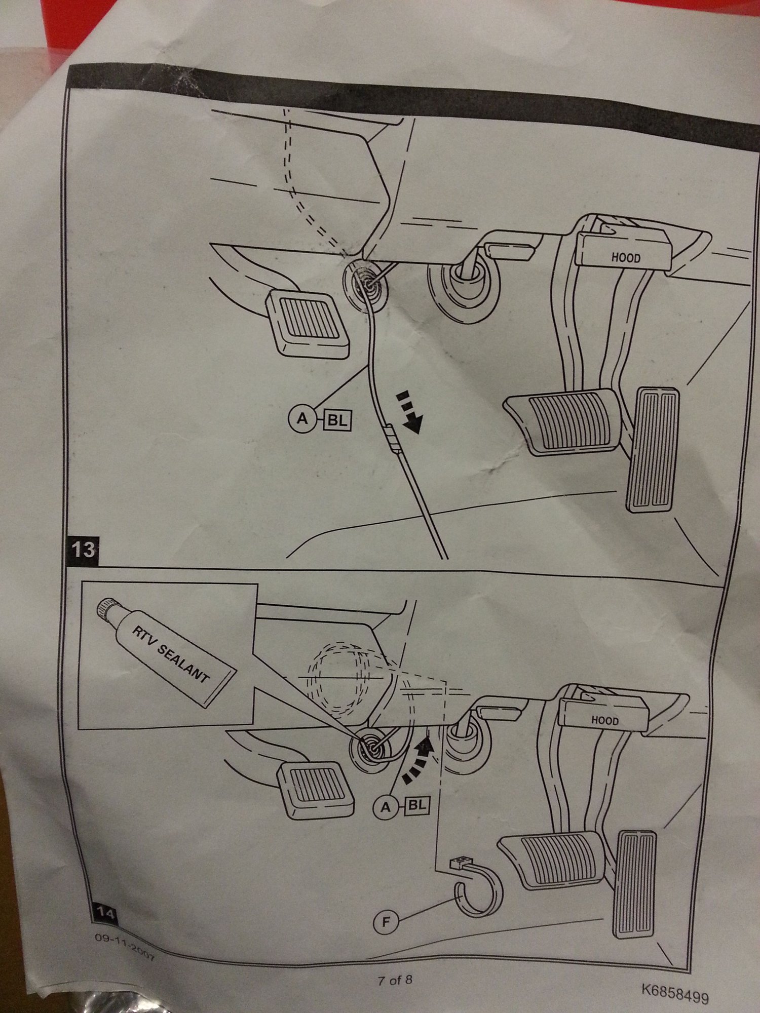

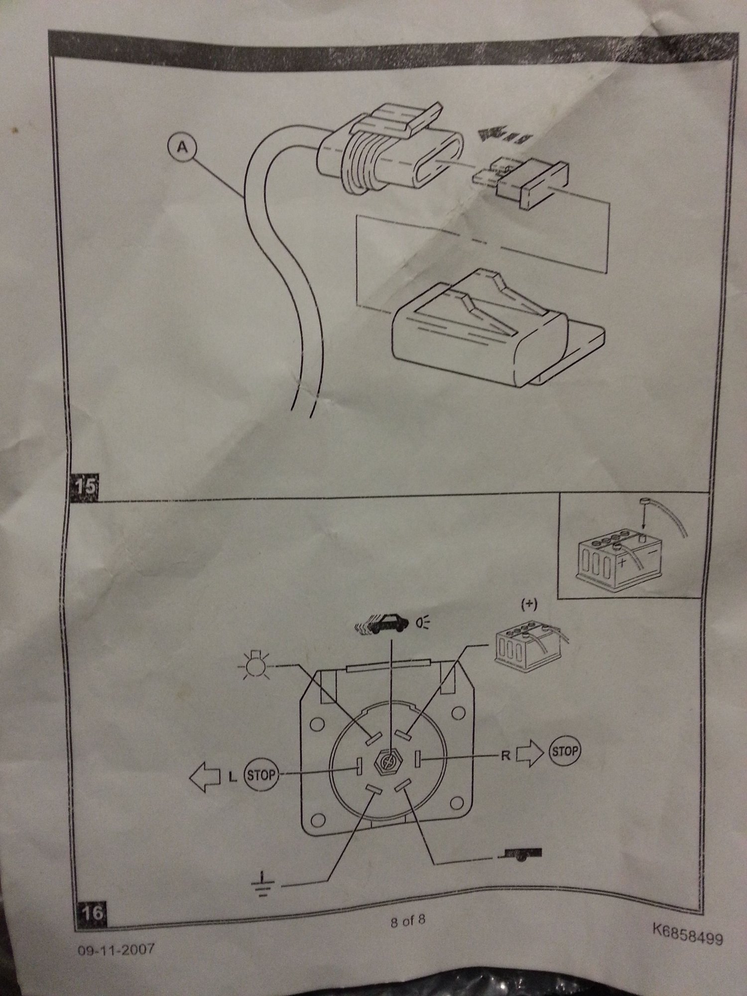

Instructions for the install:
Page 1
Page 2
Page 3
Page 4
Page 5
Page 6
Page 7
Page 8
