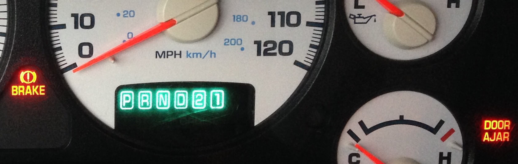

So i got a start problem of my hemi. The problem dont occur all the time.
Sometimes, when i try to run my engine, he dont start. I ear a click but i need to insist several times to be started. (4 or 5). Someone told me that it can be the starter. It is not the starter cause i have changed it today. Spare plig have been changed, relay have been checked.
Other one told me that it can be the solenoid into the transmission. The solenoid dont see the neutral position, so the engine cannot start properly. I have also a strange display on my board. all the selector have little square on it. Parking, neutral, reverse, drive, have a square displayed on it. Maybe somebody have already seen that?

Well, i just ear a tick but the engine dont crank. After several try, it start. What about the little square on gear position?

Seems that the problem is not resolved. Anyone got this squares on dashboard?
Sensor Position camshaft problem?
Valve body with solenoid problem?
Other?

I cleaned the ground on the engine, it seems that it resolve my problem. My engine start at first ignition, and i dont have anymore squares on all gears. I need to see on next days, if it is really fixed cause as i said, the problem dont occur all the time. Thanks to the man who gives me this advises.
