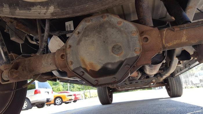

Ok, so, I have a 2004 quad cab 4wd hemi. This rear end issue is making me paranoid. I've noticed some "oil spots" on the rear end which heightens my worries. I'll add some photos tomorrow.
Can you all break this down for me. Where is this magnet located? How often do you recommend fluid changes? What am I waiting for to detect an incoming fail, just the noise? Can I do anything to help prevent catastrophic failure before it happens?

As for the differential, it is at the bottom of the housing when you take the cover off of it.
How long has your truck sat not moving/not running? Your "oil spots" are probably because gaskets, seals, and hoses dried out from not having fluids moving around them to keep them soft. I'd inspect everything made out of rubber and make sure that you aren't going to blow a hose or belt soon. Low miles isn't always a good thing.

On "back", do you mean by the driveshaft? Is your truck in the pool for the rear pinion seal recall? I'm not sure of exact years, honestly. My 2005 was.
Trending Topics
Anytime the rubber plug is pulled to check the fluid level, it'll drip some. Spray some brake cleaner on it and watch for new stains to appear. If it appears around the plug, it could be over filled or need a new plug.
SJ03
SJ03
Time to take the diff cover off and check for anything on the magnet and reseal it with Mopar rtv and refill with Mopar or better 75w-90(????)and 4oz mopar additive. May want to look at the front too (75w-140)
I have never personally seen one just start to leak like that but the seal is 12-13 years old!
Did someone jack the rear end up with a floor jack recently? I always keep a piece of wood on my jack especially since I put the mag hytec diff cover on!
I would not stress about that unless you find the fluid is coming from the front where the drive shaft comes into it. If is has been sitting for a long time it may be the reason. Often times much worse on a vehicle to sit than to be driven due to seals drying up from lack of lube!
