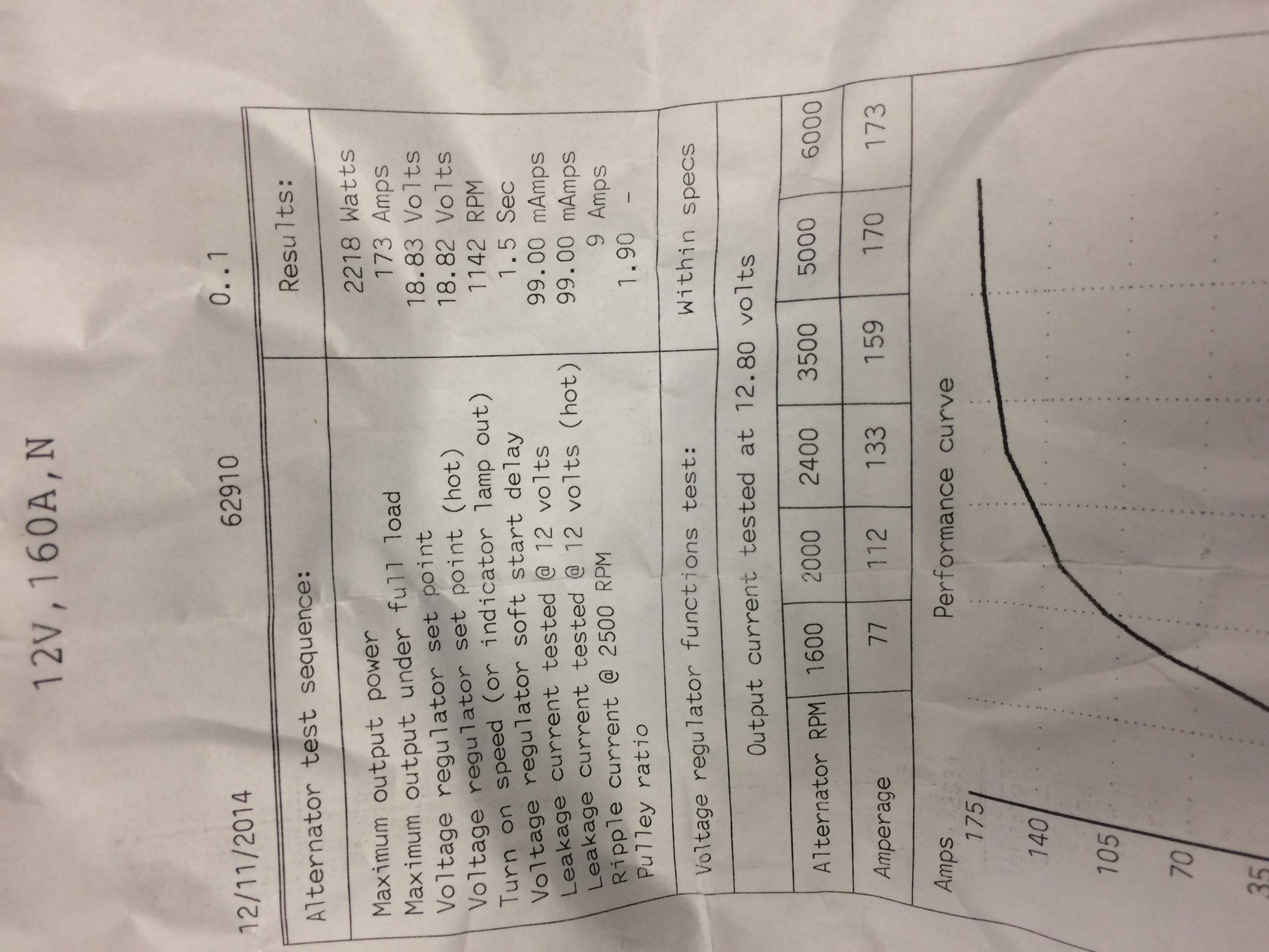

I got a OEM set of fog lights a few years back and noticed that when I have headlights on with them and the truck drops to the 500rpm idle they show some signs of dimming. Especially if I hit the windows at the same time.
When I first noticed this I purchased an alternator that pushes 173 amp max and is rated at 160 amps.
My truck came with a 136 amp alternator and also states 136 is max on build sheet.
Is this the largest the trucks' wiring will accept or am I ok in replacing the less amperage unit out for the higher one?
Unfortunately my year truck does not allow changing of idle with my tuner.
The last thing I want to do is cause some problems in my electrical/ecm due to using a device not rated for the circuit.

You will be good. The truck will only draw what it needs. Lights dimming is a common issue. Make sure you have a good battery as well.

Yep. Mine came with a 136a and when the bearing went I upgraded it to the factory 160a. Voltage regulation is controlled by the PCM, like jfotsch said, it will only draw what it needs. If you have a battery issue, that can cause all kinds of problems that a higher amp alternator will not solve.

That is normal at 500rpm, with the lights, blower and other stuff running. Not too many alternators can charge that much at 500rpm. I wouldn't worry about it. My 08 has done this since day 1.
