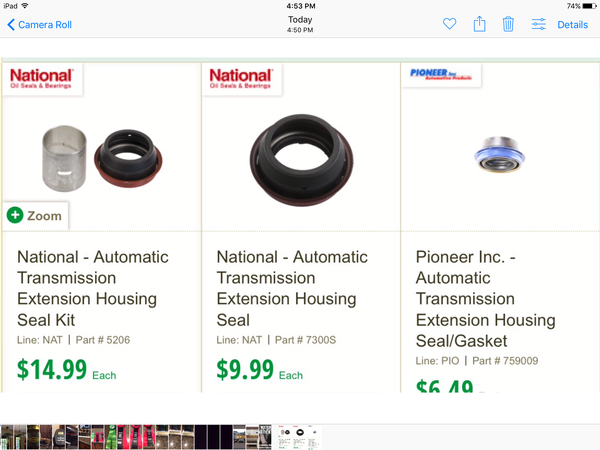

This is the seal I need. Extension housing seal. Some come with the metal sleeve possibly bushing.

You only need the bushing if the shaft is grooved. It keeps the seal from getting damaged. For the extra money may want to order the one with the sleeve just in case. It's pretty simple to do. You may even be able to borrow a seal puller. A screw driver will work, be careful not to hit the shaft.
