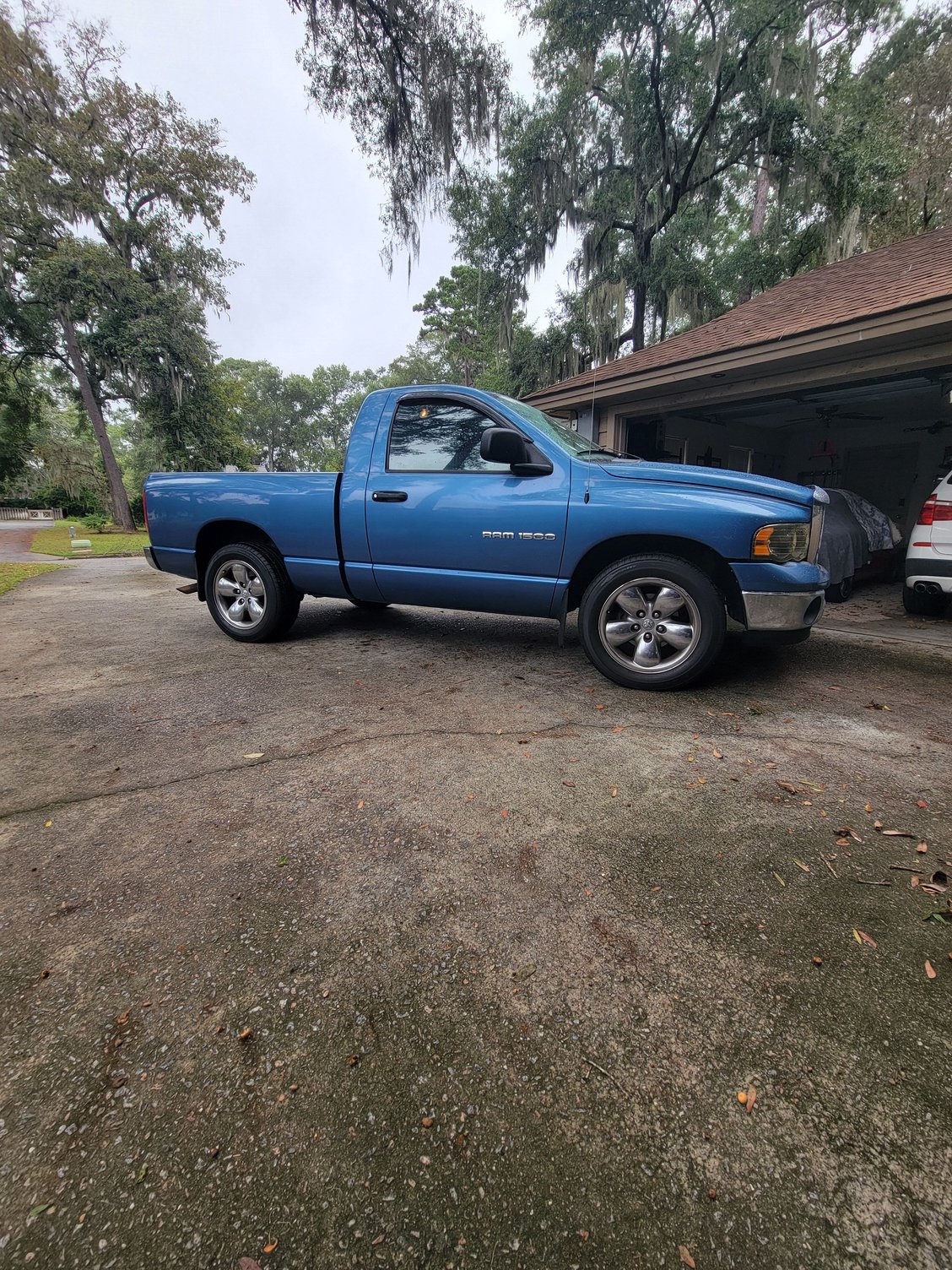

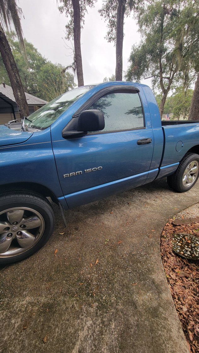

I see it was hijacked now haha but good work. Let's see more pictures of that single cab I got 2 of them 2003 and 2005
