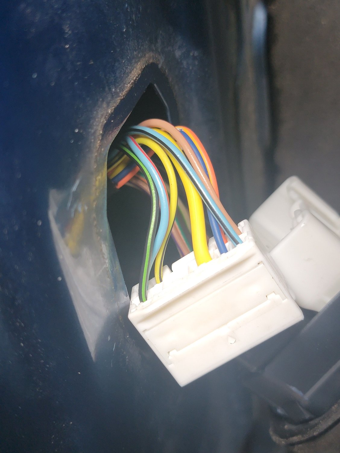

The cause of my problem is no power at the passenger side window switch via the heavy gauge yellow wire. I pulled apart the connector at the door jamb and verified there's no power coming into the door from the jam. I probably just run a new wire from the circuit breaker to the door.

Yellow wire with no power supply
2003 reg can 4.7l
2003 reg can 4.7l

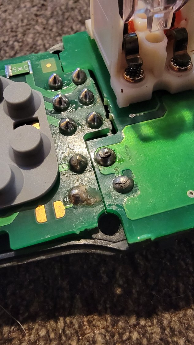

Yep, goes back to the drivers side switch, Connector 2, pin 8. Technically, its the 'window module', but, I believe that the drivers window switch is attached to it.....
Thanks you were right. I discounted the yellow wire coming out of the driver side window switch is being part of the power mirror system. The yellow wire on the driver side goes to the passenger side switch for power. I saw the YouTube video of the commonly occurring loose solder problem for that yellow wires pin. I just heated up the solder and reset it problem solved. I shouldn't have assumed that yellow wire was for the power mirror circuit.
