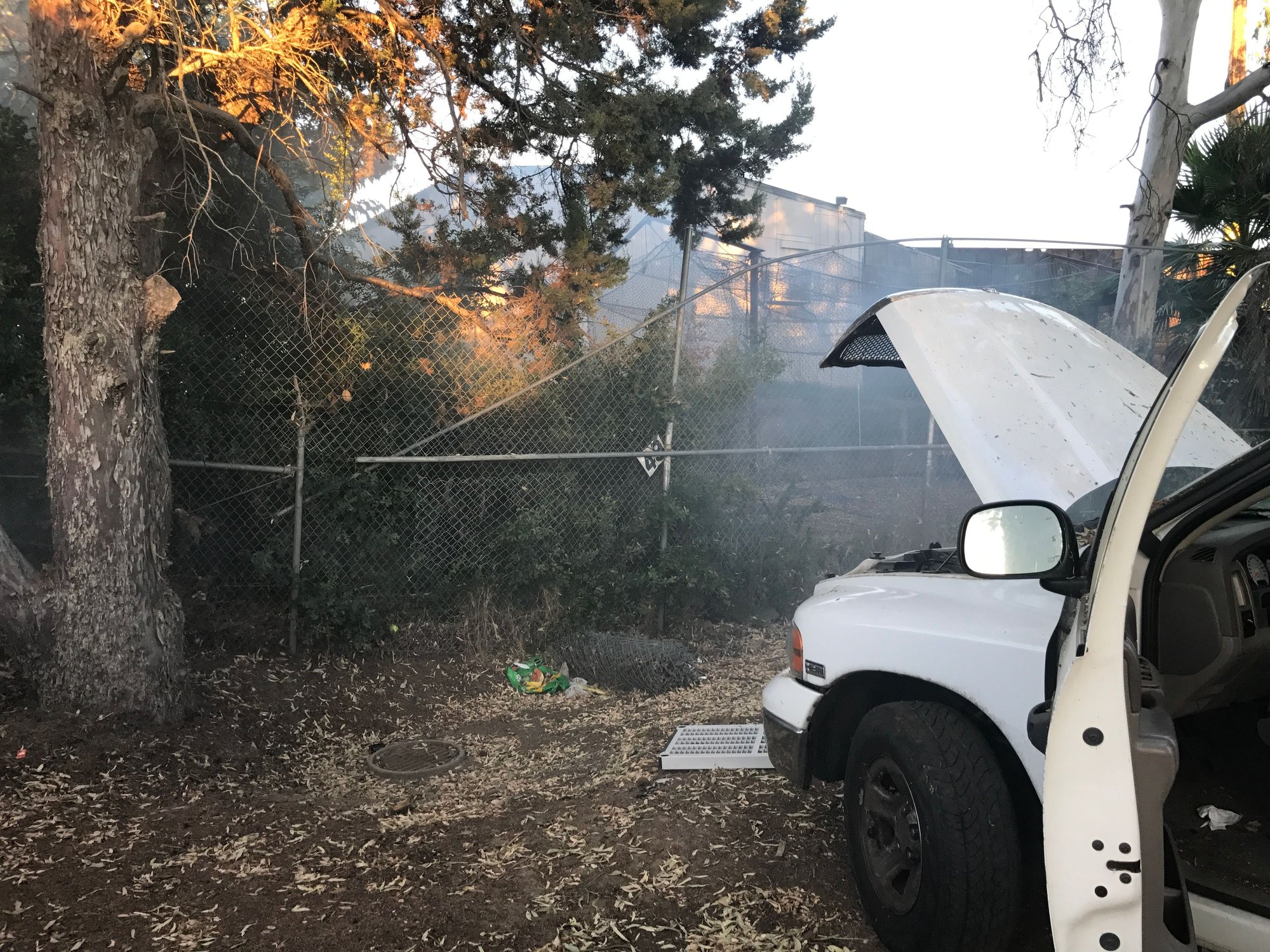

However to my dismay, when I finally got this bad boy to turn over and fire for me all I got was a very low, rough idle accompanied by a beautiful white cloud of smoke.
Now I know what you're thinking, because I was thinking the same thing... headgaskets or heads are done, probably why it was parked, right?
Well here's the problem... I've run this truck for a solid 1.5 hours at idle (plenty of times it died and got started back up).
Now, when I say it's putting out a lot of white smoke, IT IS PUTTING OUT A TON!! You would think a steam engine was running under the hood! Haha
One would venture to assume that if it is capable of putting on such a smoke show, it'd be using up a decent amount of water? Not the case here... I pulled the cap today and it was FULL!!
In my opinion the smoke is very heavy, slow moving (not like mist) and smells like rotten eggs, not great.
I believe it is unburnt fuel, is that a reasonable assumption?

There's no way it's not oil at this point, still need to do a compression test though..
My apologies for being colorblind, the smoke has a blue hue to it and lingers for a loooong time, stinks like oil too.
It stumbles at 2k rpm, fine after that, idle is bad to say the least.
No displayed codes, I'll hit it with my code reader next chance I get just to see if it's hiding anything.
