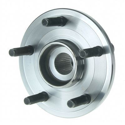

On an 02-08 (and probably beyond) 1500, 2wd and 4wd wheel hubs are the same, only differentiated by what type of ABS system installed in the truck (whether the sensor is there or not). Even the 2wd hub has splines in it. This is the specific hub for my 03 2wd.
