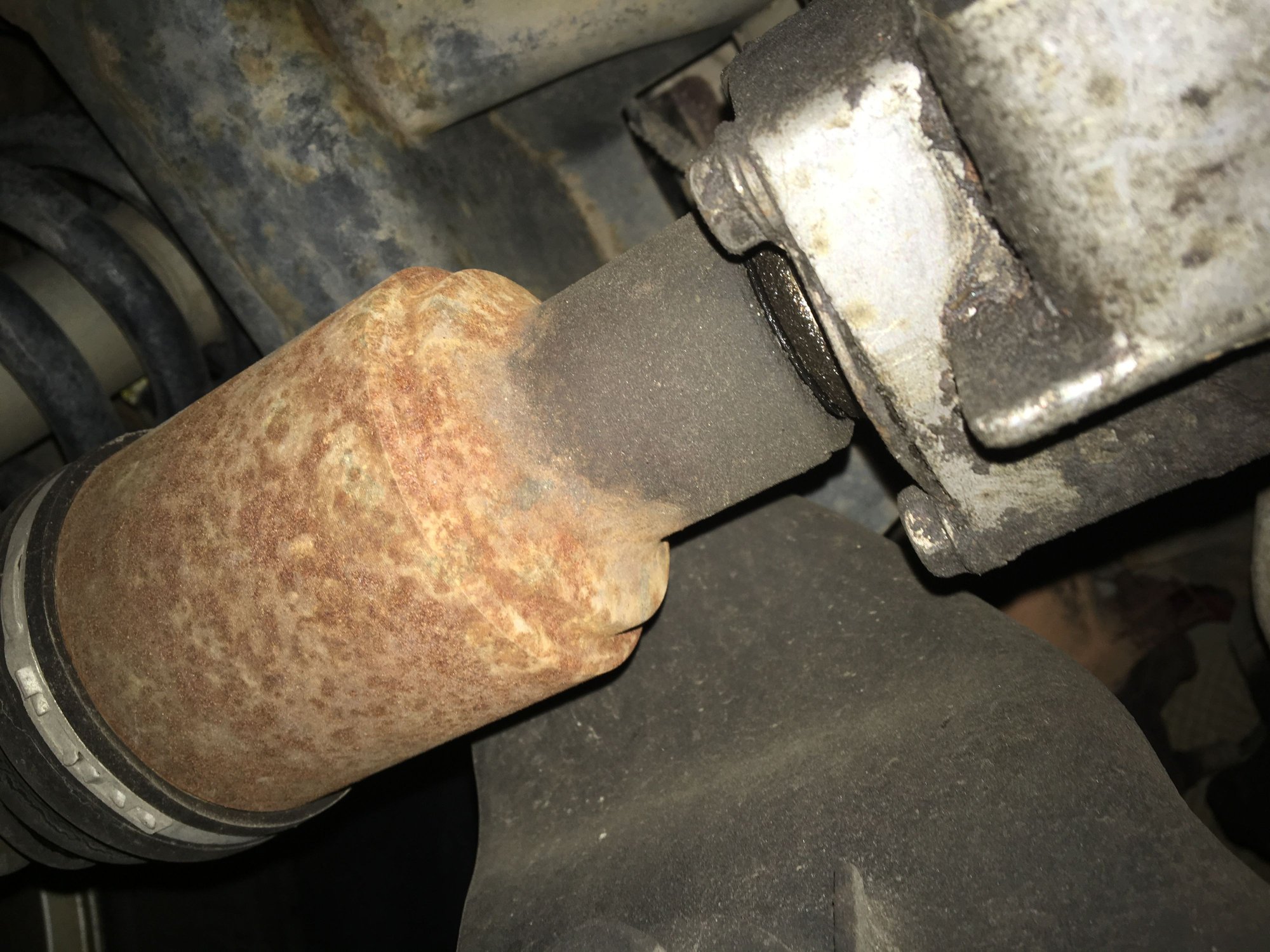

May have found the problem... does this front axle (cyclinder going into the silver square with bolts) move around by hand on anyone's truck with no issues? Hopefully this is it. If any of you could verify this from there truck I would greatly apprieciate it.
