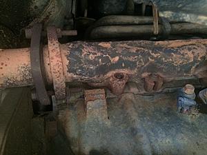

The old Hemi has what seems to be a common issue where the bolts on the rear exhaust manifolds on cylinders 7 and 8 are broken. It is ticking and puffing now more and more so I will have to deal with it. The heat shields are also corroded off and rattled loose in the engine bay. I just grabbed and pulled and they both fell out.
