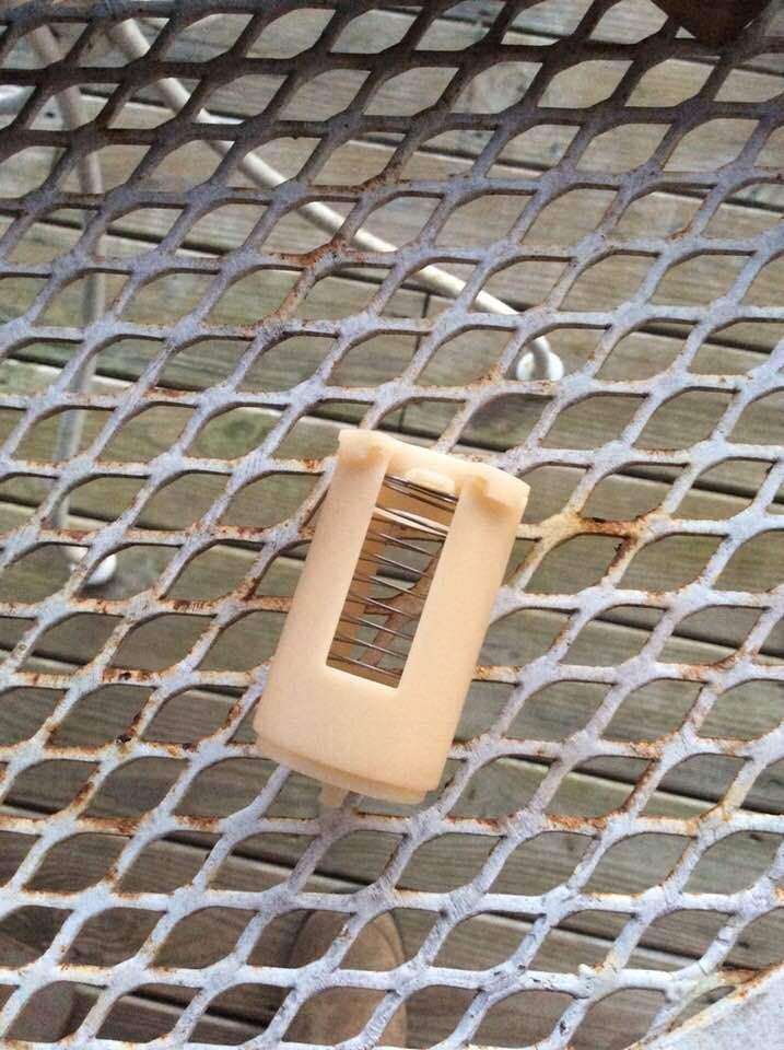

Does any of you know if this is part of the fuel pump ? It was laying at the bottom of the tank .

From pics ive seen online i dont see it on the pump
