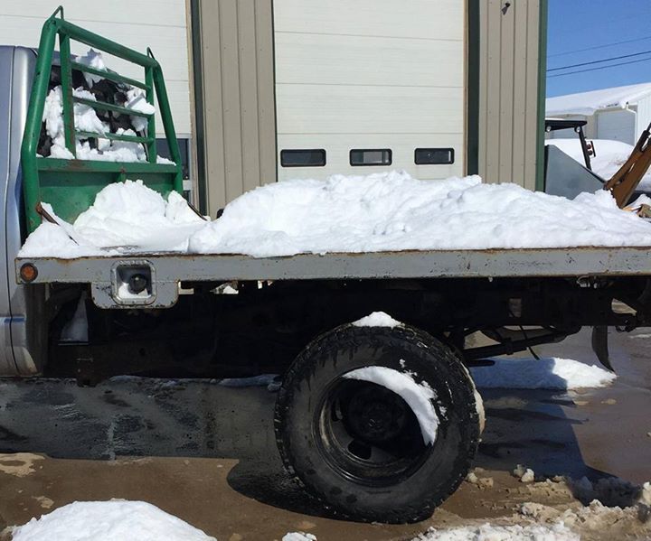

I have the option to buy a flat bed off a 2003 Dodge Ram 3500 4 door dually.
The flat bed is 9 foot long.
My question is, would the frame and bed connections be the same?
The guy is offering me the use of his shop, equipment, loader, hoist and will assist me in the process.
I have removed truck beds before and built small homemade flat beds for Rangers and s 10 before.
How long do you think it would take with zero problems, a simple un bolt and swap take...
The photos are of the truck and bed that I am wanting to install on my truck...
The blue truck is my truck. They are both normal trucks and are not fleet or straight frames.

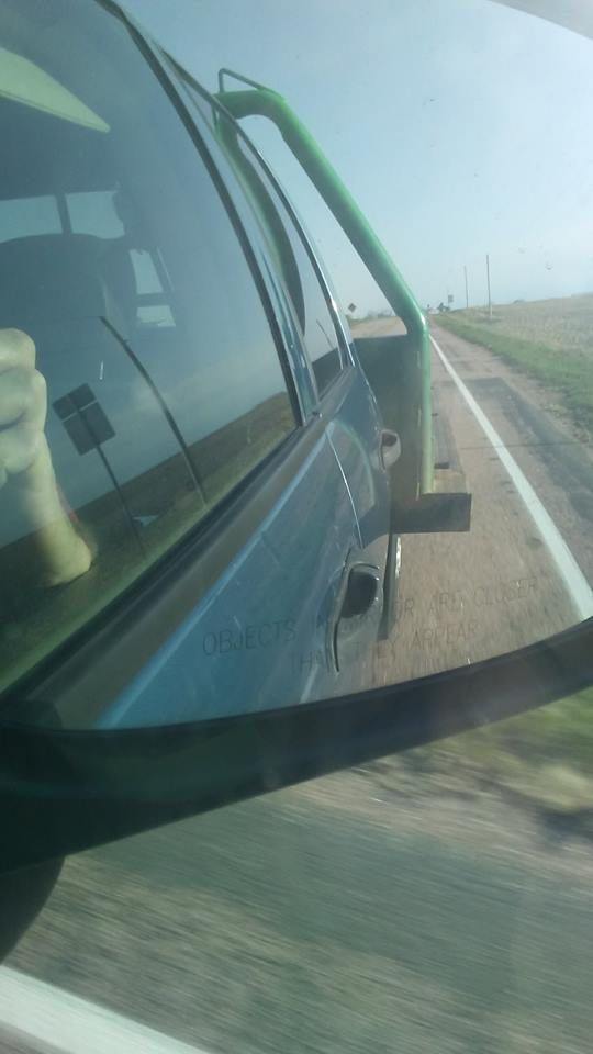

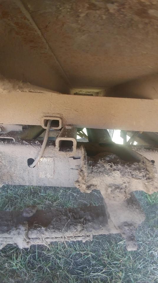

Went today and installed the flatbed, I arrived at 11:30 and the guy had it on a 2 post lift, It took about 15 mins to position it under the lift.
It took about 20 mins to wiggle it around to line it up. Then another 30 mins to raise it and drill out the 2nd from cab riser mount as the holes were too small,
Then another 30 mins to beat on it and wiggle it again, we lifted the bed and reamed the holes a bit more then and got the bed in.
It took all of 2 hours to do that. Then about an hour talking and thinking if we should tackle the lights and decided to tape the lights from my box on to the flatbed bumper.
We left at 2:30pm
The Bed is 8 food wide and 9 foot long
Sunday I was able to remove the bumper and the bed in about 2 hours.
