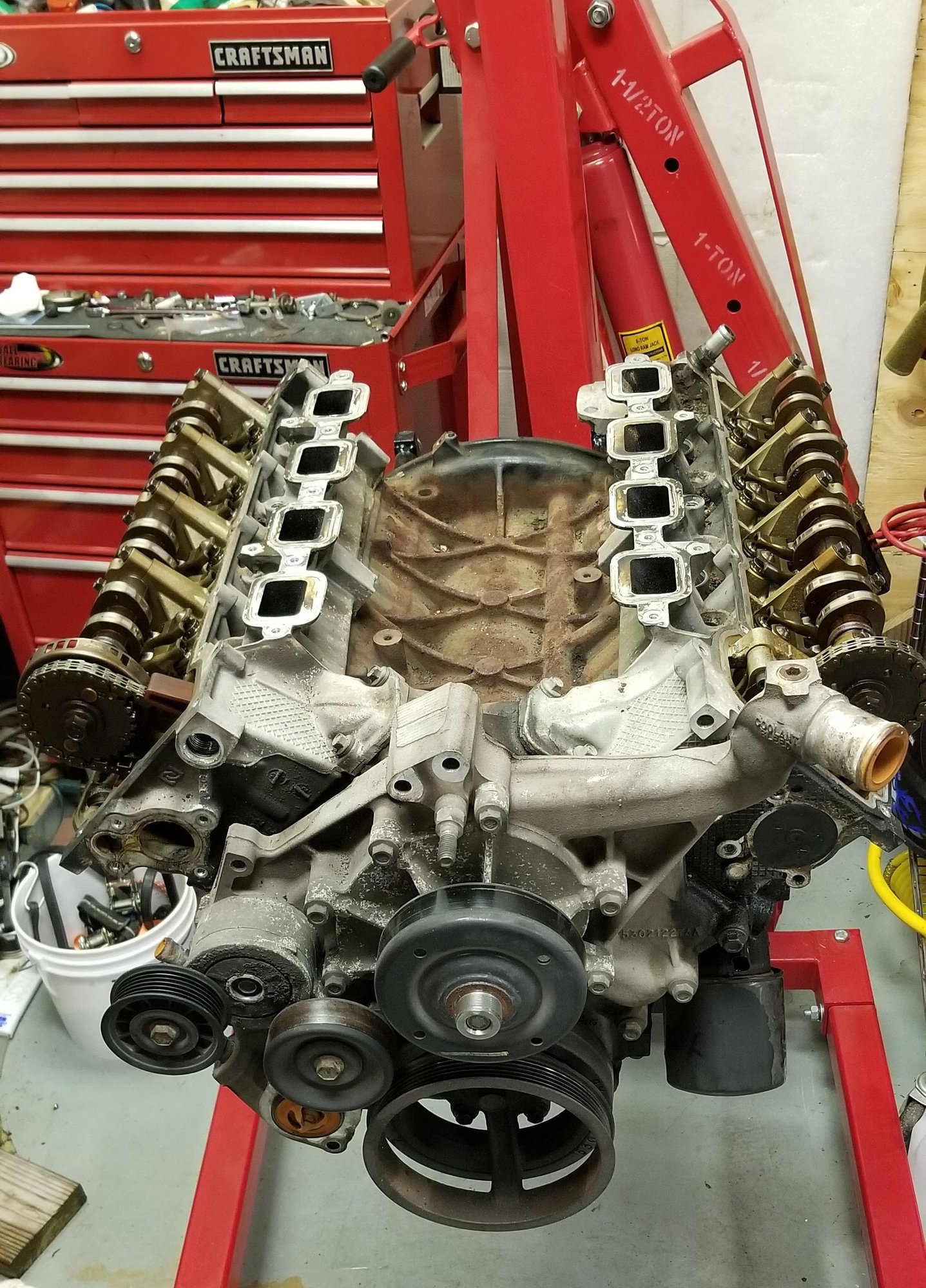

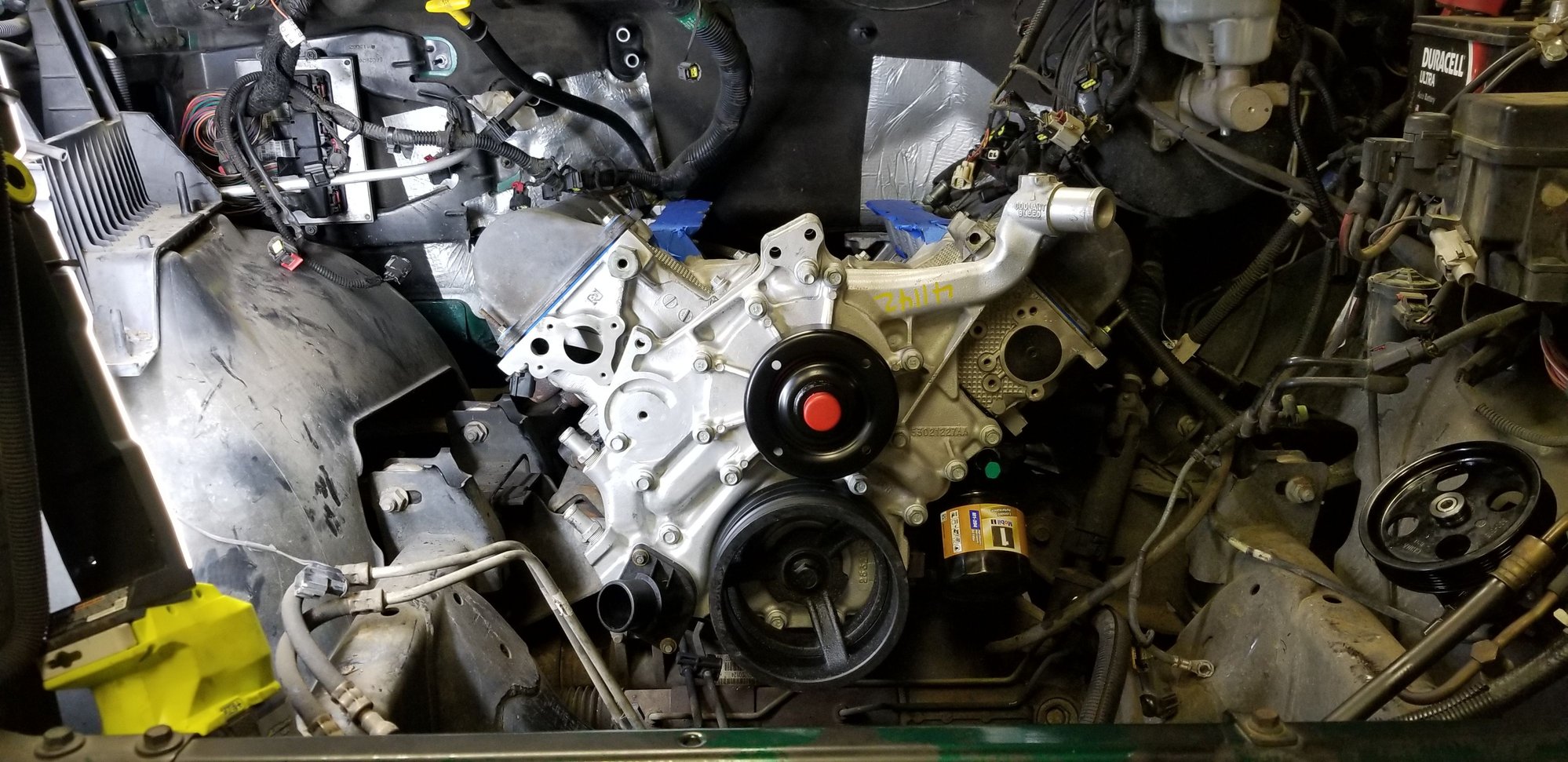

Spent the next few nights after work getting the engine ready for install by bolting the exhaust manifolds and mounts on. I also replaced the leaky power steering pump since I had great access currently and that became a BEAR because I didn't figure out until I'd struggled a bunch that the OEM pulley isn't intended to be reused. I finally got the new engine settled into the frame on November 29th. It was very much a wrestling match and that driver's mount was a problem. I wound up having to unbolt it from the engine and the settle things almost into place before bolting it back to the block.

I was tired on Friday the 30th so I didn't do much but on Saturday, December 1st I decided I was going to thrash to the end. I started about 10:00 that morning and finally shortly after 8 PM I got to hear it run for the first time:
