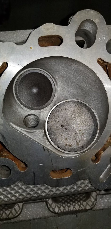

Over that hurdle I started moving along pretty well. Heads were next but it was not without issue. I manage to let the left side slip during install and that cost me a head gasket and I had to have my friend clean up the surface (thankfully at no cost). But by July 20th I had both heads on and torqued.

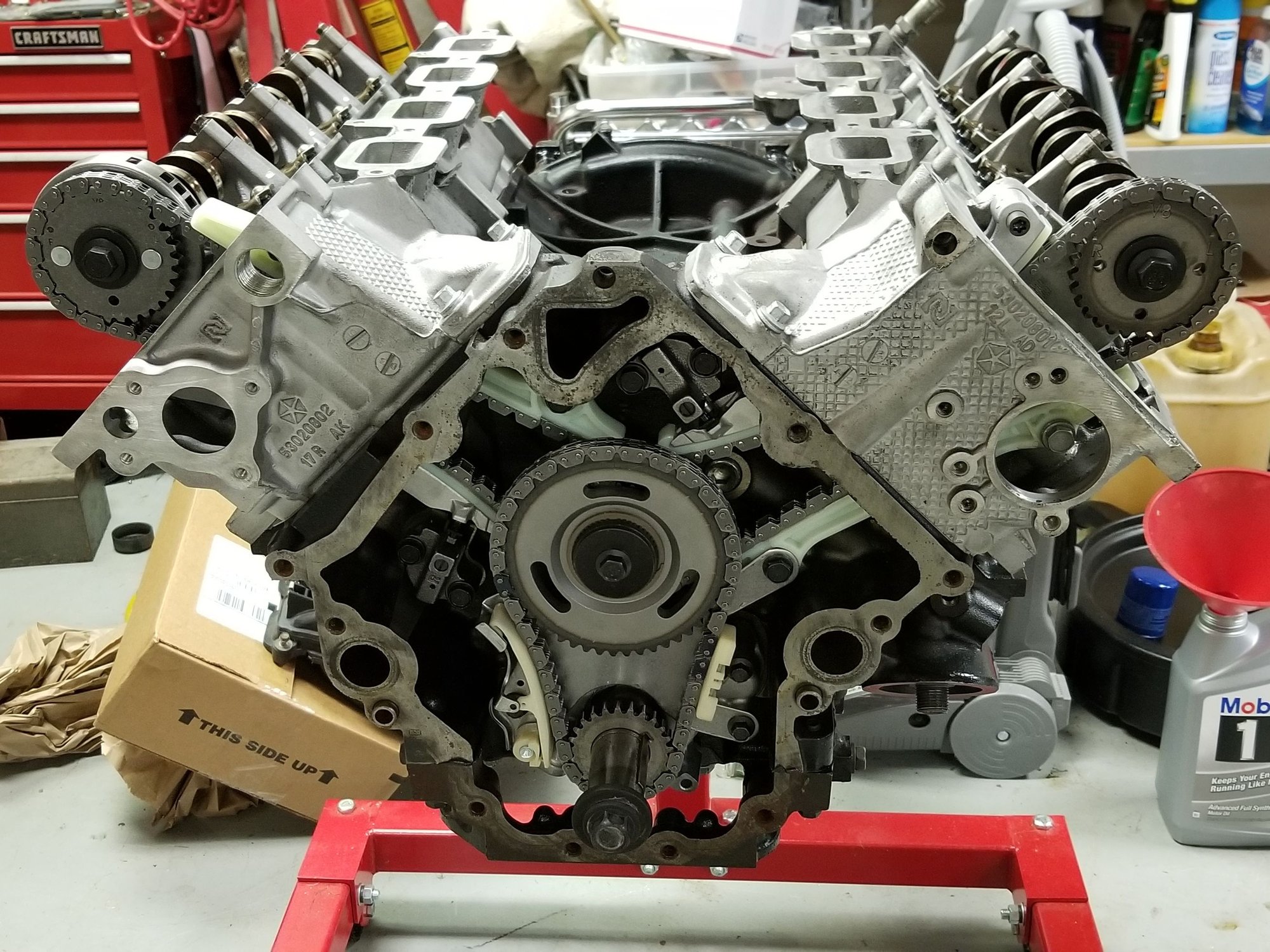

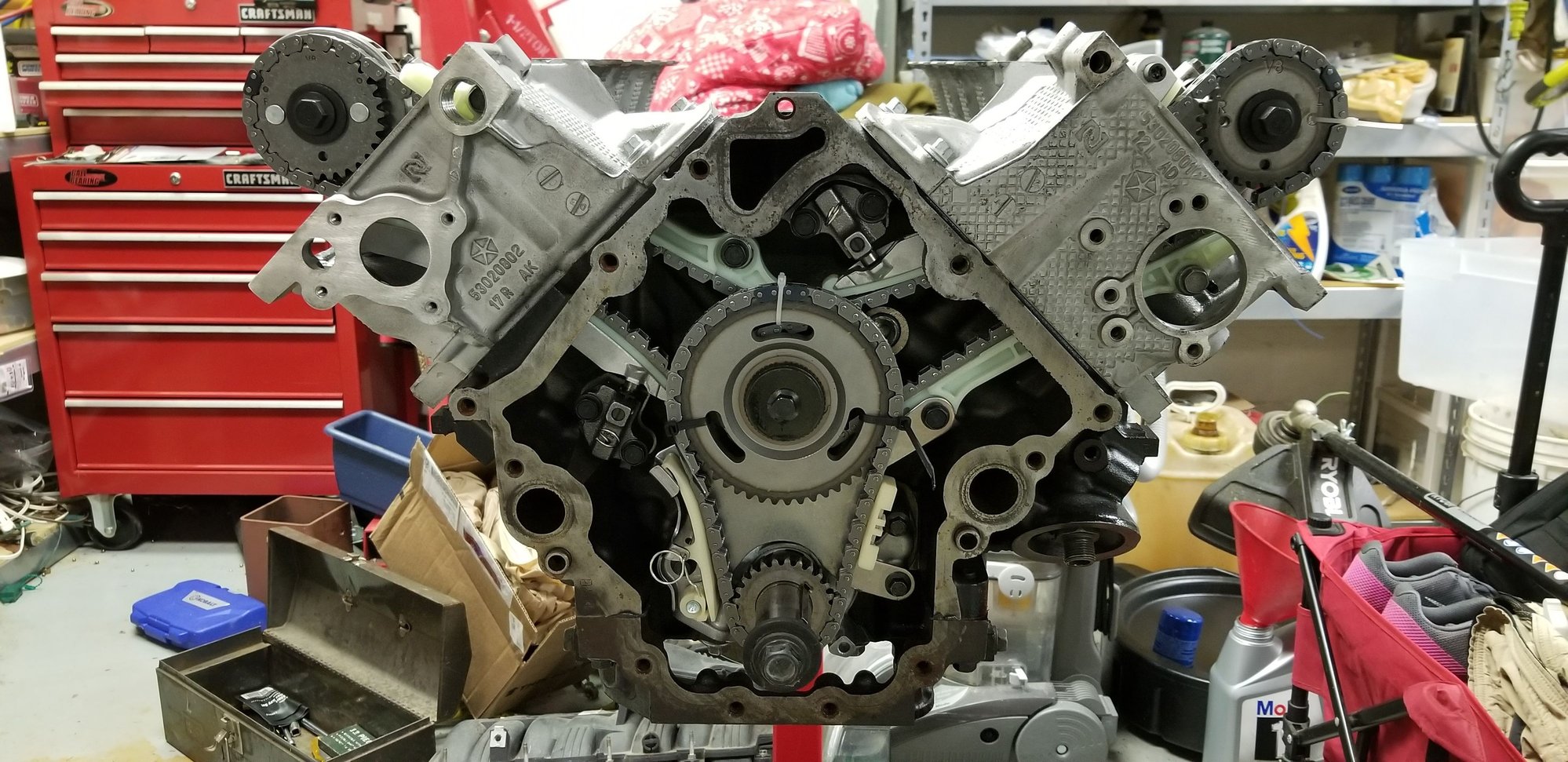

Next up was doing the oil pump and timing components. This trick from Airram.com with the zip ties worked really well. http://airram.com/faq.php?categoryid=37#Q1 I also had cost increase and delay because I realized I didn't have fasteners for all this and had to buy them online. But by mid-August I had a fully assembled long block that would turn over by hand without binding and line up the timing marks correctly.

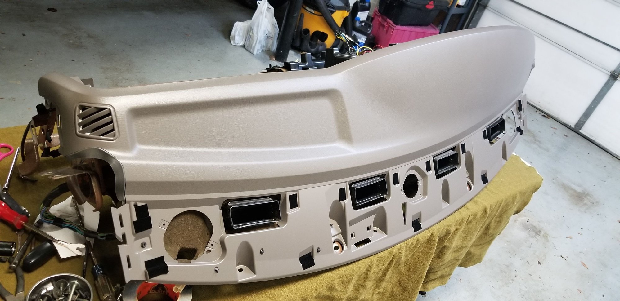

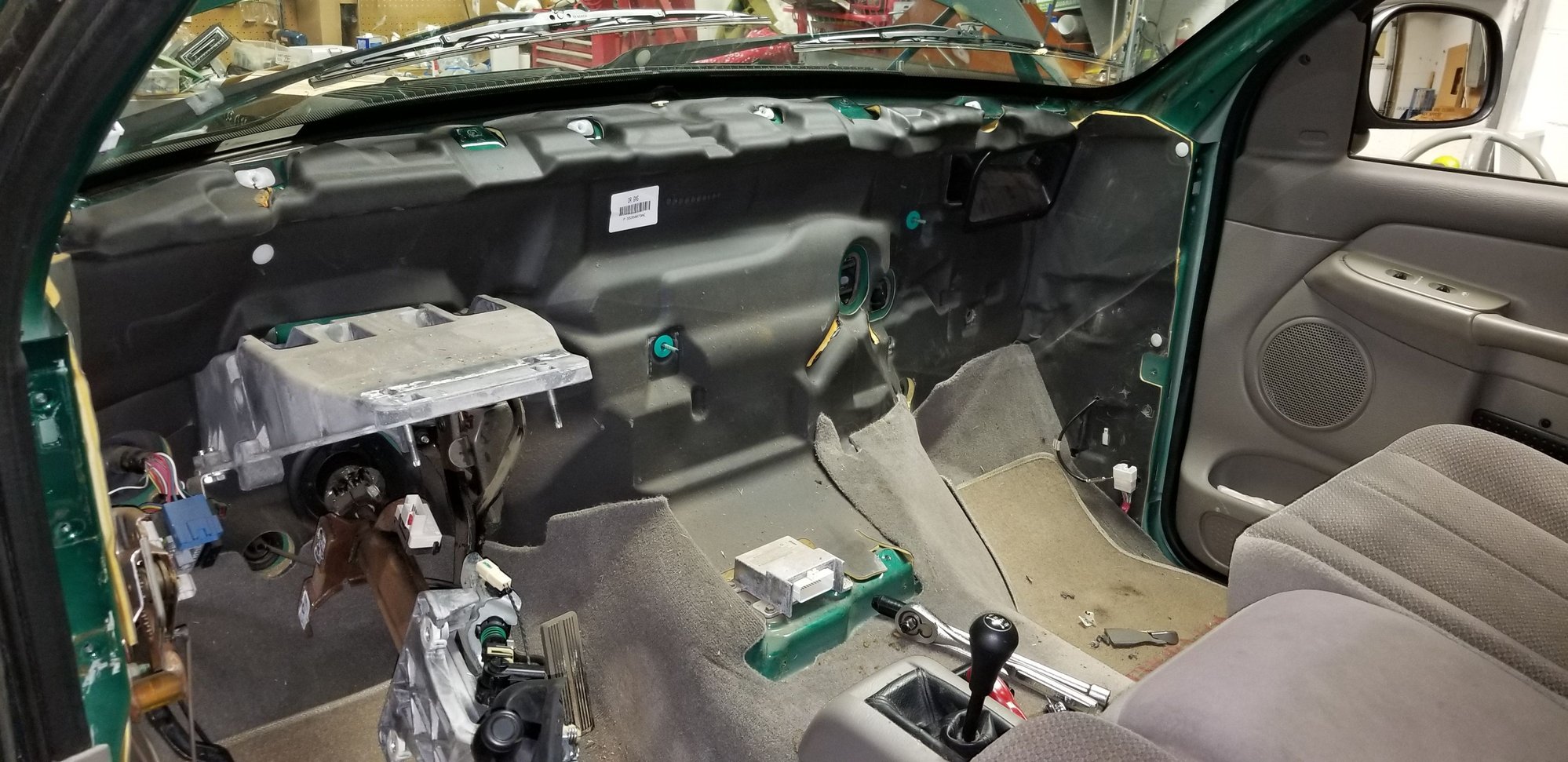

So by September I was at the point it was time to start thinking about pulling the truck into the garage for teardown and rebuild. I still had to spend big money on a big box from LMC Truck because I was going to replace the dash that was a crumbled mess from the last time I had it apart in 2012. The new dash arrived on October 3rd so I displaced my daily driver to the outside (yeah, I'm spoiled parking indoors) on the 4th. It would be awhile before I parked inside again. I was already taking the dash apart when I took that before pic but the upper tray with the defroster grilles isn't removed. It hasn't existed since 2012. That piece crumbled apart back then.

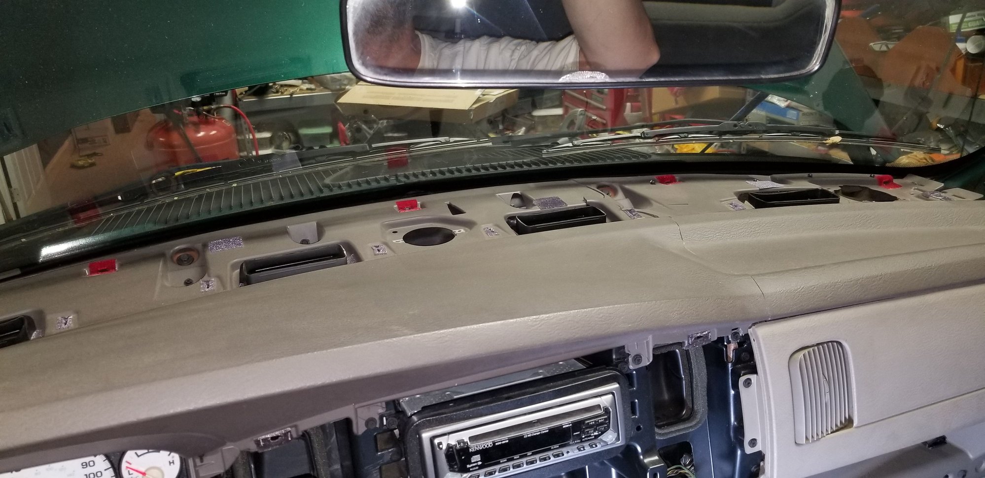

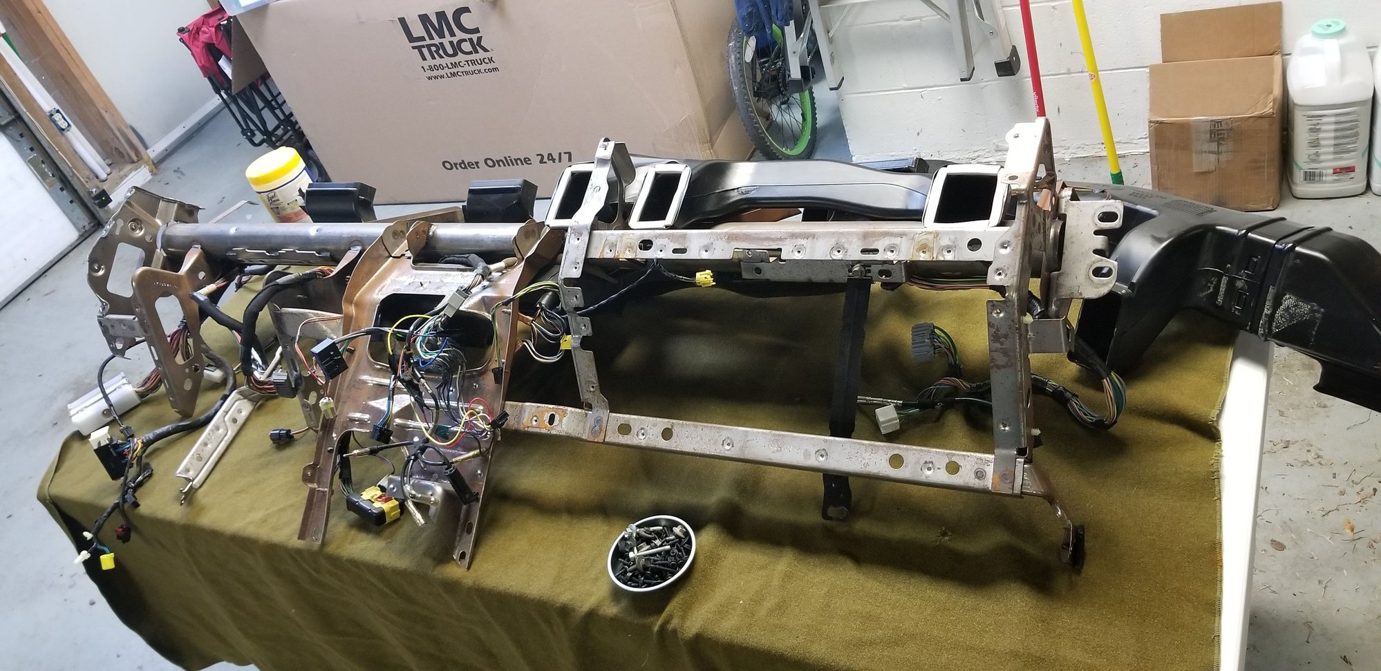

Then it was all the work to get the dash out so I could get at the HVAC box to replace the core. You'll note the sad looking weatherstrip. That will become important in the next post.

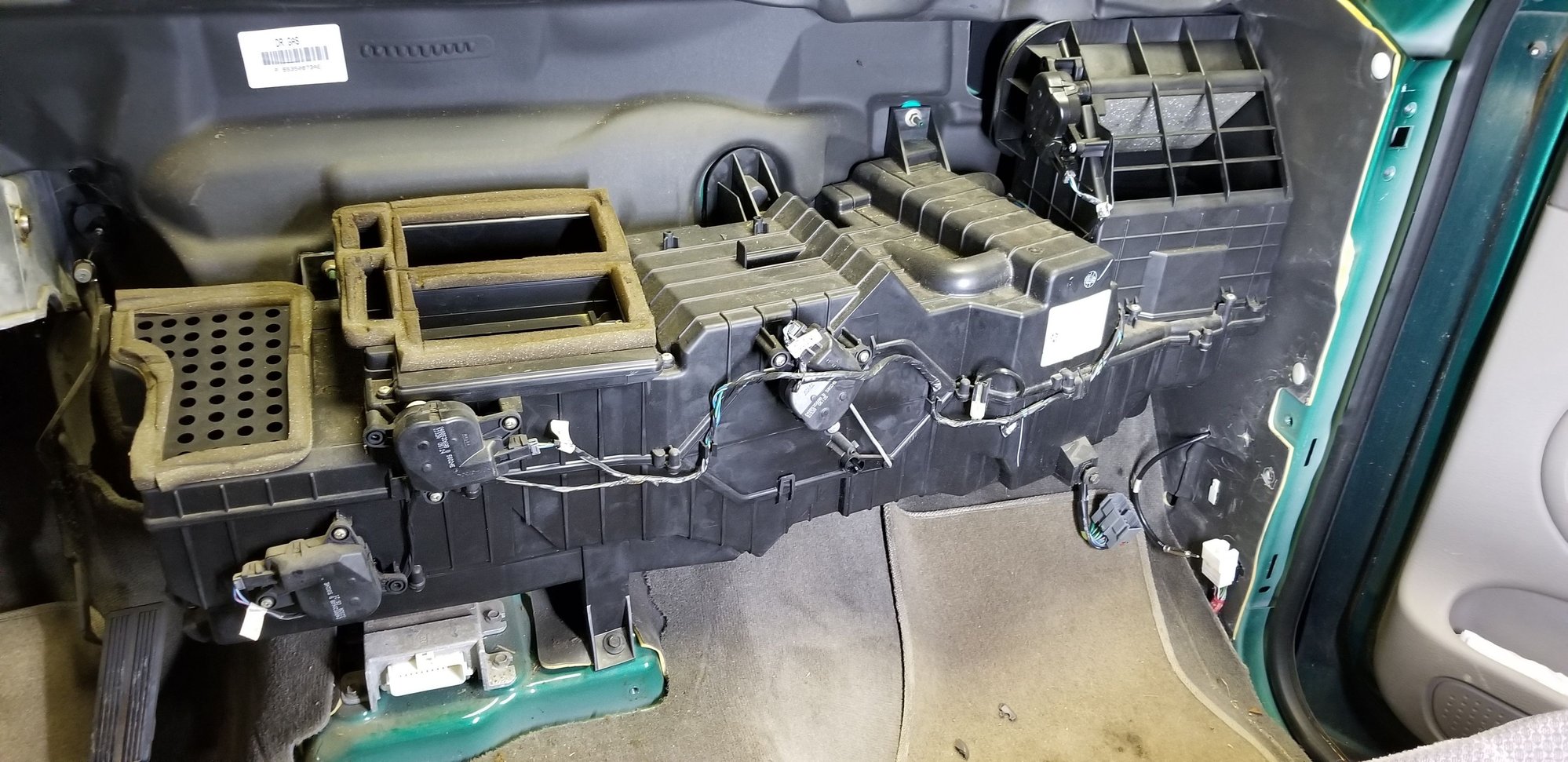

I mentioned the sad looking weatherstrip. Well, this was also the case with the blend doors. After 15 years and a couple of heater core failures the foam on them was a mess. I bought replacement doors from Dorman except for the lower door under the core which Dorman made wrong so I had to find an OEM. There was much delay sourcing the little clips that the doors rotate on. Mine broke coming out and they are discontinued. I had to call dealers all over the Southeast to get replacements. The Dorman doors did have nice metal replacement ones though but the OEM required replacement.

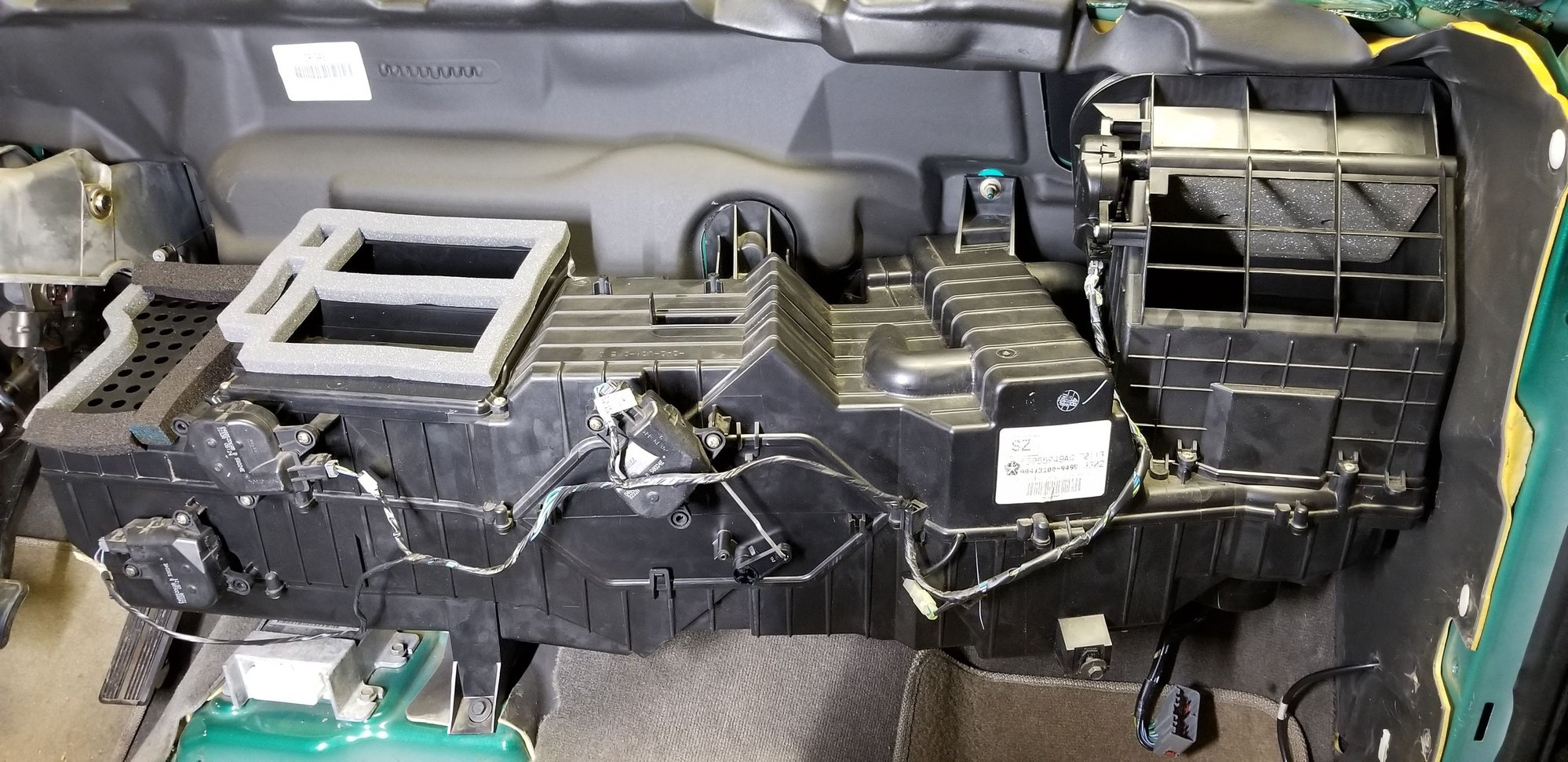

Once I finally had the HVAC box rebuilt I started in on the dash. There was delay there because the weatherstip on top of the box is also discontinued so I sourced what I could find calling around and used household stuff I bought at Lowe's where I couldn't find any. I also had issues with cluster lighting. I had the idea to upgrade to some LEDs I found on Amazon. Only once installed none worked. The original lights also didn't work when reinstalled so I wound up having to order all new OEM lights from my local dealer. But finally come November 13th I had the HVAC plenum and interior restored.

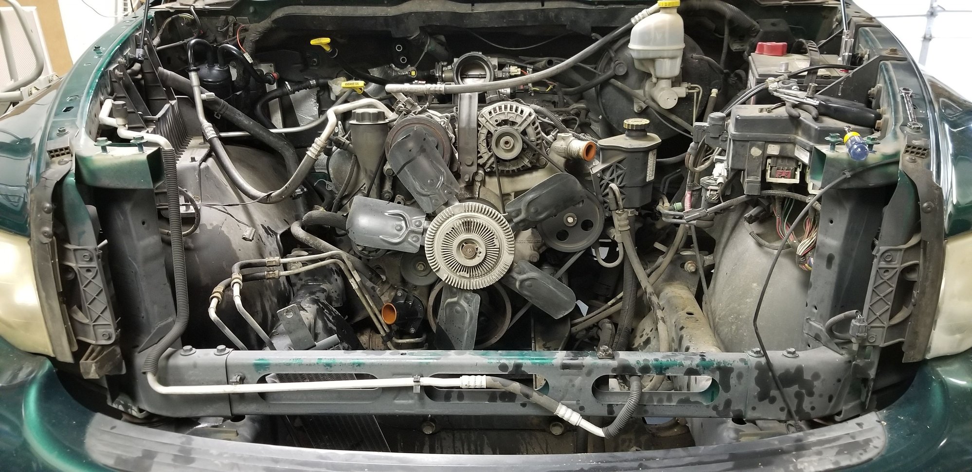

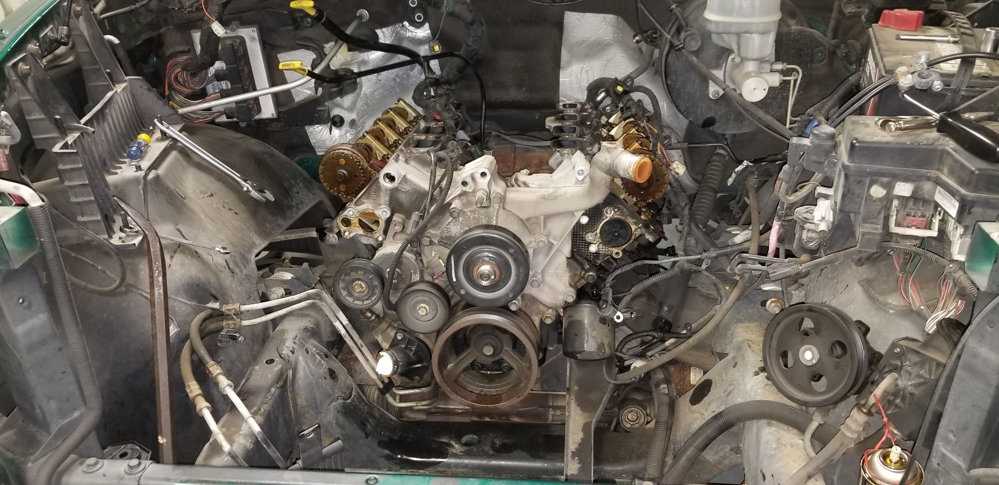

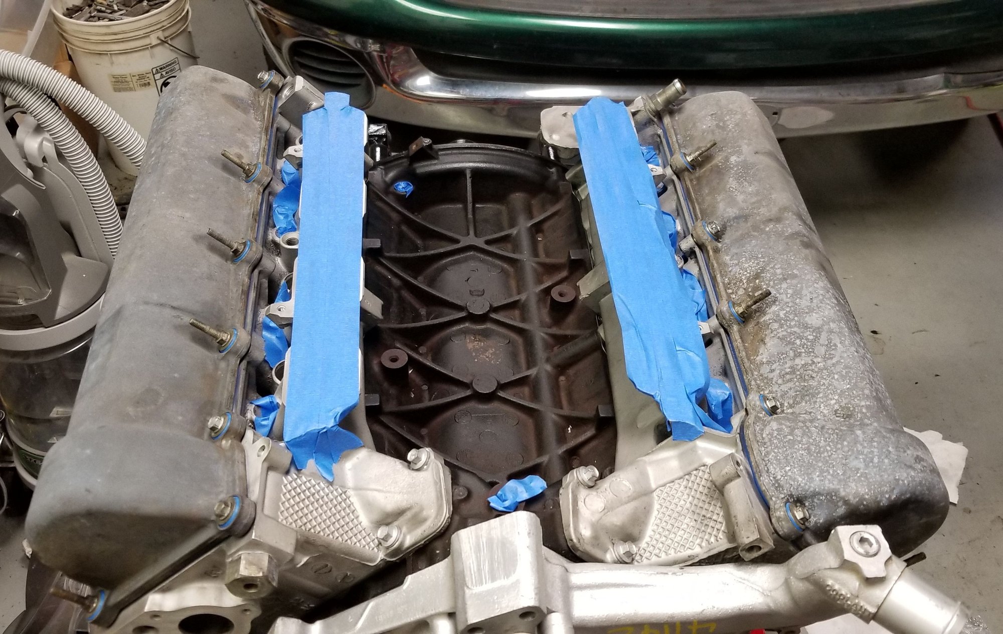

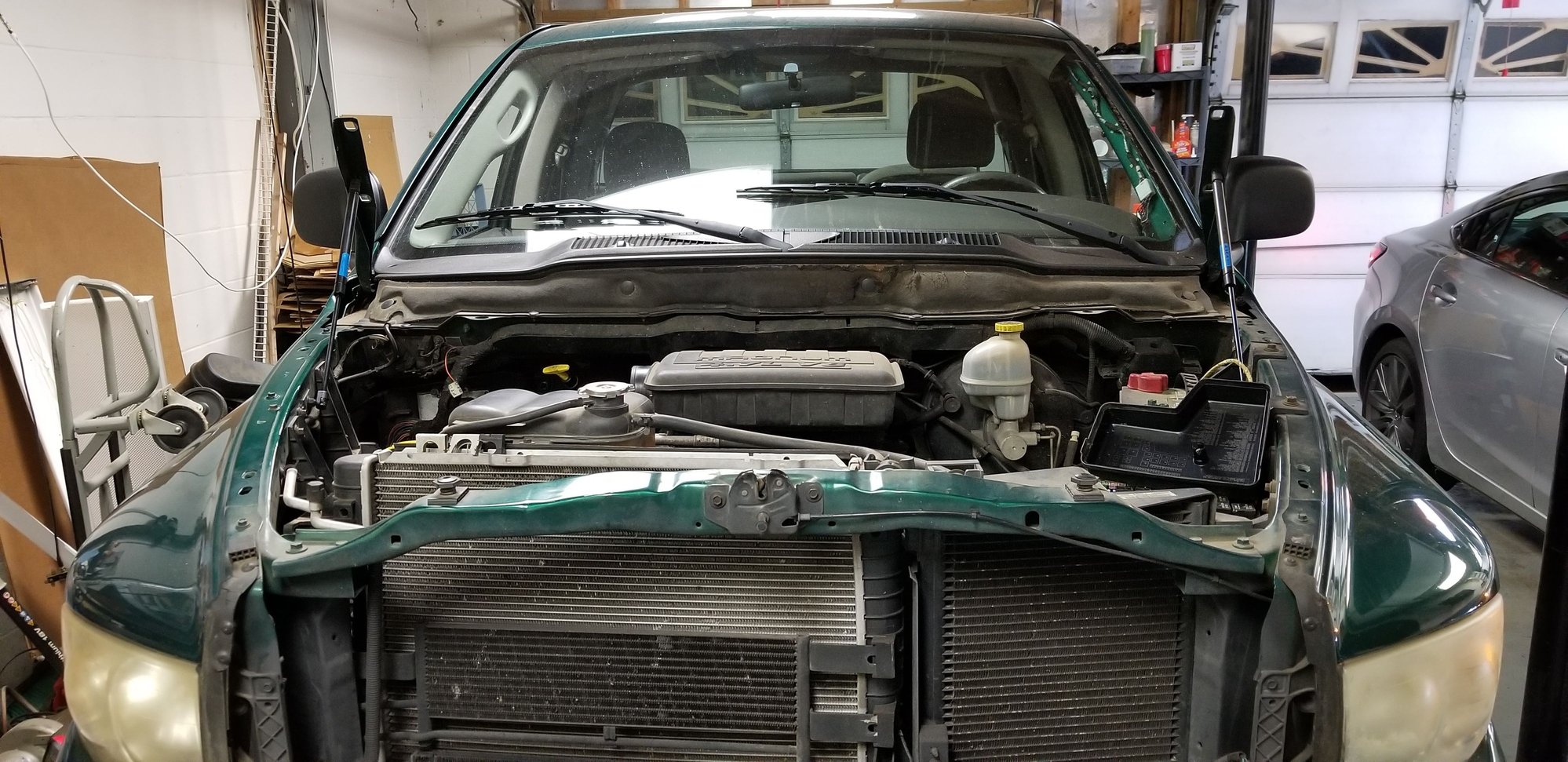

Now it was engine time. So out came the radiator and evaporator, hood and core support then fan and clutch. I was amused that I was able to stand inside the frame and work. I went ahead a stripped the intake and head covers. I swapped the covers onto the new engine before install.

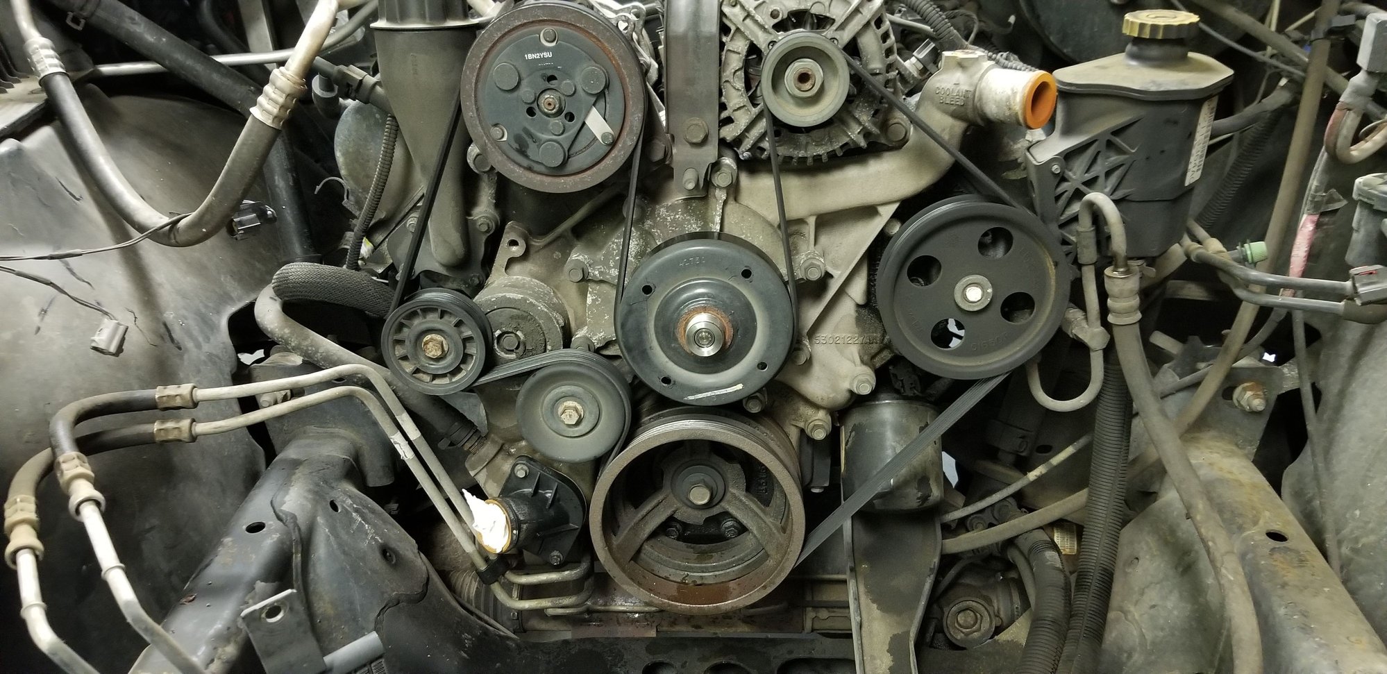

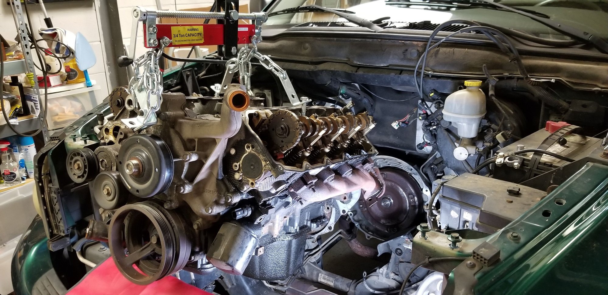

Since I have a 4X4 the driver's side mount ties into the front axle and transmission. Getting at the three bolts to the axle was a chore and they were VERY tight with limited room to work. The best solution wound up being a long handle, flex head ratchet. On Thanksgiving evening the old engine with 190,519 miles on it left its home.
