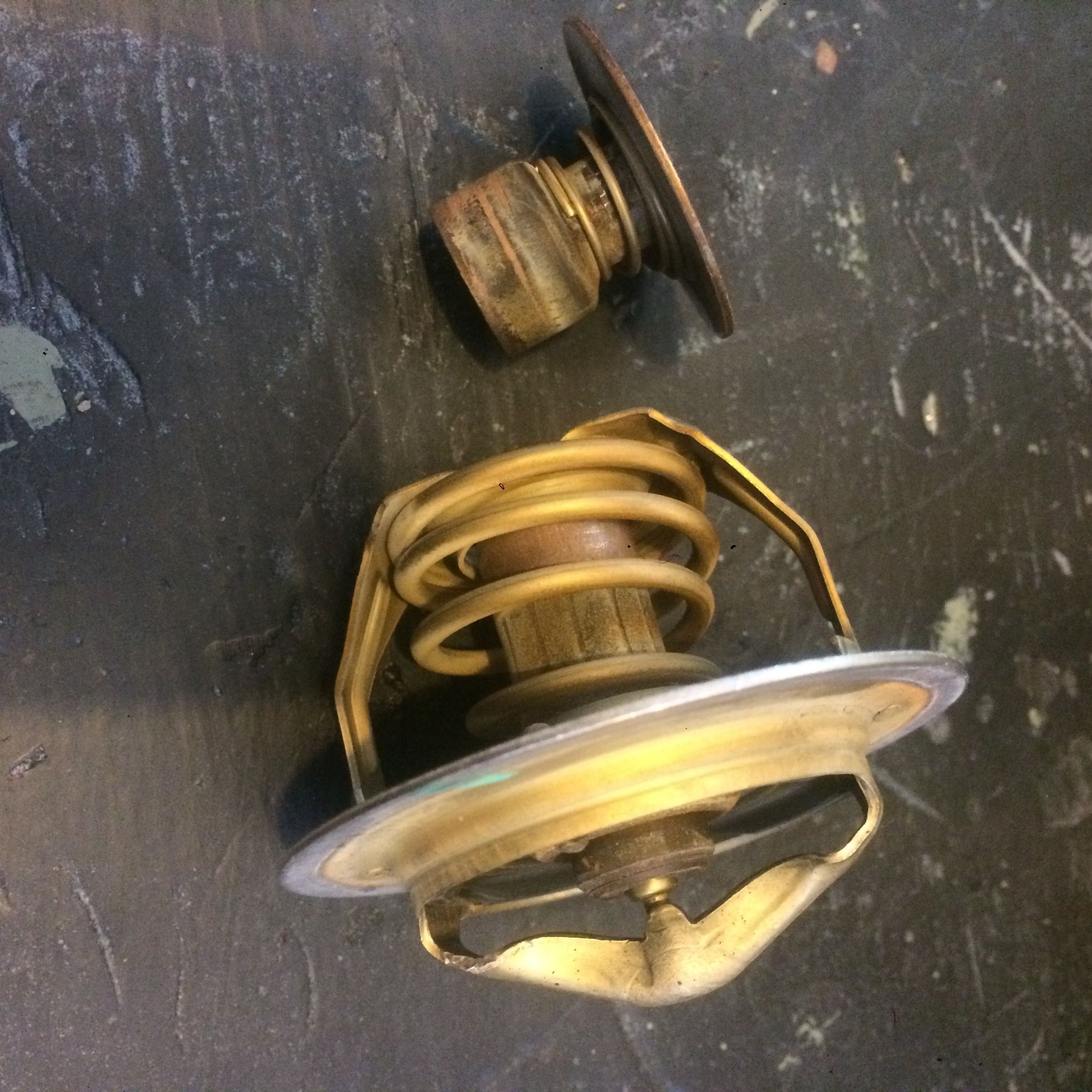

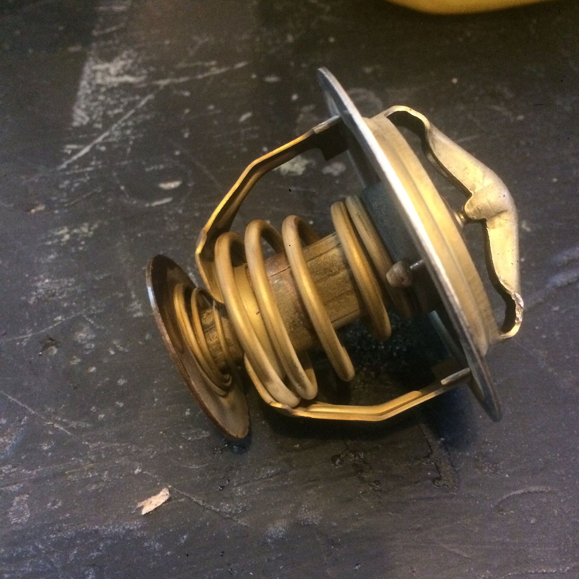

I suggest to go after the thermostat. If it is of any help, this is what I found when temperature on my truck was acting wonky. The main body of the thermostat was working fine. Problem was the engine valve end of it, the bottom piece of the thermostat, had fallen off. The crimp or solder had failed. I put a new thermostat in, though I probably could have just re-soldered the bottom back on this one and it would have been fine thereon.
