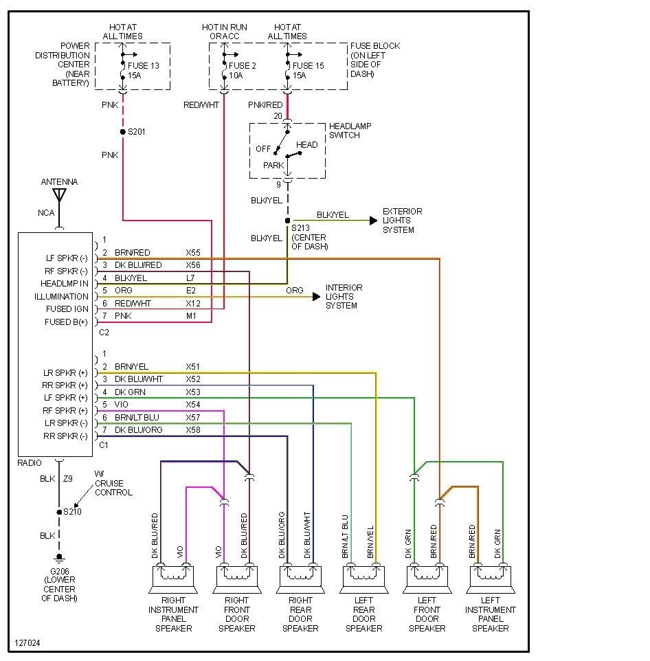

here is the diagram of the stock head unit.

Yeah, that diagram doesn't even show the amp.
