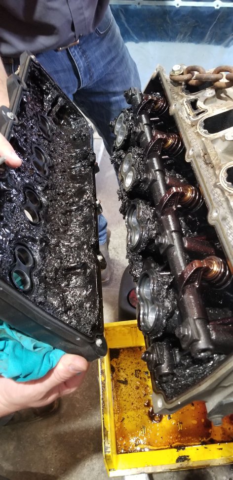

Old Jun 26, 2019 | 10:59 AM
  #36
gr8scott72's Avatar
gr8scott72
Posts: 478
Old Jun 26, 2019 | 11:02 AM
  #37
gr8scott72's Avatar
gr8scott72
Posts: 478
Old Jun 26, 2019 | 01:48 PM
  #38
Posts: 87,483
Holy smokes, that one was seriously neglected.......

What the??? Safe to say that one wasn't being run on full syn... or anything much at all. Time for a new motor.
