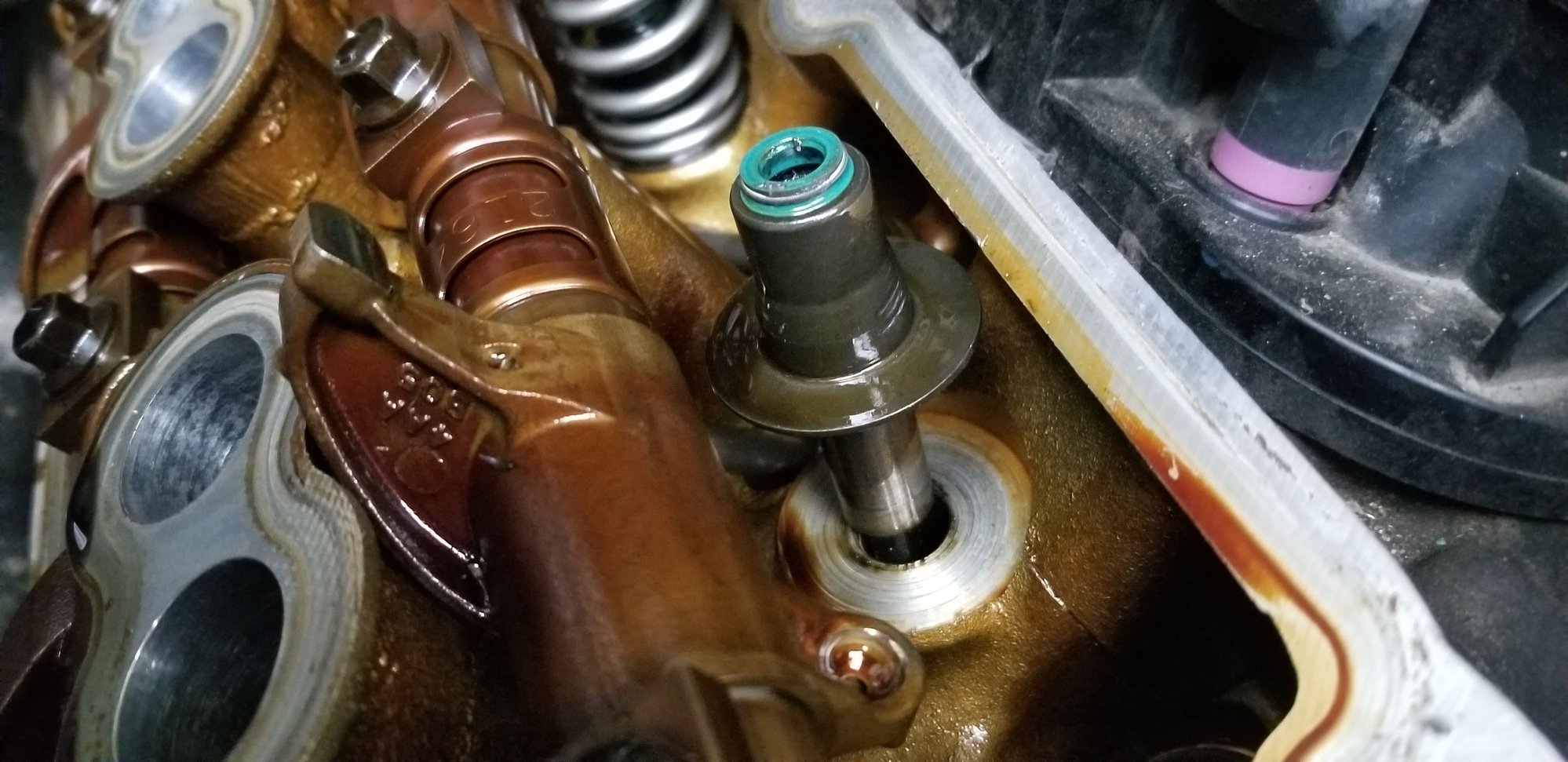

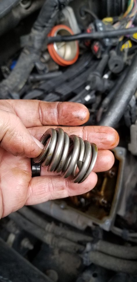

Had the ever so lovely broken valve spring on my 5.7. I got lucky and only slapped once and bent the valve in the head. Do you guys think I am better off to rebuild the stock heads or buy a complete set. If I should go with the new heads do you have any recommendations on supplier or what kind to get? I can get just an OEM replacement out of Oreilly but I have no info on if they are any good. Any advice or help is welcome.

You have no idea how lucky.... pushed valve into valve cover and bent it just enough that it couldn't fall back in. Push rod slipped out of rocker, so no damage there. Just bent valve and pushed the valve guide out. They were new comp cams springs even. No idea what happened here. Will pull the head today or tomorrow and see if I got any piston or cylinder damage.
