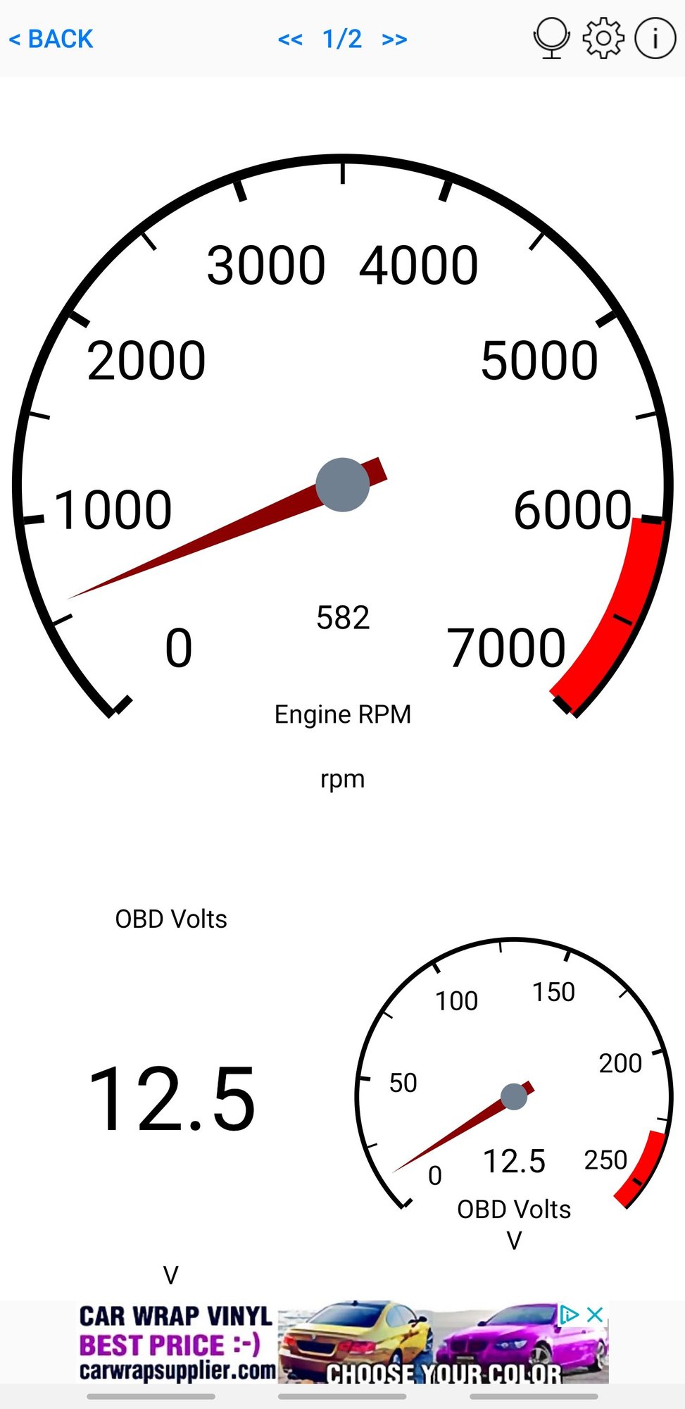

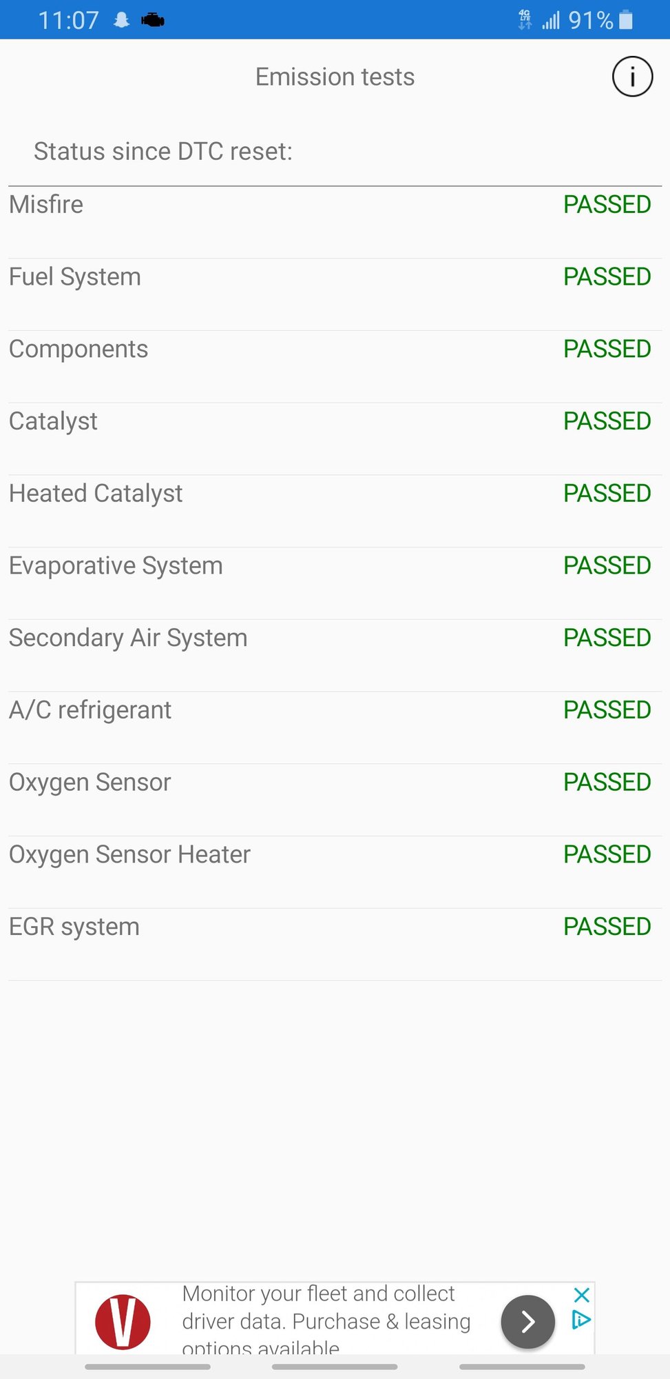

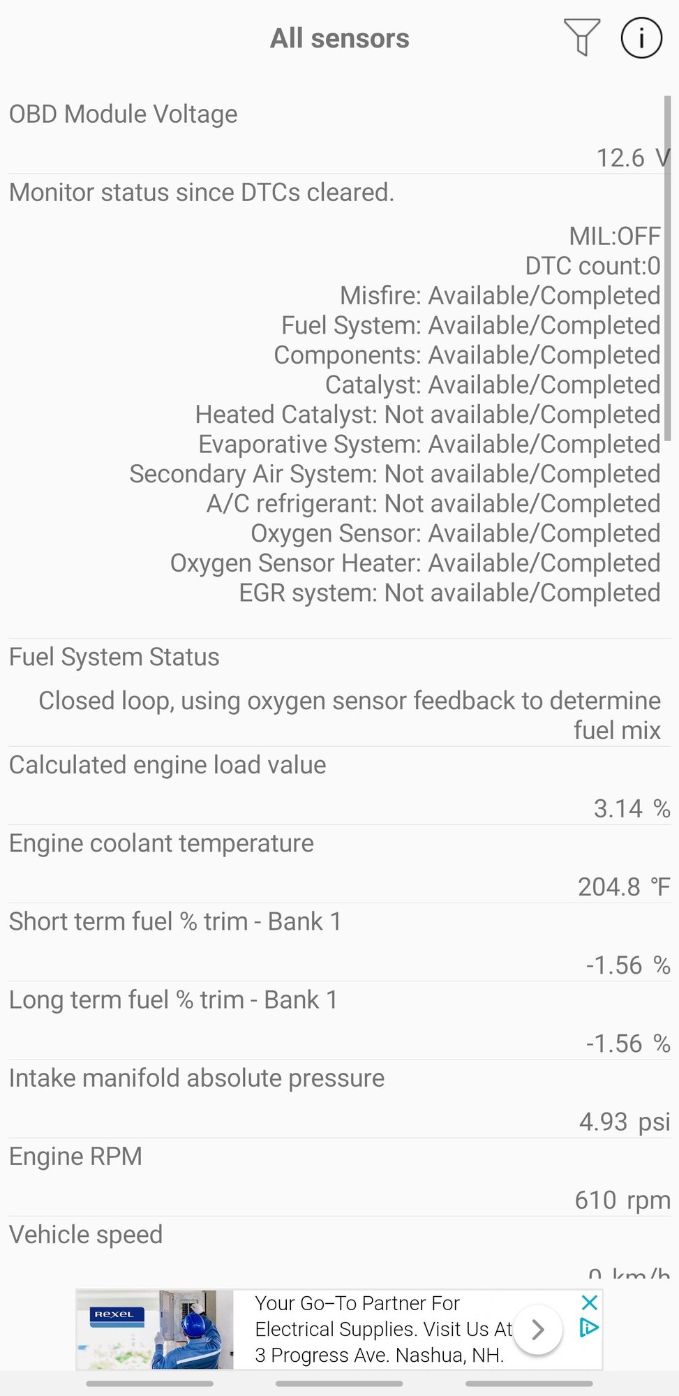

Hey everyone, I'm not sure why but my truck has been declining in its gas mileage. It's an 02 Ram 1500 with the 4.7 V8. It also has the short bed with RWD. I do drive lots of city and not so much highway, but I should be getting around 14 City. I do have a superchips tune on it (87 Octane), but for a few weeks I did have the Tow Tune on (to see the power difference). In April my coolant reservoir started to leak, so that was replaced very quickly. The truck drives and runs great. Shifts very smooth and drives like a dream. I attached pictures of the gas mileage and all the sensors and things of that nature.
Sensors all passed...
RPMs and Voltage Look Good...
Fuel Trim hasn't gone past +/-10%

Everything looks good there. Things are working as they should, according to the computer. Do you get gas at the same place each time?

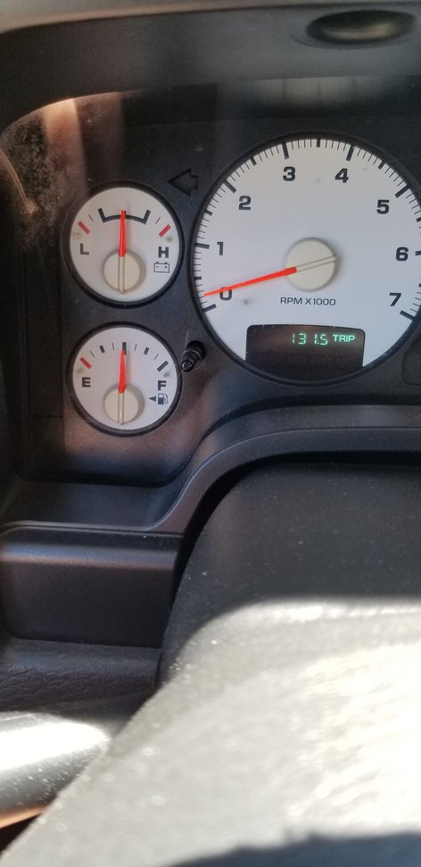

Here's a pic of how many miles i've driven since a full tank (my last fill up). If my math serves me correctly I've been averaging around 10 MPG with a 26 Gallon Tank, which scares me... and yes, my Tachometer is not accurate below 2000 RPMs, so that doesn't concern me.

It's the weather. Well, the EPA response to the weather. You can blame Congress and the EPA for mandating Ethanol use in gasoline. When they adjust the fuel blend, I've seen major changes in economy. I'll bet your actual Ethanol blend was around E5 and is now around E10, possibly as high as E15. I know Countrymark premium fuel is pure gasoline. I believe you can get Ethanol free gasoline at some Sonoco stations too.
