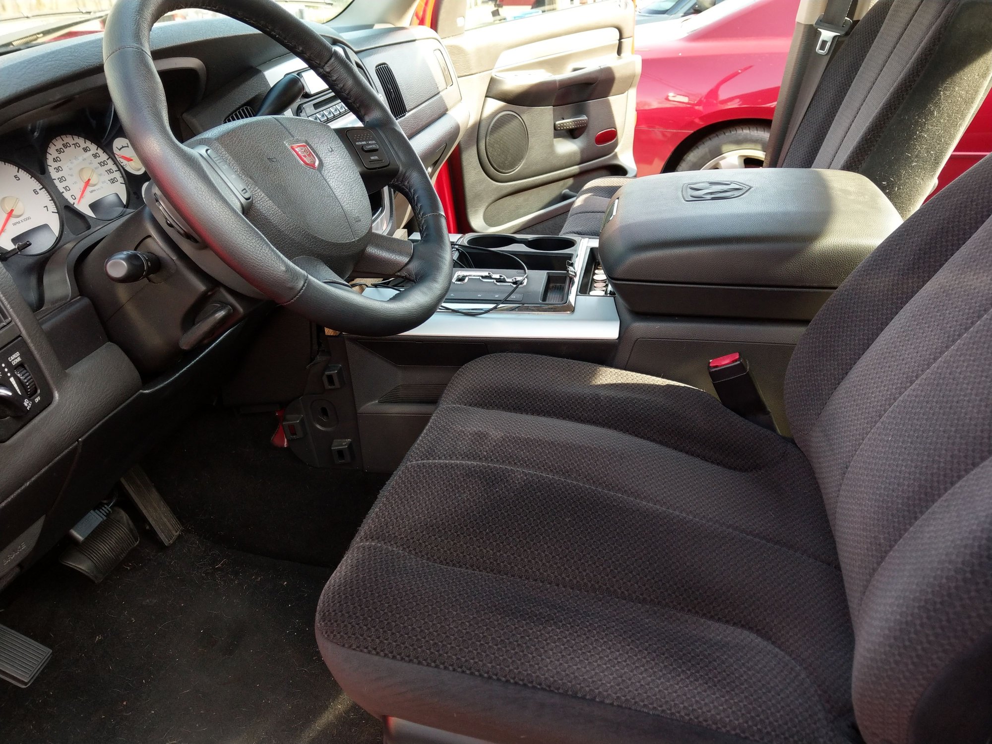

4. Wish I had known you were looking, I just swapped a 4th gen interior in and have an excellent condition set of cloth seats from a quad cab
2. The cruise blanks had slots to hold the wire connectors, and the wires were present. I just swapped the blanks with the switches and used the harness that was there.
4. My truck is a standard cab, but the 4 door seat covers are close enough. The donor had a really good passenger seat, but a really bad driver seat - 245k miles. I haven't pulled the trigger yet on a driver seat bottom, need a cover and foam. Curious, what is your trim code? I'm thinking there are no good used driver foams out there, but there is a couple versions of the foam available on ebay. There are some covers on ebay too, but I'm not sure they are the right color and may look like crap against the originals.

I'd have to go look, but here is a pic before they came out.

That looks right, sent you a PM.
