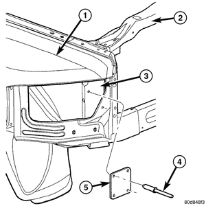

Its behind the passenger headlight..
The Body Code Plate is located on the right front hydroform fender rail just behind the headlight assembly. There are seven lines of information on the body code plate. Lines 5, 6, and 7 are not used to define service information. Information reads from left to right, starting with line 4 in the center of the plate to line 1 at the bottom of the plate.

Old Jul 23, 2019 | 09:00 PM
72rtchallenger's Avatar
72rtchallenger
Joined: Jan 2006
Posts: 205
Likes: 12
Unsure but found this on internet,,maybe it can help
98 2500 frame it was just forward of the rear cab mount on the passenger side, stamped into the top of the frame rail
Other VIN locations, sometimes referred to as anti-theft labels, can be found in numerous places. For instance, VINs are stamped or affixed to the front fender and bumper, the hood, the left and right door, rear quarter panels, the trunk and the rear bumper. Sometimes VINs are imprinted on rear passenger doors as well. The codes are also stamped on the engine, transmission and drive train to discourage reassembly of wrecked or stolen vehicles. And some, but not all, vehicles will also have the serial number positioned in confidential locations, such as under the carpets; on the interior of the vehicle's "A" post, the support that runs from the top of the front door along the windshield, or "B" post, the support that runs midway through the vehicle; and on firewalls.
This seems to be the common info.
Was told by rep. at Chrysler that the 3rd VIN# should be in one of the front wheel wells. Unsure which one, or if the inner fender well has to be removed??? Forgot to post: Chrysler Hot Line, 1(800) 992-1997, press #4 for Dodge vehicles.
By the way the VIN stamped on the passenger side shock tower is not a deep stamping and is hard to see, so maybe make a close inspection just to make sure.
I've also read that on the 6.1 Hemi motor the VIN is stamped on the block on the left side under the head. Not going to be easy to see back there.
Just removed my engine cover, used a long mechanics mirror and bright ledflashlight. The last eight digits of my VIN# is stamped on the engine block exactly like his photo above. Mine's a 2010 5.7. That should get you registered.
Almost forgot. I wrote the last 8 digits of my VIN# backwards on a piece of paper to compare what I was seeing on the engine block was correct. When I first found the number, I forgot that I was suppose to see it backwards because of the mirror.
Don't know if this is the secret number or not but I found my entire VIN stamped into the drives side frame rail when we did my exhaust...
