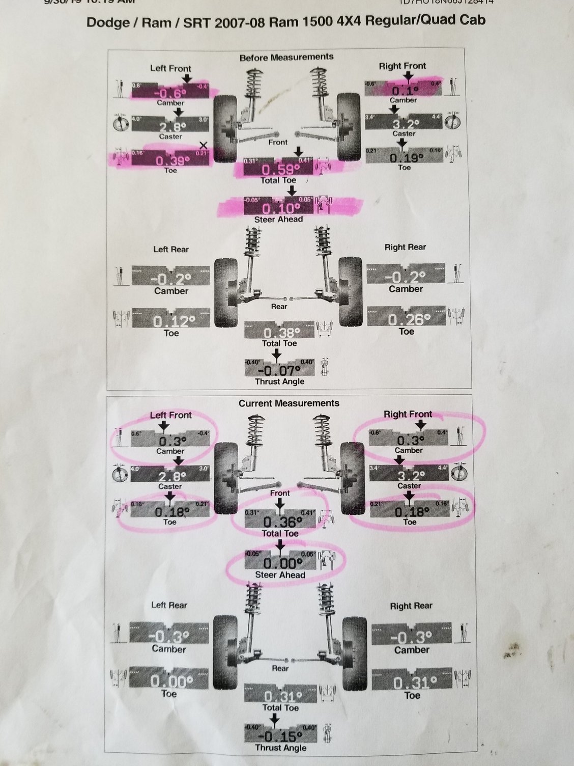

The problem didn't start immediately after installing the kit. I had the kit installed in July of 2018 and I drove it with no problems until October 2018. I then deployed for 6 months and the truck was not driven at all while I was gone. I returned in April 2019 and it drove fine until about June of 2019. At first the steering would drag slightly after making a turn but always returned to center. It slowly got worse and now I have to manually return the wheels to center after making a turn. When I did the lift I took my truck from stock tires, P275/60R20, to 33X12.50R18's. The old tires were standard good year street tires and the new tires are Fury Country Hunter M/Ts. So it is a bigger tire with a smaller wheel. I did recently take it to the dealer to have it looked at and they told me it was a combination of a bad alignment and aggressive tires. They said they did the alignment (report below) and it mostly fixed the problem but it would still drag slightly because of the tires. I drove it home and the problem was exactly the same as before, no change at all. I can also upload the alignment report from when I had the leveling kit installed if it would help.

they made no caster adjustment...its not in spec on either side.
All i'm saying is the more positive the caster the more pronounced return to center is.

Isn't caster supposed to be around 3 degrees? His is currently just barely off of 0.... No wonder it won't self-center.

You're looking at Camber, not Caster...caster is 2.8 and 3.2
