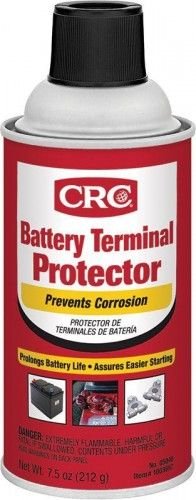

Might want to disassemble and clean your battery and alternator contacts, bad connection can cause that condition as well. Check for corroded wiring while you're at it. I use CRC battery terminal protector, once everything is back together I'll spray over the connectors to ensure they don't corrode again.
