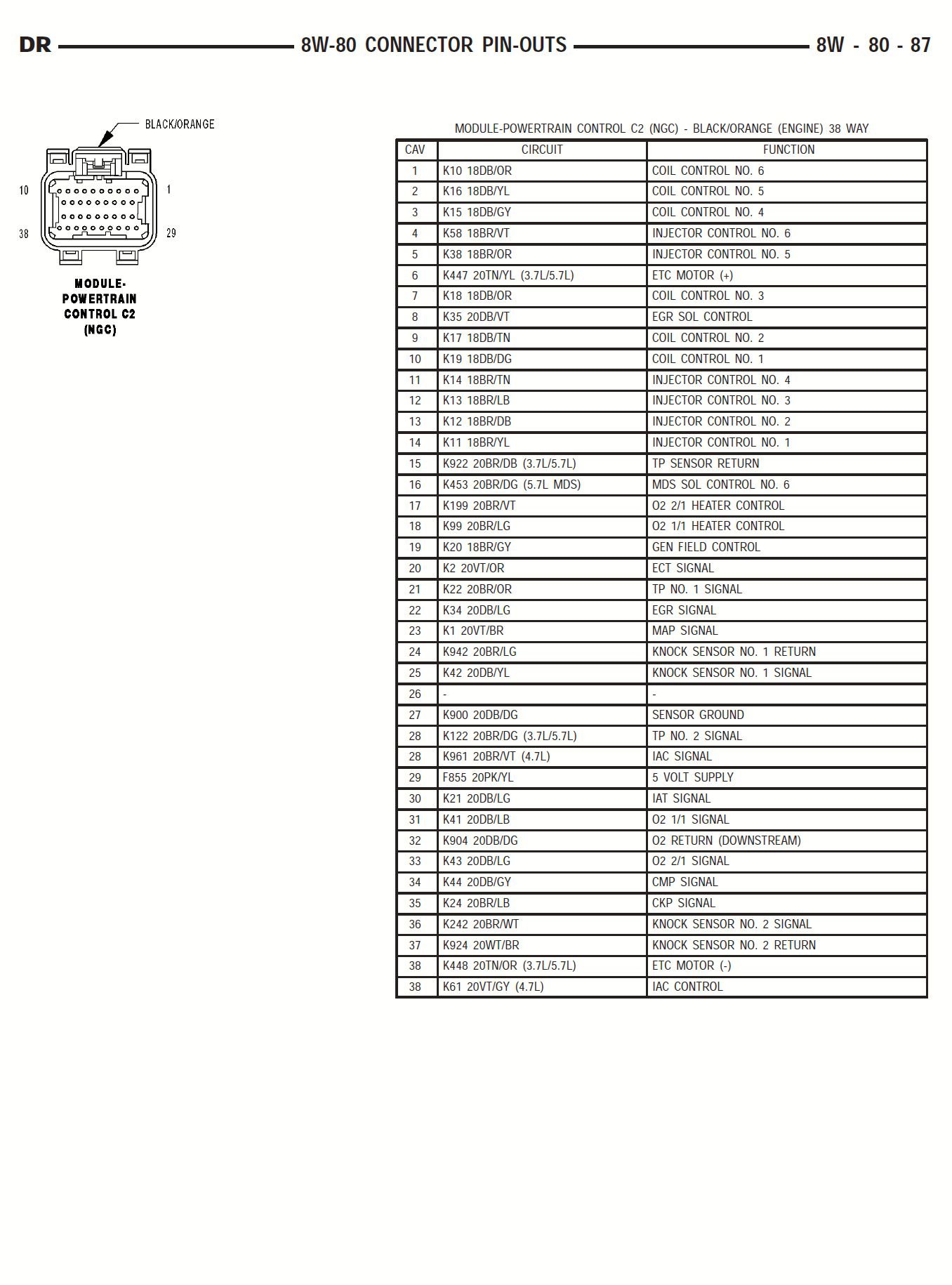

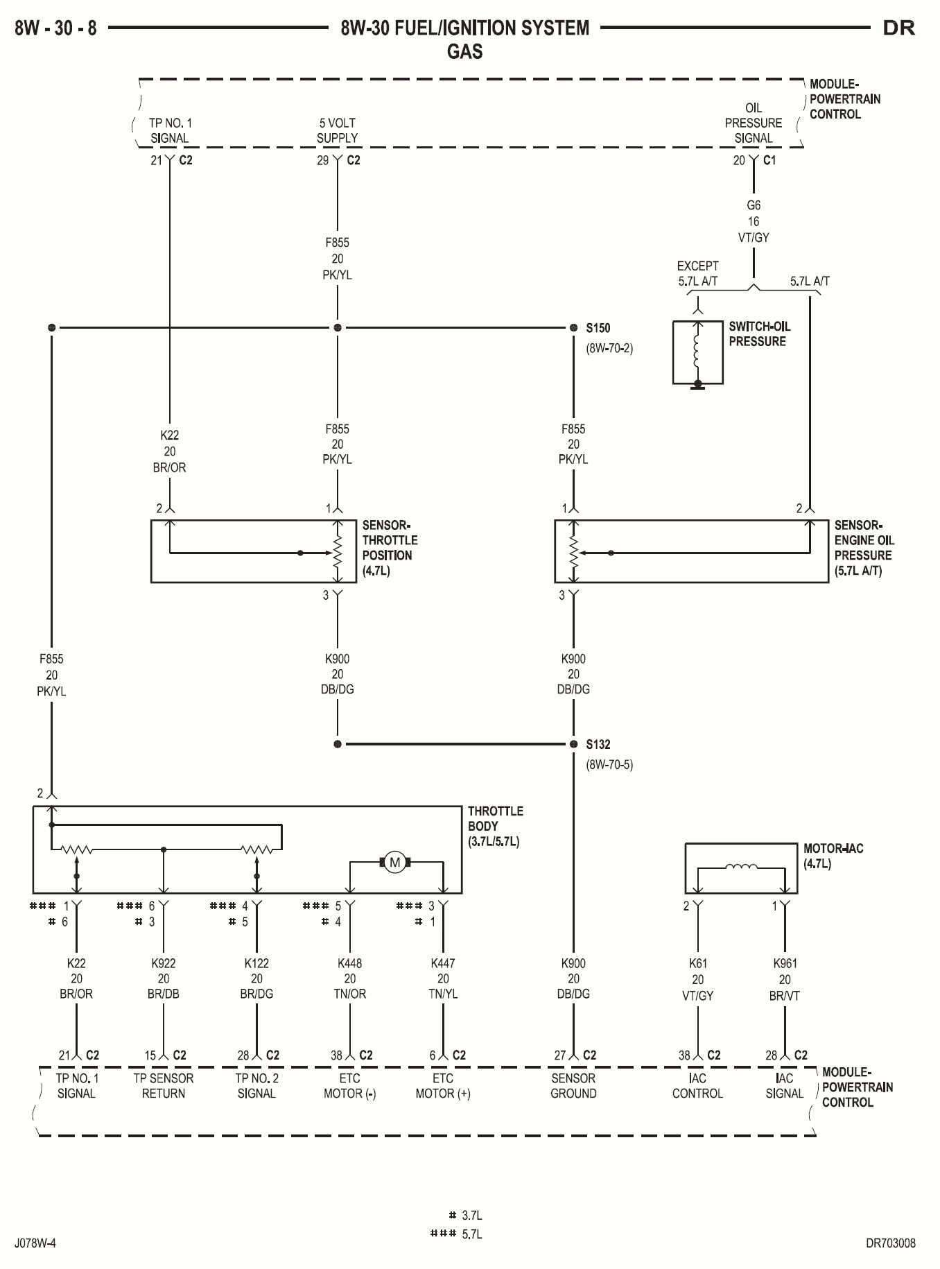

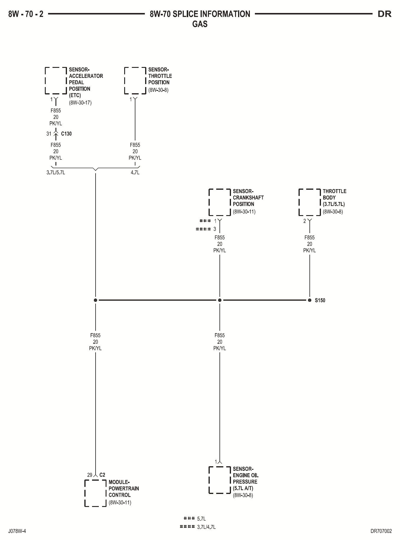

I've got you, fam.
Crankshaft sensor circuit pulls a 5v reference from pin 29 of the C2 PCM connector (see below)
Throttle position pulls a 5v reference from the PCM via C2 pin 29 (see below)
C1 and C2 connector locations
Verify you have your 5v reference signals at C1 and C2 connectors, also verify your C2 sensor ground at pin 27

The wiring diagrams were a great help Prismatic. Thank you for them.
