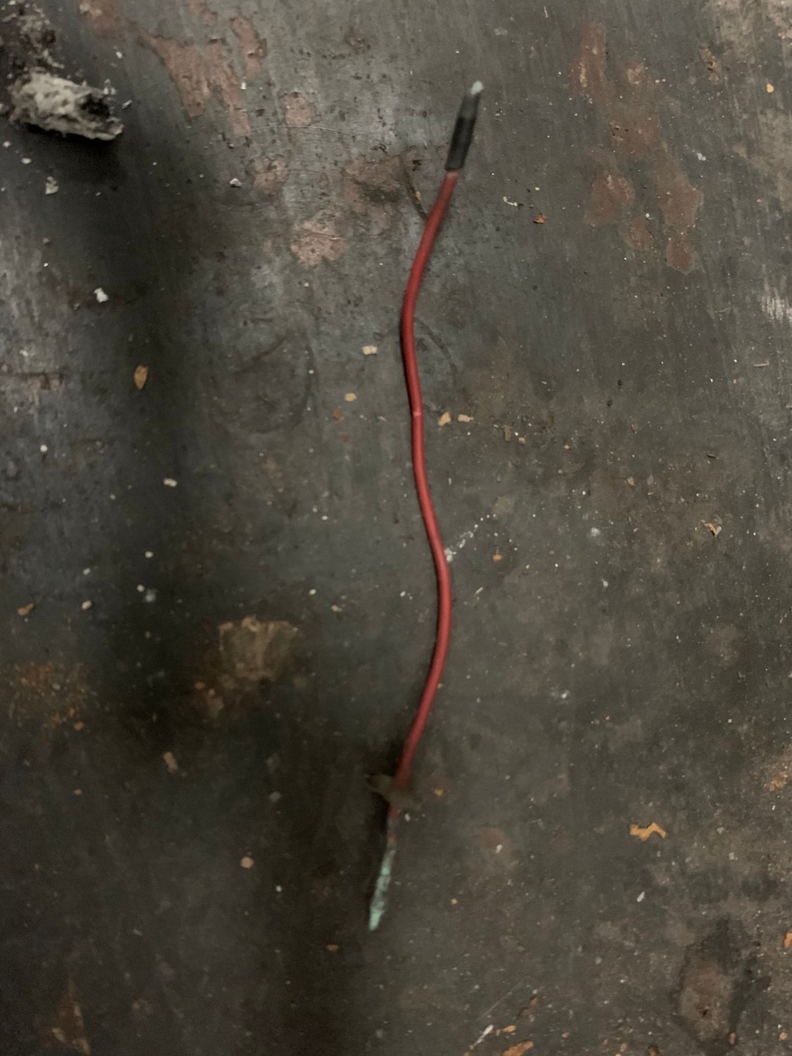

while i was waiting for an answer i did notice that the truck come with a jet performance chip and decide to try removing it to see if that would solve my problems.
Under the connector C1 where the chip is plug was full of corrosion and 3-4 bent pins!
decide to clean the whole thing and put some dielectric grease! Put back everything together.
try starting the truck....... no start, no cluster, no communication to ecm, crank but no start!
start reding some threats here and found to test connector C1 32 pins pins number 2 and 22 are the one feeding the whole thing!
pin 2 right voltage pin 22 ohhhhhhh nothing!
open connector to find out someone have played here before me and they put a connector inside the connector and it’s full of corrosion and their no voltage! I decide to go Take voltage after the repair on the original wire red/white i got the right voltage.
now i need to replace the C1 connector 32 pins to fix this problems!
do you think that could be my fixer for my problems of hesitation/shutters/missfire ????
