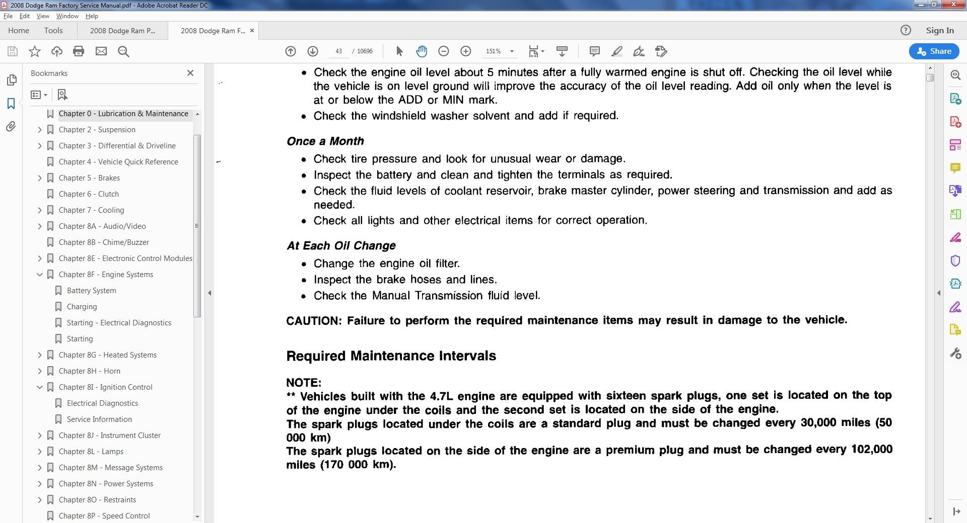

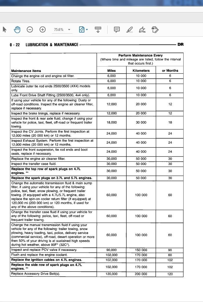

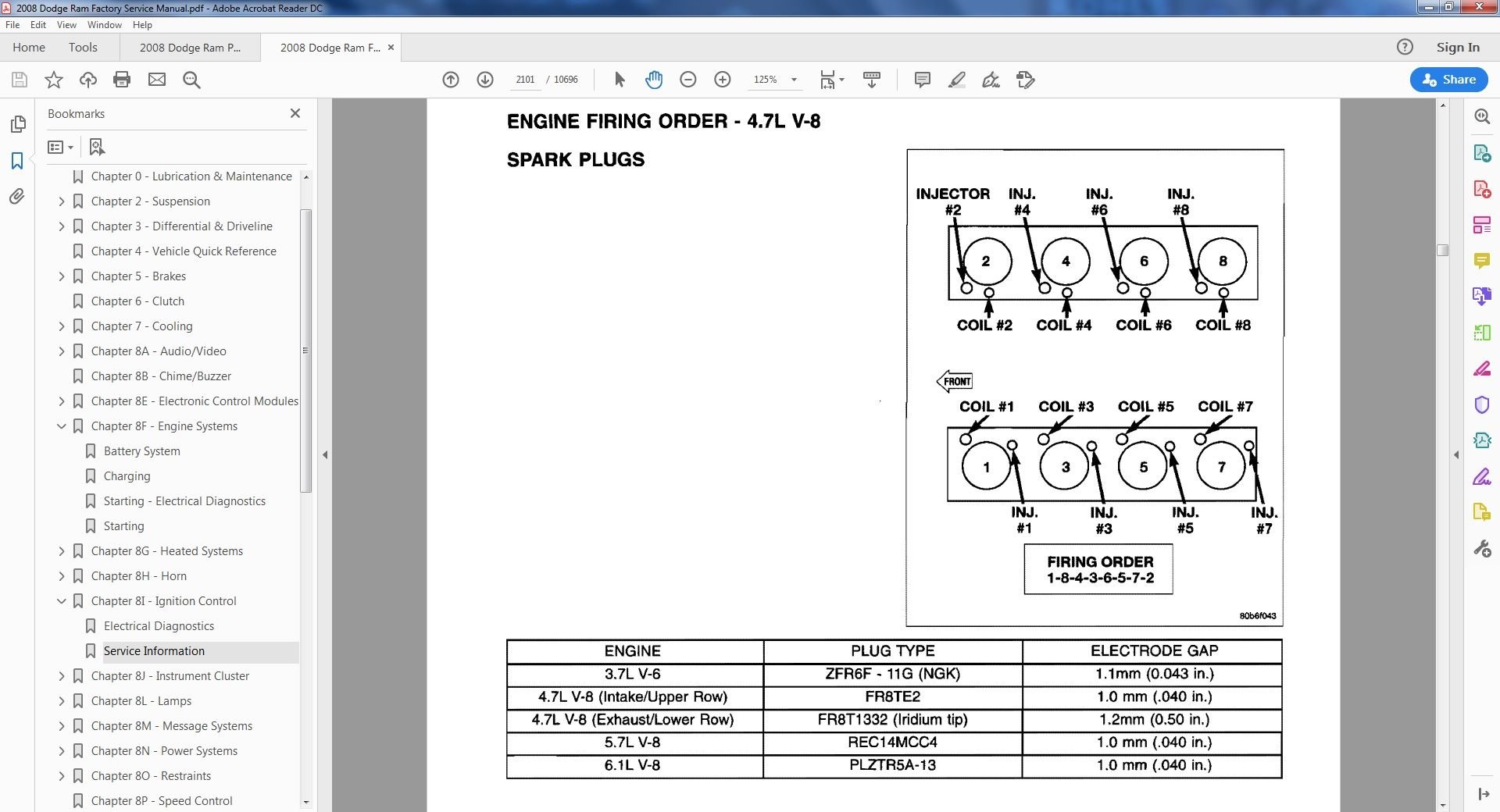

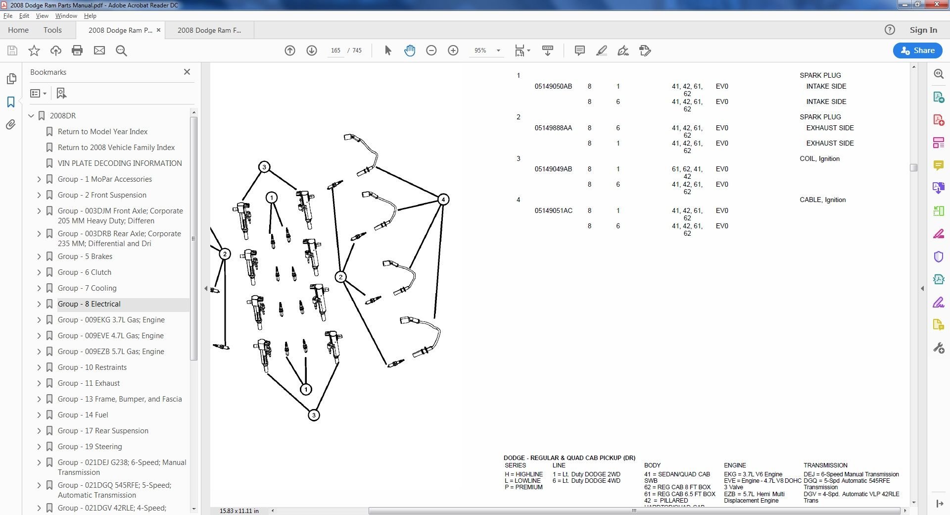

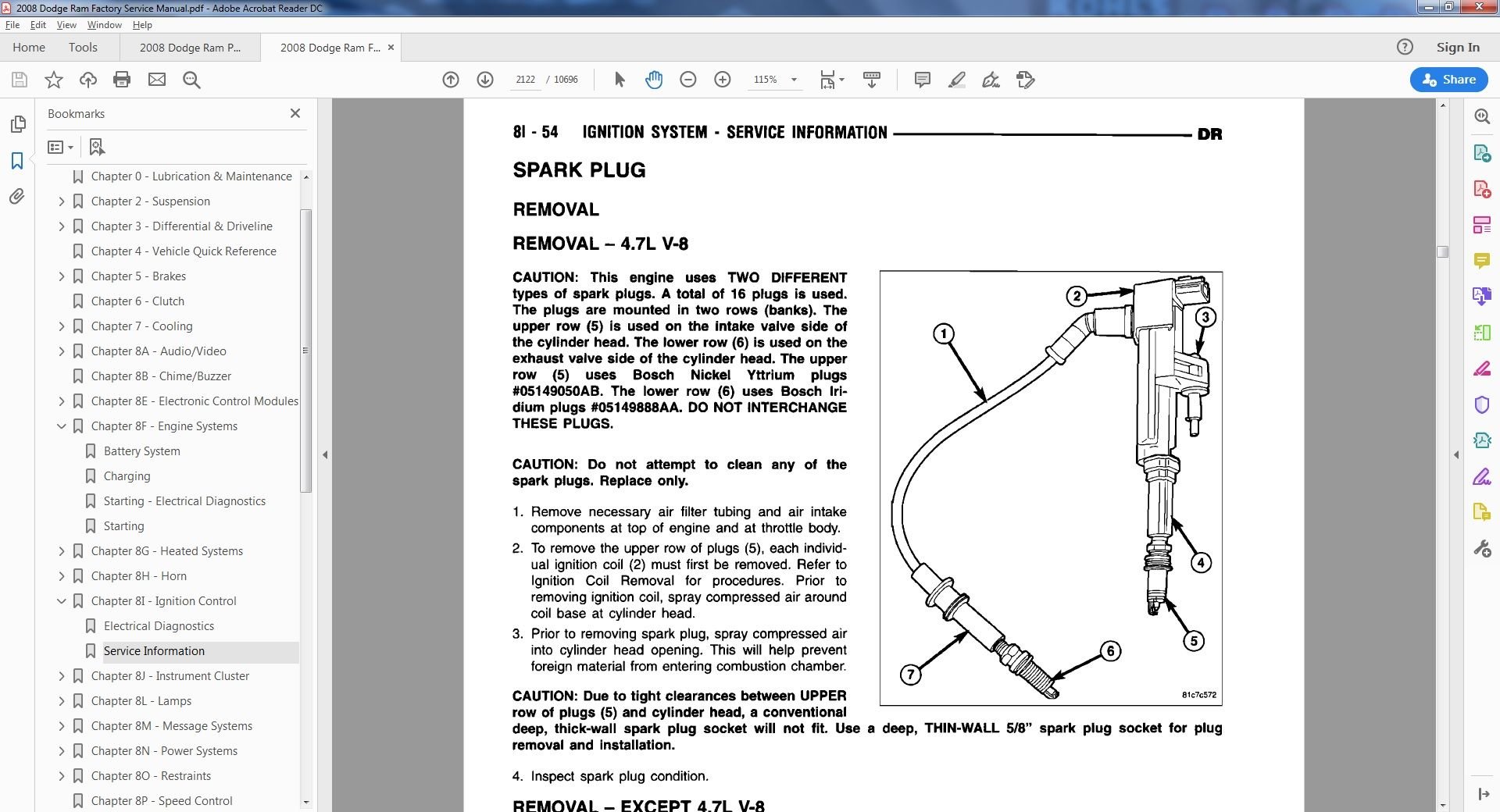

Intake plug - 5149050AB
Exhaust plug - 5149888AA
Originally Posted by Alex Medeiros
AKA copper plugs.
Yes and no lol. You're thinking 3G hemi. 08+ 4.7's take coppers up top (intake) and platinum down below (exhaust). The change schedule is altered to reflect this; the uppers are supposed to be changed more often than the lowers (check your owner's manual).
The following are pages from both the factory parts and service manuals
