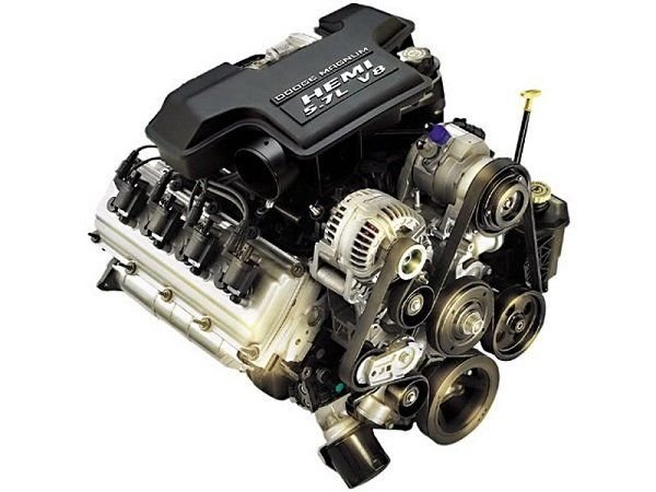

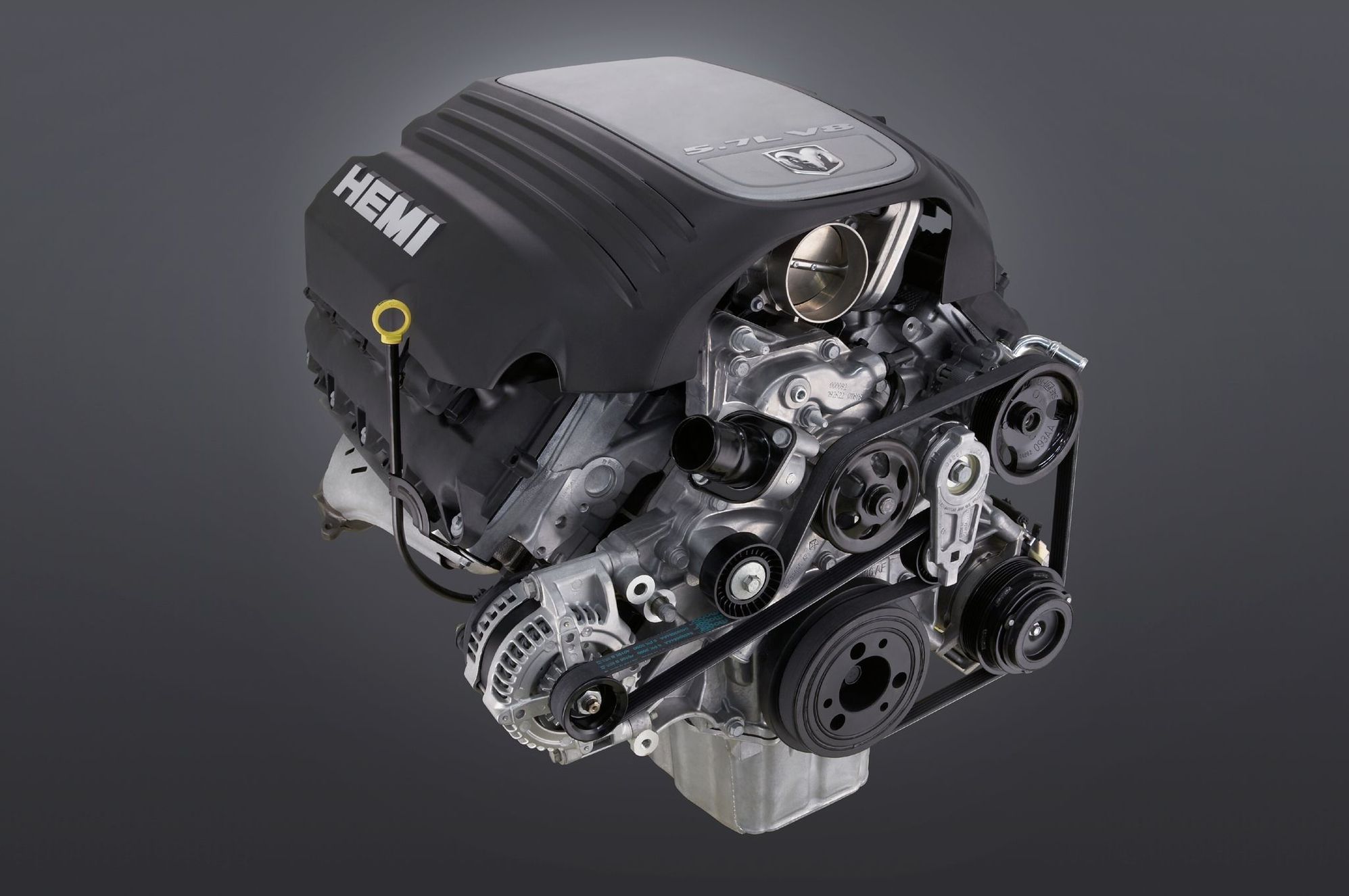

Did...did you not read ANYTHING I said...? The 02 and 03 use the SAME electronics. Just because they both use the word 'hemi', doesn't mean it will work any better...
Ok, words are apparently not working. Let's try pictures....this is what the 2003 was built with:
And this is what you wanna try to shove in it...
Then factor in a two generation spread of electronics.
