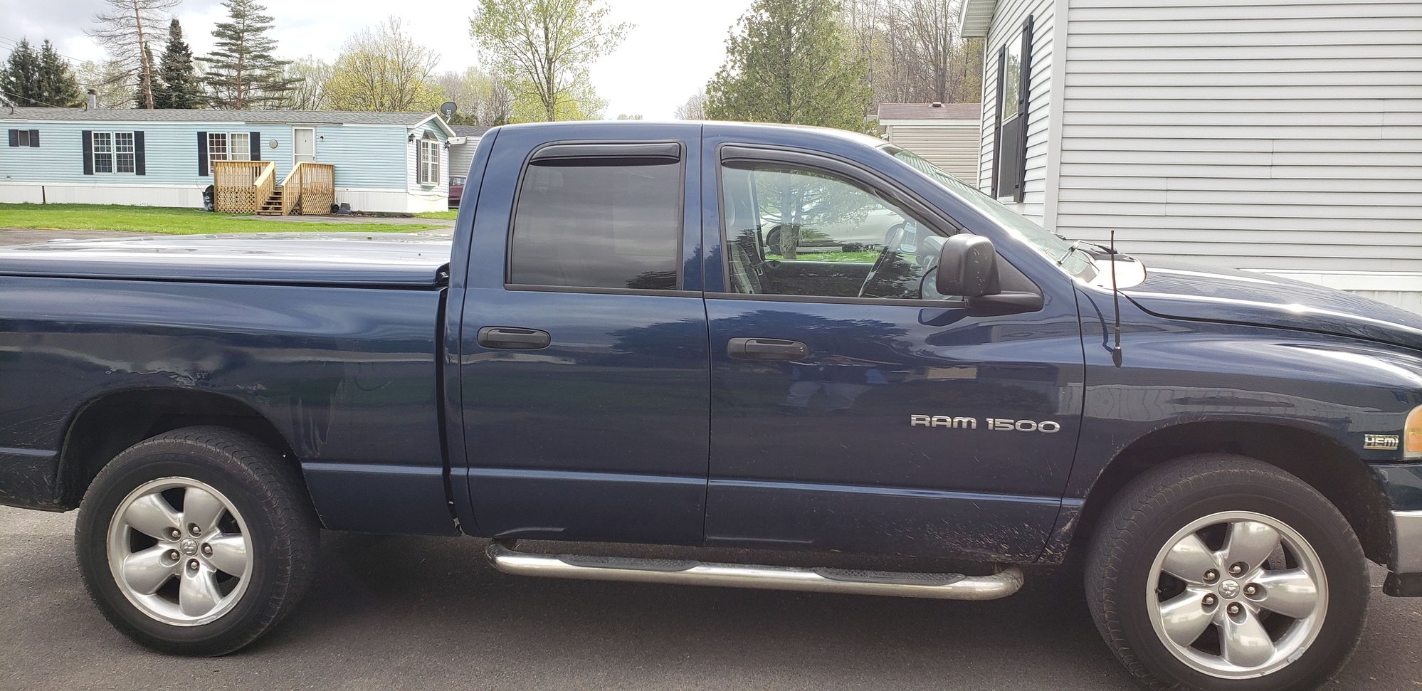

I have a 2004 Dodge Ram 1500 5.7L that stalls out of the blue without throwing any dash lights. Have replaced the EGR valve twice now as had the engine light come on and would come up on the code reader. Cam shaft crankshaft sensors have been replaced also. I have cleaned out the carbon build up on the throttle body...replaced air filter also. Could it b bad wiring on the sensors....any suggestions would b helpful...Thnx
