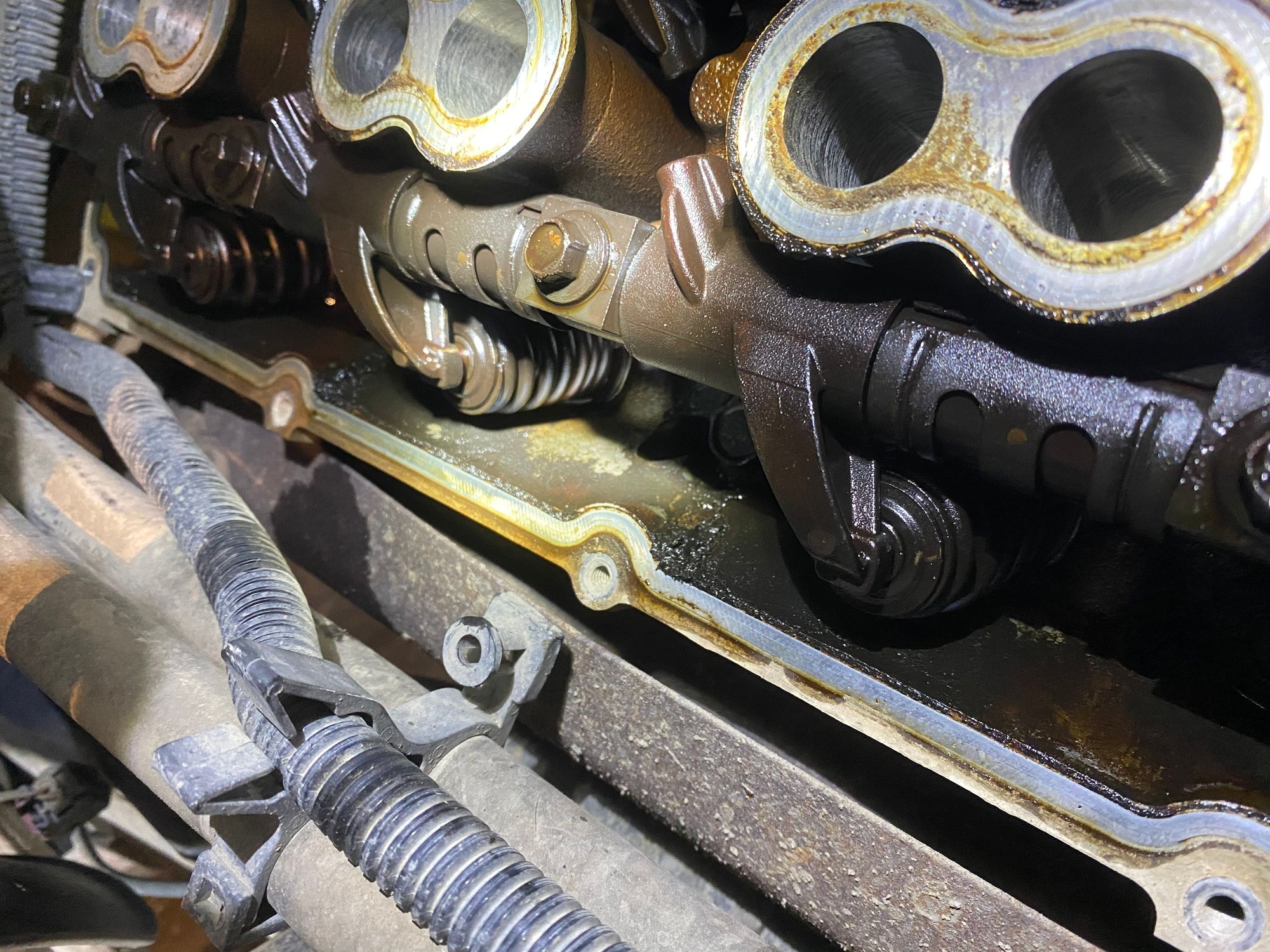

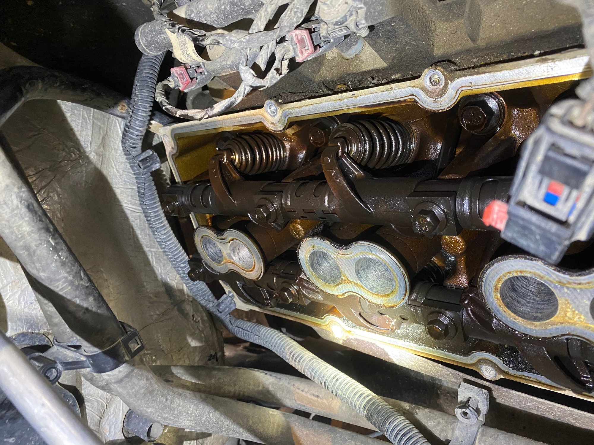

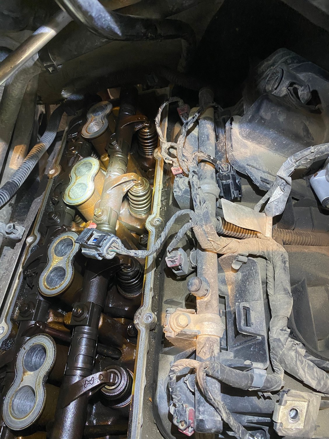

Took cover off. Rotate engine a few times. Rockers seemed to go up same height. Hooked it up to air compressor. You can hear a small about of air leaking out. Took a lighter around head looking for the flame to move. Nothing. Push rods looked good. Anything else to look at?

I think I'd get both valves closed on that cylinder, then use one of those spark plug fittings to add air to the cylinder and see if you have a valve sealing issue. Below is a lisle from Amazon. Probably can grab one locally pretty cheap.

Default Removed rocker arms
Used my compression test hose again with compressor. Valves are closed and can hear air leaving but can’t tell where. Not coming out throttle or exhaust. Nothing on head.
Would a bad injector be a possibility?

Might be just getting by the rings, how much pressure did you use to test with? You already swapped the coils and the misfire didn't follow, right? Perhaps time to swap the injectors and see if it follows the injector. Probably a good idea to get new o-rings beforehand.
