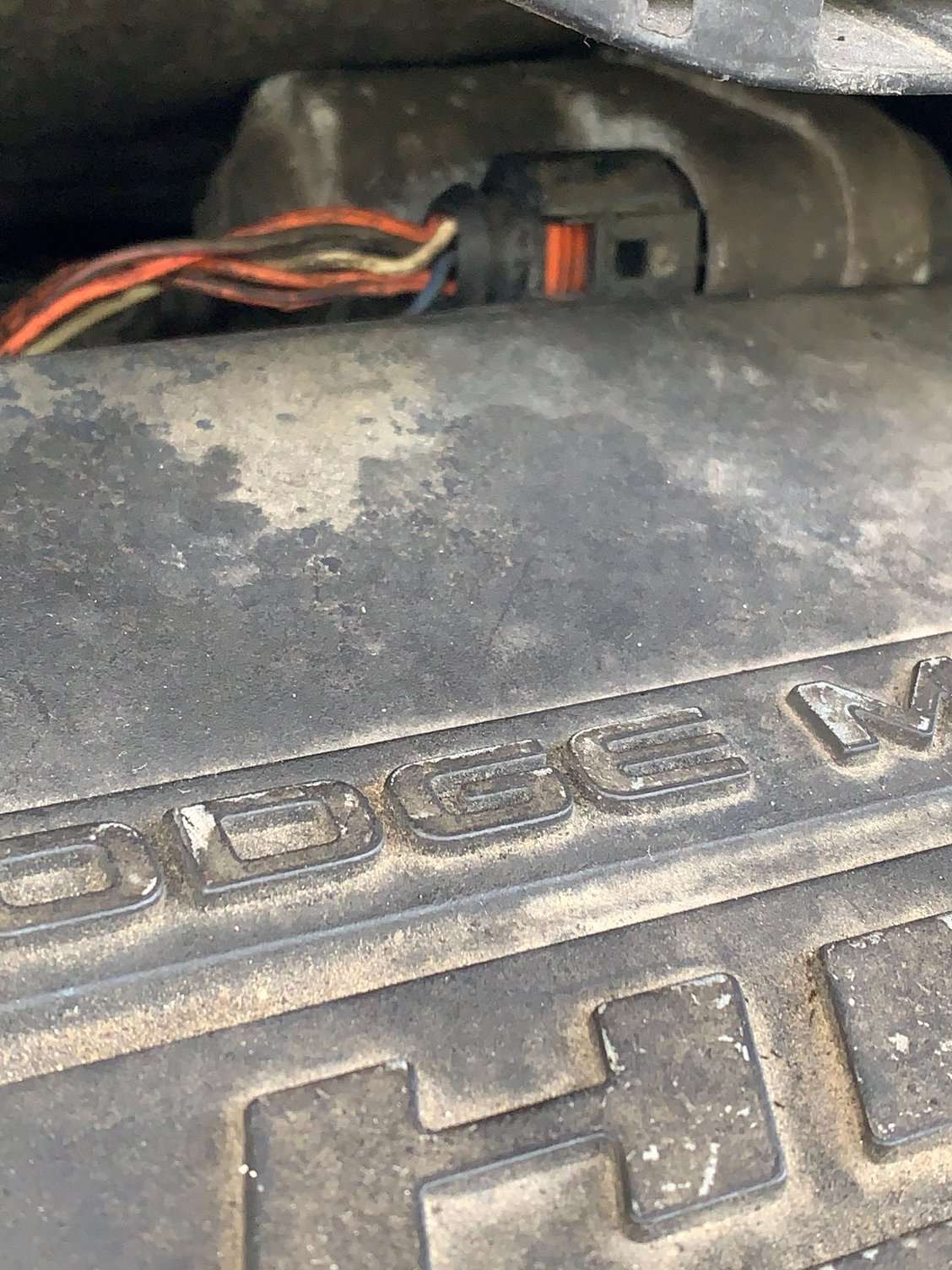

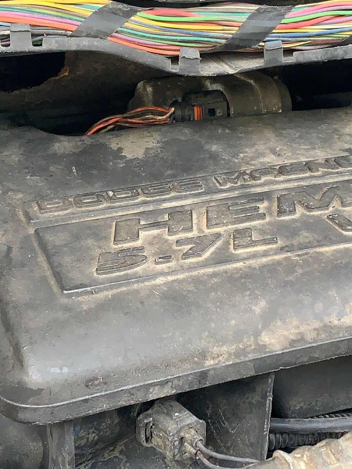

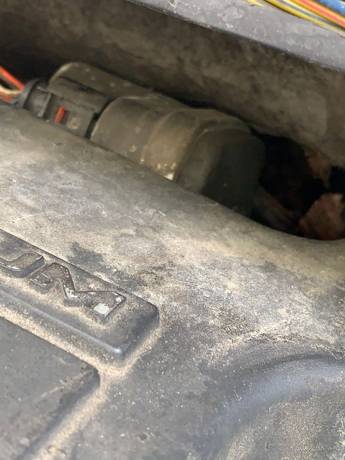

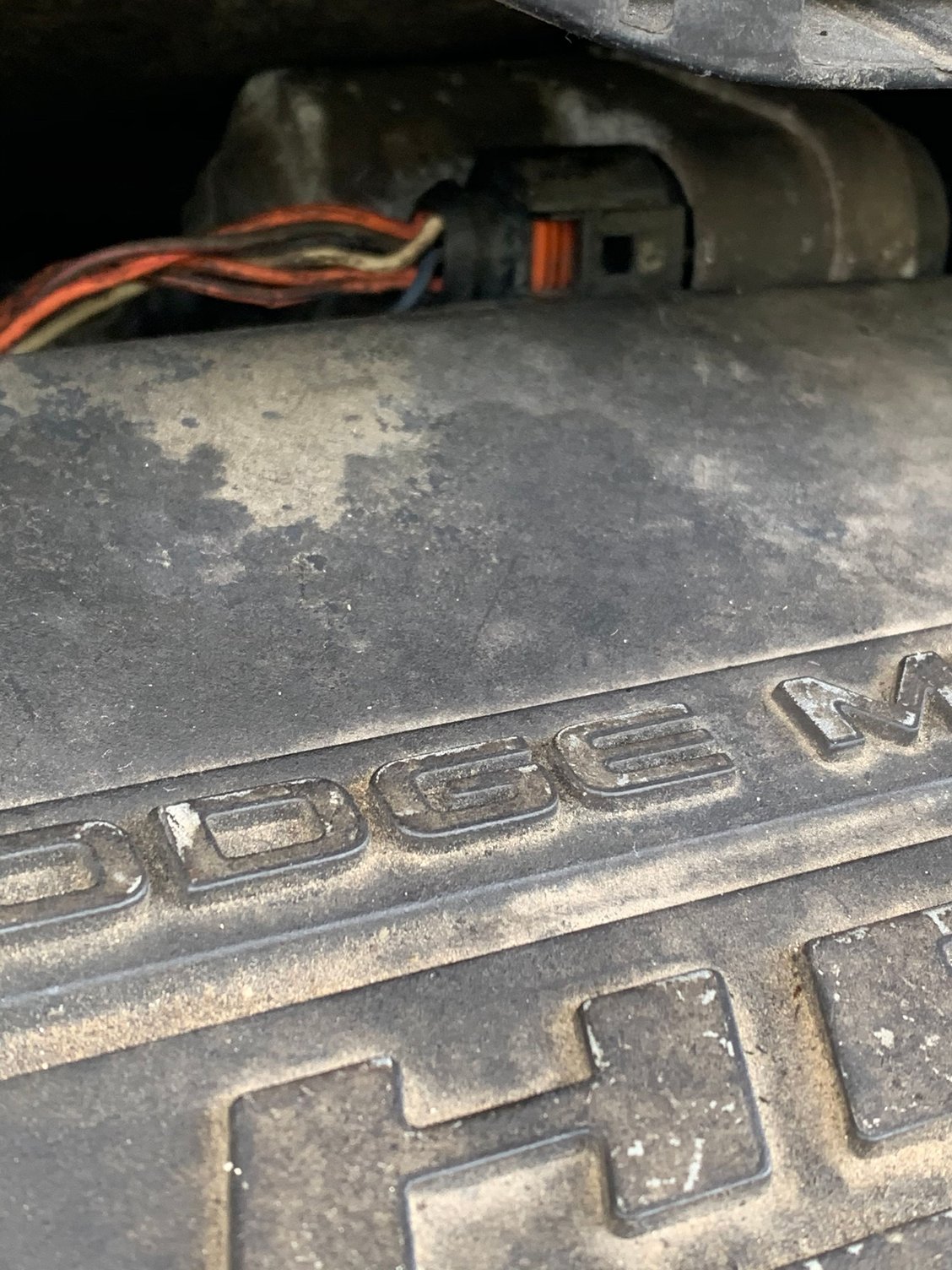

I have an issue with the wiring connector that plugs into the side of the throttle body. I did a bunch of searches but I can’t find anything about the name of that connector and the people at auto zone had no idea even when I handed them the throttle body. Any help would be much appreciated.

Jun 23, 2020 | 12:53 PM
TPS connector? Can you post a pic?

Jun 23, 2020 | 01:55 PM
Idle air control motor??? Not really sure.

Jun 23, 2020 | 02:39 PM
See if Throttle Body Position Sensor connector is what you are looking for. Mopar #5161920AA

Jun 23, 2020 | 10:02 PM
It's fly by wire, literally in the 2003 service manual, page 8P-8 "servo cable". Everything everyone listed is internal to the throttle body itself lol.
(8) Connect servo cable to throttle body. Refer to
servo Cable Removal/Installation.
