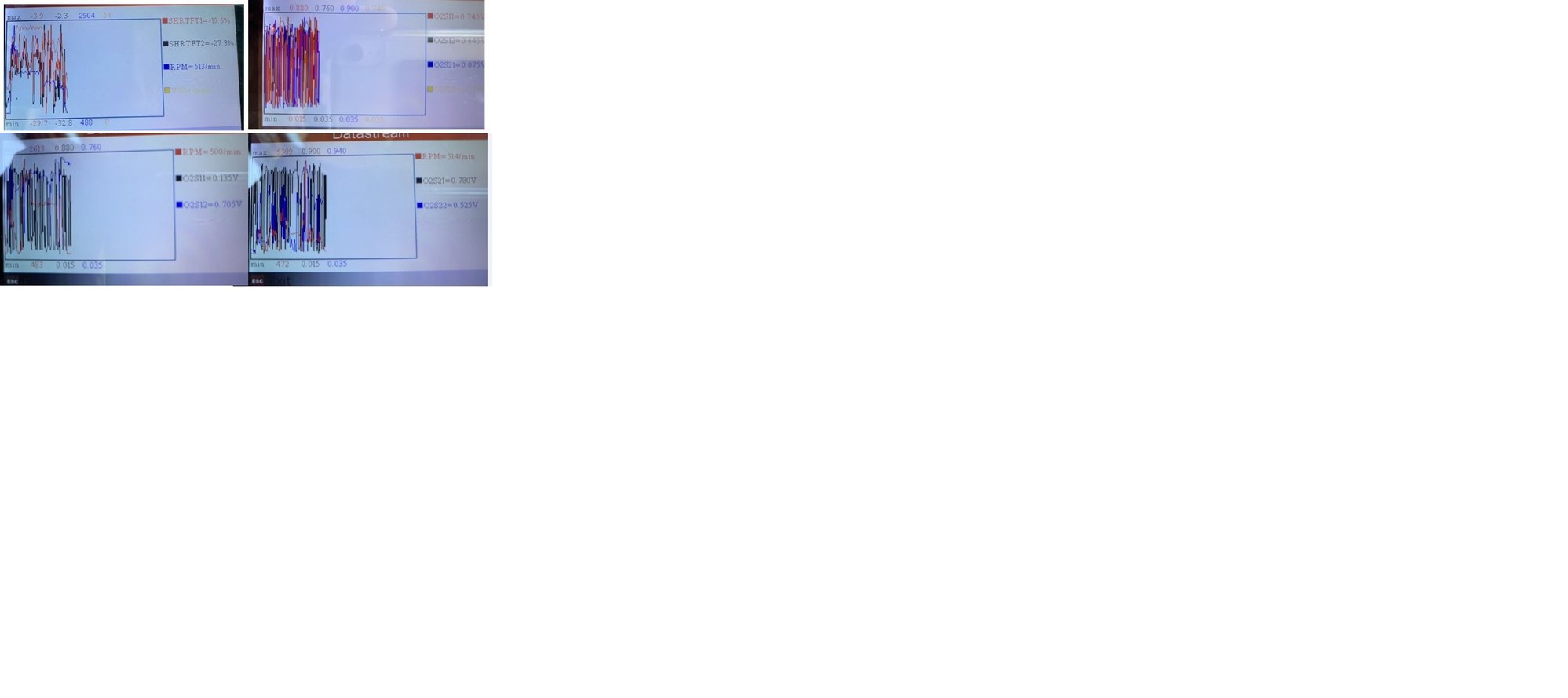

These maybe hard to sort through but is there anything that catches your eye that I can capture specifically?
various drives 0-50 mph

Pictures are a bit small for me to be able to read..... My eyes suck.
