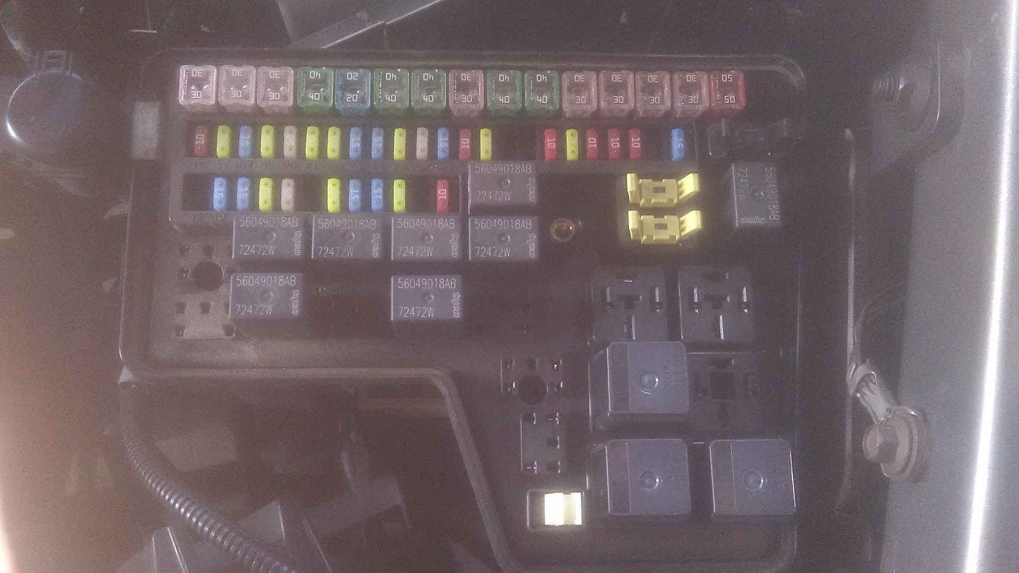

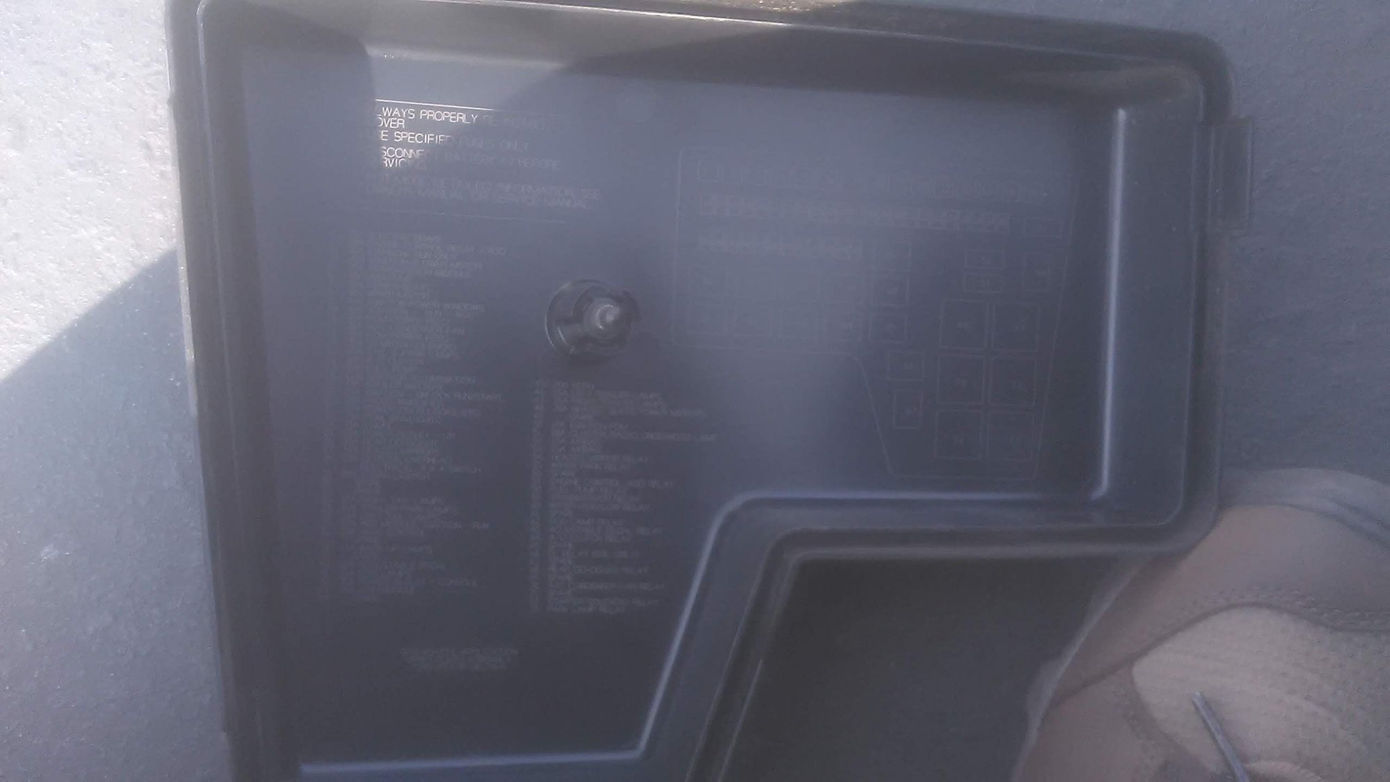

Old Sep 20, 2020 | 08:36 PM
Pelicansplash's Avatar
Pelicansplash
Joined: Sep 2020
Posts: 155
Default RE.
Starter Fuse and Relays
are not interested too TIPM board.
And testable and replaceable.
Pictures should give a good idea about my TIPM.
​​​​​​So these relays are expansive fuse is not.
Can these relays be tested.?

Posts: 155
Fuse # 14. Starter fuse. Pink square at very top second one in towards the left. ..
​​​​​Relay #72 Very bottom left square box style relay. Starter solenoid relay...

Default Intermittent crank no start - then cranks and starts on second attempt. 3rd Gen 5.7
Here are some pictures of my TIPM. So how do I go about testing the starter fuses and Relays to starter solenoid relay ?
I'm happy too discover that these fuses and Relays are not intergrated into the TIPM board. Issue is
Crank No Start on first try then Then crank and start on the second try.
Old Sep 30, 2020 | 07:33 AM
Posts: 87,482
Swap the starter relay with another one. See if the problem is gone.

Default Sealed the two relays and guess what ? ? ?
So I did swap the the relays with one another.
Then tried too recreat the( Crank No Start then Crank And Start on second Attempt ).
It started every single time 10 times before test Drive and 10 times after.
I tried turning key too on and waiting for all dash lites to go out. It started just fine. Repeatedly
Then I tried turning key all the way too run and start. It started just fine. Repeatedly. Thankyou for
the swapping suggestion.
I also double checked wires at the starter and starter solenoid. Clean nice and tight. Thankyou for the suggestion.
So now my next question is what online parts retailer should I use? OEM replacement or equvivelant.
and would like to know which brand is top dog.
Orieleys wants 22 bux a piece And Won't do a confirming volt meter test on my relay.
I need two of these relays..
Old Oct 3, 2020 | 09:55 AM
Posts: 87,482
Any of a number of mopar parts sites. I think they all use the same database anyway...... at least, their sites all look amazingly similar.
