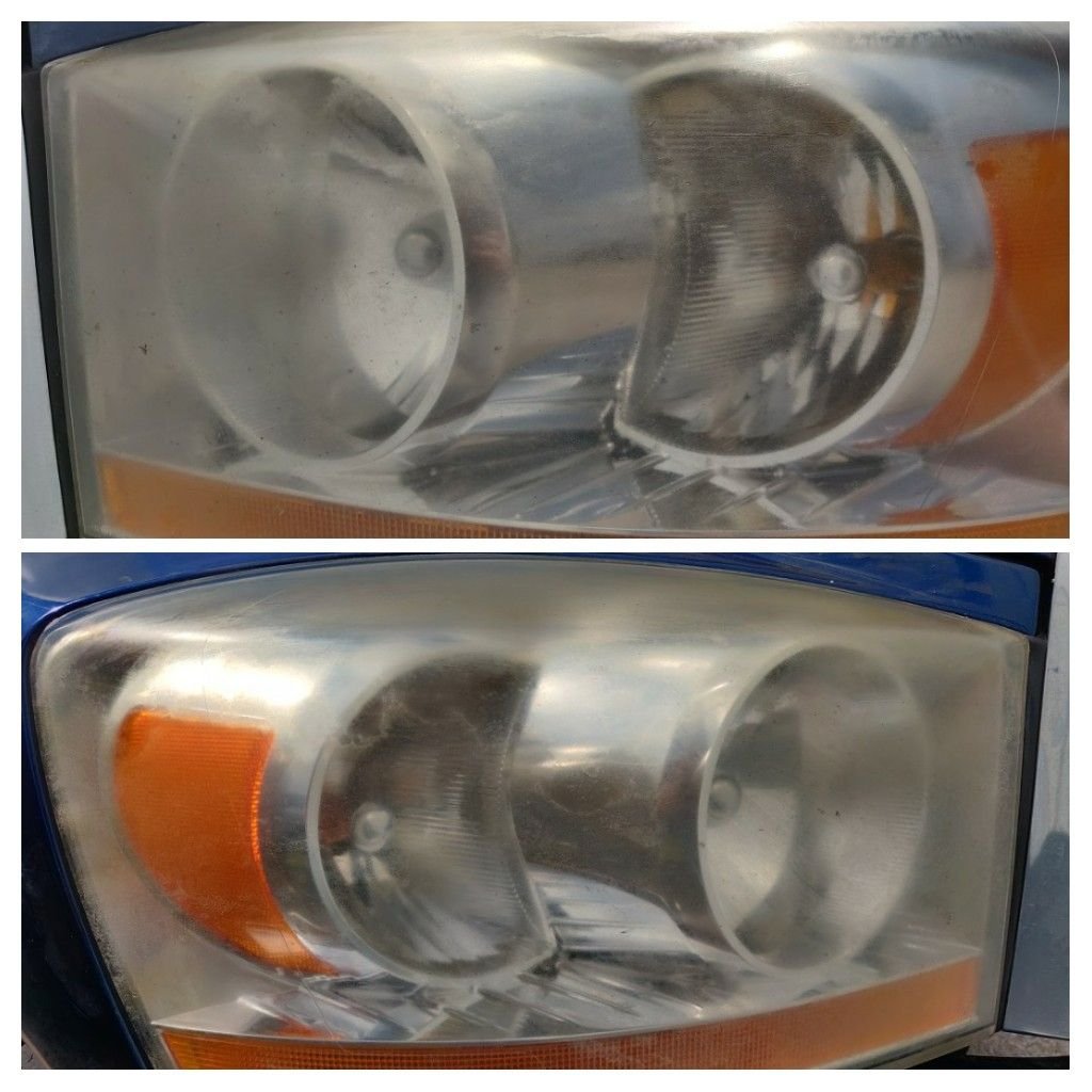

Alright so slight change of plans. I am still sending both sets back for a refund but I decided to give the WD40 trick a shot since I planned on replacing these housings. I originally thought the cracks went all the way through these housings. They do not which means these housings can be recovered. There is a guy who does decent videos comparing various products. He did one comparing all the major brand headlight restore kits. In his test the Sylvania was the better result. The upside is he makes money from Youtube ad revenue and not product reviews so all his videos are self funded and nothing is sent to him free.
These are my housings that I will attempt to restore. One of the reviews on this products page showed promising results. His Grand Cherokee housings very closely resembled mine. I figure $20 bucks if it doesn't work oh well I can still buy replacements.

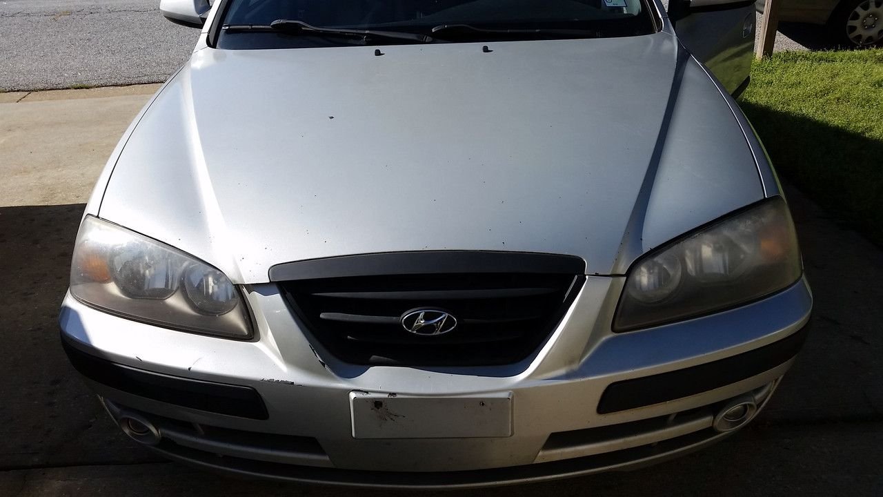

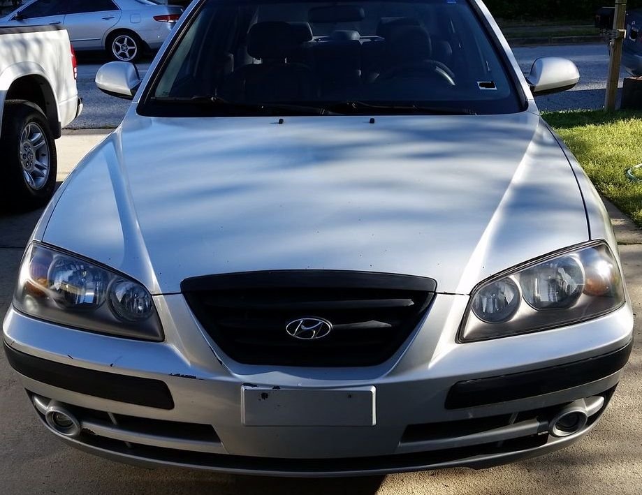

Yeah, I've done this. It lasts a few years with the clear coat. When I sprayed on the clearcoat, it had an orange peel effect, so I slightly wet sanded the clear coat with 1500 grit sandpaper, then polished it with a scratch remover.
Pics of an old Hyundai I did, before and after.
