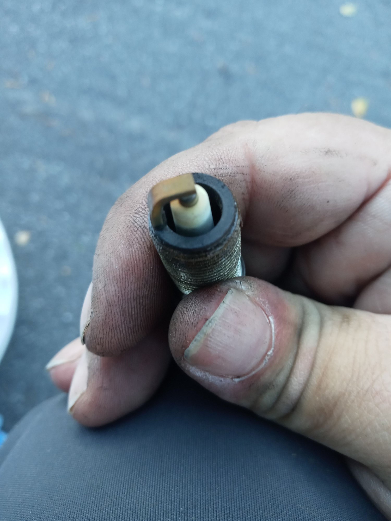

The spark plug photos are from calendar number 1 driverside bank booted spark plug
closest too front of truck.
It Smells like fuel/gas . But I don't know quite how too read plugs.
But looks wet around the bottom of threading.
What y'all thank.
This should be interesting.
Come one come all diagnostic comments and opinions.

Maybe running a bit hot, but, aside from that, looks pretty good.
If it IS wet though, that is NOT good.

Resistance for plug wires is 250 to 1000 ohms per inch of wire. For 33 inch wires your resistance should be between 8,250 and 33,000. Your numbers look good.
You mentioned that you were running iridiums, the plugs in the pictures are the standard copper champions. They don't look to have many miles on them.
If the plugs are wet and smell like gas, then I'd recommend that you put in new plugs and make sure they are 045 gaps. Also put in new air filter and clean the throttle body. This will help with air flow and hopefully address rich condition.

I pulled just the one spark plug. From cylinder 1 . Electrode looked dry and in good shape.
it was the base of the threading 1st. Thread or 2 that looked a bit wet.
