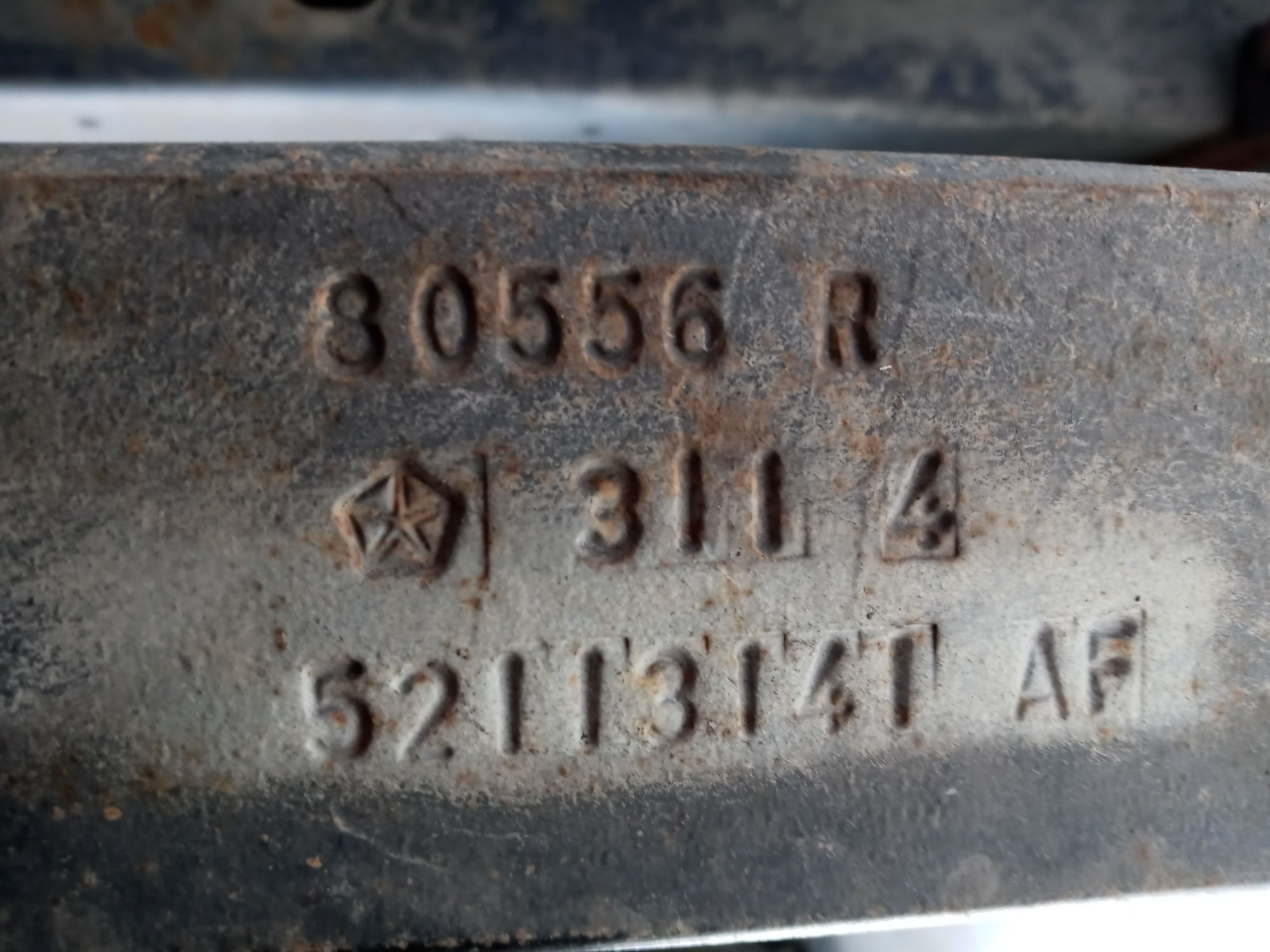

Okay time too tackle suspension issues. With that said the picture showing my problemOn both right and left Leafsprings. Rear end felt dumpy before and after i installed my BillsteinsShocks. A bit better but my leafsprings tell the story. Tires keep feathering. So what are my options ? Im keeping stock ride heighth. No leveling or lifts just stock. But one step better thanFactory . Im wanting to rebuild steering and suspension with a kit . I have highway speedVibratiins and a wondering problems ? Thoughts ideas advice is needed here thanks.
Left rear leafspring
New bilsteins and old leafsprings 89000k miles.
Factory stamped leafsprings.

So, do you want stiffer springs for better hauling/towing? What do you mean by "Better"?
Reply 0
Feb 1, 2021 | 01:24 AM
Quote: So, do you want stiffer springs for better hauling/towing? What do you mean by "Better"?
YES better hauling/towing. While keepingStock ride height . Maybe re-arching andAdd a leaf ? Or purchase new 5 leaf
leafspring.. ?
Reply 0
Feb 1, 2021 | 09:31 AM
Fair few companies make leaf springs for trucks. Spring rates, amount of lift, etc, are all customizable. Might even be a local company that does it for you, depending on where you are. (there was one in Toledo Oh, when I needed springs a few years back..... no idea if they are still there.) Check with companies that make lift kits as well. Likely they can do something for you.
Might check with the dealer, and see what is available from them as well.
