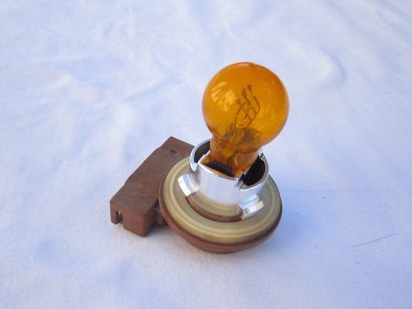

Ok, just found out that when the headlights are on, that is when there is a problem.
When the head lights are off there is no problem!
That helps I guess, and points to the headlights and as you say the turn signal sockets?
All info is good I guess.
Should be able to get new sockets if needed, but still wondering why the new sockets in the TYC assemblies are a problem???

It was a number of years ago... I think the wiring to the socket was configured wrong??? If your smart with electronics maybe you can figure it out? Otherwise go to junk yard... make sure to get sockets from OEM assemblies... 99% sure that is your problem.

Sorry must of been mistaken with the wiring? ..memory not very good anymore ! Check amazon reviews lots of complaints about TYC headlight..

Thanks for the link, THAT, was what I was looking for, was a history of this problem with TYC headlight assemblies.
They do make the best after market that I have found on a number of items and use them if I can!
Thank you VERY much for the link and the help!!!

Bought some new OEM sockets from Dodge, installed them yesterday and problem solved!
I don't like to just change parts, rather test/troubleshoot, but after everyone having this problem, with the TYC assemblies, on AMAZON...
Was pretty apparent, that was the problem.
