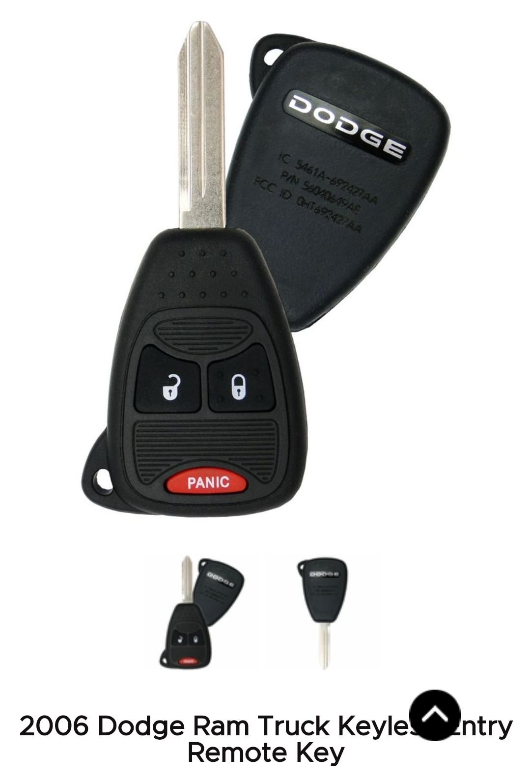

I currently have an 05 dodge ram that has a key with a phob on it (picture 1) I would like to switch it to a key that has the buttons already on it (picture 2) because I don't want to have a big clunky phob. Does anyone know if this is posable. I have been reading about sentry keys and transporters and it's really just making me more confused haha

The electronics are different. I tried to do this, but because the elex weren't compatible I went with with is this: https://www.ebay.com/itm/2-1-Buttons...p/293023686711
You just swap your fob guts in and get the folding key cut.
Thanks man I'll give it a shot!
OP, something to consider.
I believe your gray key has a transponder chip in it. That would also need to be dug out and swapped over to the ebay unit, unless you're going to throw security to the wind and tape it to your steering column, somewhere. Make sure ebay key has a place for that.
Personally, I think the size of that ebay unit makes it a downgrade from what you already have.
Is that key gray? I thought it was black. If so, then yes it has a chip in it. What alot of people do is stash the key somewhere close (even under the dash, one guy I talked to put it in the column lol) so that SKIM still gets a signal. I imagine trying to separate the chip from the key head would probably damage it. I have a black key so I don't have this problem.
Is that key gray?
Well comparing the black fob next to it, sure looks gray to my old eyes. Not sure if that's what OP actually has through.
