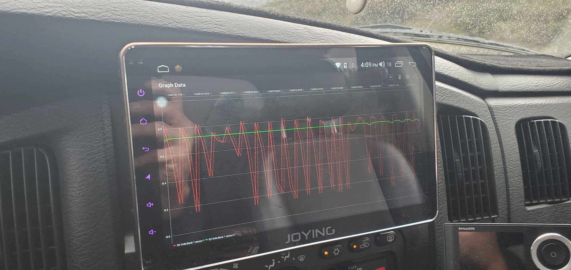

New fuel pump is installed. The design was even different between the two. This pump is noticeably quieter in the tank.
The two pictures show my Up and downstream o2 sensors before the pump and now after, cruising at the same speed on the same highway. That's a pretty dramatic change there.
I know it seems like I have an answer for everything but i've been going through the motor lol. The injectors were out last week and bench tested. They all flowed well with no obvious occluded spray patterns.
Old fuel pump, for the 5.9 Magnum, highway cruising 65mph
New fuel pump, for the 5.7 Hemi, highway cruising 65mph

That is one nice live data reader you have. Is that integrated into your audio display?
The first picture is what the oscilliscope reading should look like with downstream doing all the work and upstream smooth. In the second the downstream is operating at its limit.
This change is result of new fuel pump?
