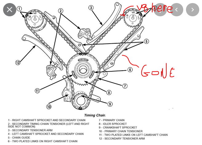

Well this is disheartening, I replaced the battery as I said, and once again it kinda would start but just didn't sound right. I went back to my gut feeling it had something to do with timing (mechanical) So I got out the Service manual set it up for TDC. But when I was cranking it over by hand I hear something catch then release, and I knew something was up. I released the new cam shaft and crank sensor I had installed just in case I got a bad one. Nope wasn't it. So verified my right bank (passenger side) timing and it was perfect. I had had the valve cover off a few times so started there. 4 hours later (getting the left valve cover off) I noted the timing indicator on that side was aprox 90 degrees off/ behind the other timing mark. (see Pic) Yup it had jumped timing.
Then upon further investigation I noticed my chain guide for that side was no where visible. Big sag in the bottom of the chain. The tensioner on top was in place. Now for me this makes sense. When I originally removed the old oil pan I found a piece of whiteish plastic in the bottom of the pan. I was curious about what it was but saw no indicator where it came from. Now I know, I am assuming my chain guide broke then was slowly chewed up and made it's way into the oil pan. I hear these are interference motors, what are the chances I did not damage any valves being 90 degree behind? I really would not have a problem doing a top end if needed, but because I am in New England every bolt is ready to snap or corroded so bad nearly impossible to get off.... That's why it took me 4 hours on the valve cover, bolts were rusted so bad some had to removed with a 9mm instead of 10mm...
