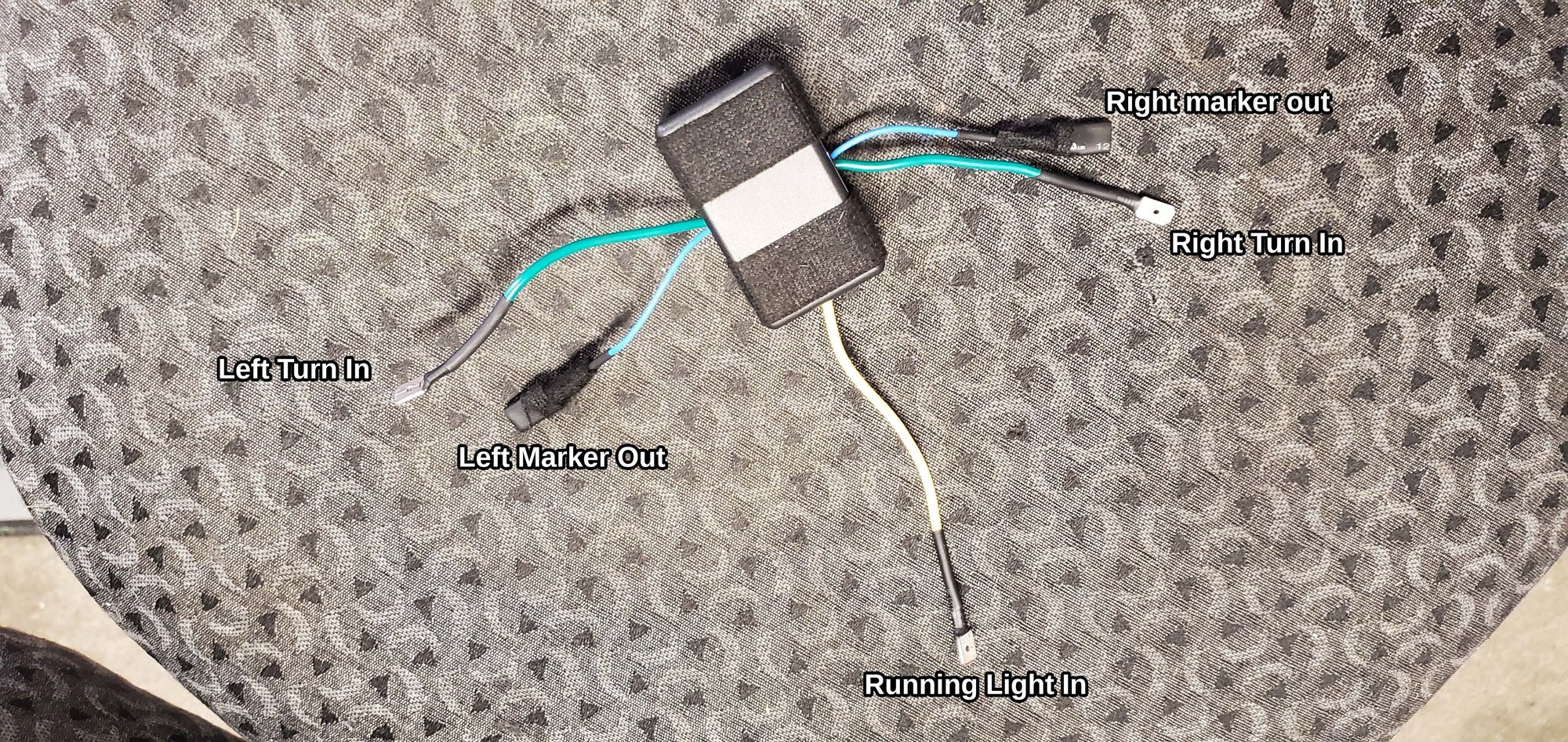

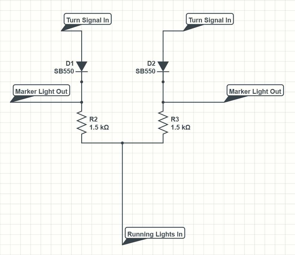

Same lights as the turn signals... I built this little unit. 2 diodes and 2 resistors. The resistors limit current to the lights for the running light portion, which dims them slightly. Then the turn signal inputs pass through a diode, and out to the marker light bypassing the resistor so it flashes full brightness.

Well if you'll excuse me i have some parts i need to get stat. What wattage did you use for the resistors? and did you use relays or is the LED draw so small it wasnt critical?

I used what I had on hand, which was a pile of small 10k resistors. Ganged them together till I hit about 1.5k-1.6kohm effective. A single 1.5k 0.5watt should probably work the same. No relays, the small led's draw almost nothing.
