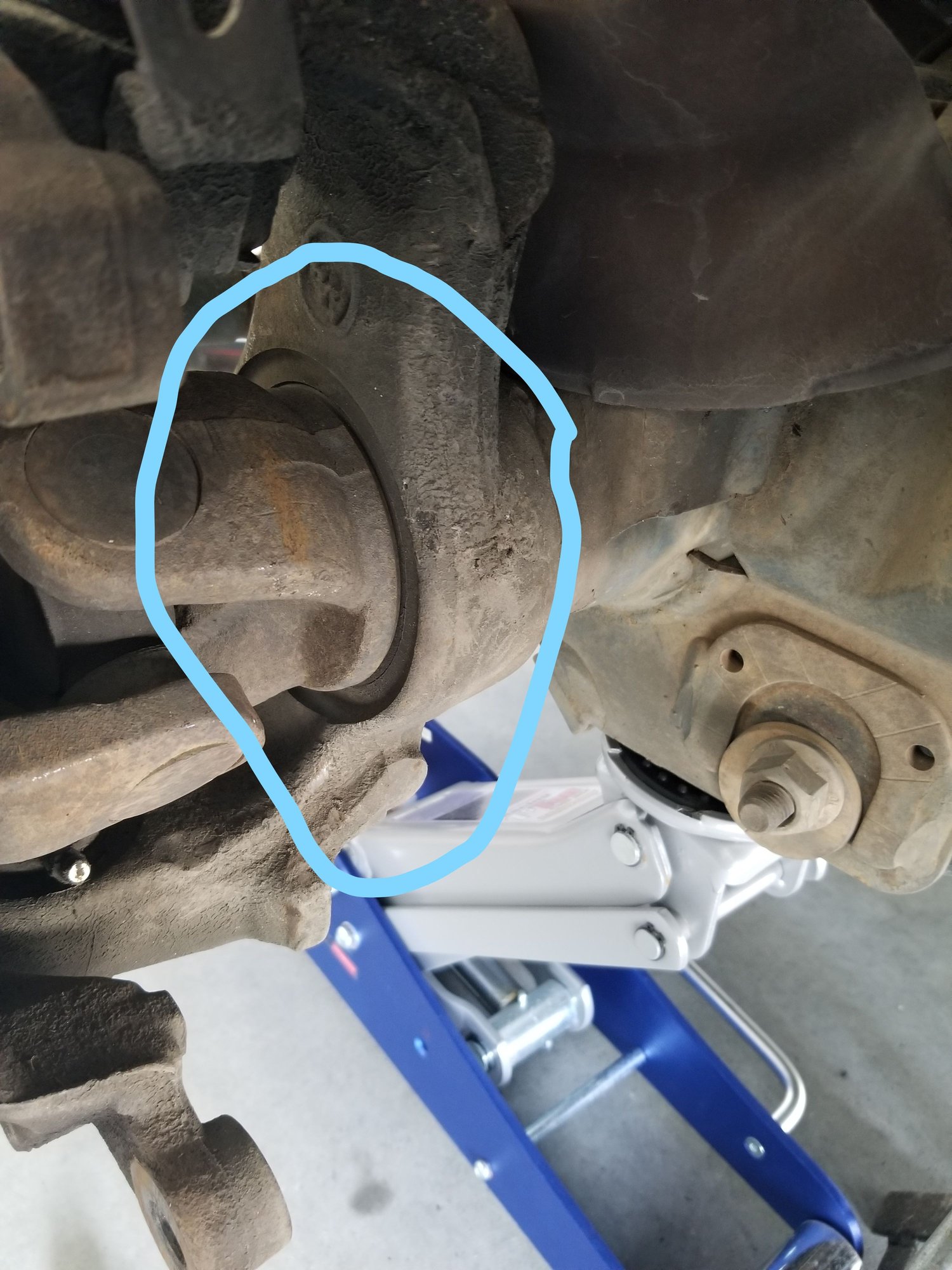

when wheel bearing assembly is removed, should there be play/slop in the circled housing?

Yeah, that's pretty normal. The axle isn't supported at the ends of the tubes, just held in place by being bolted to the hub/bearing. And remember, the axle nuts are what hold the hub/bearing together, and are torqued to some truly stupid value. Make SURE it is properly torqued, else you will have premature failure of the bearings. (or, worst case, lose the whole tire/wheel/bearing while driving. That is NOT fun. )
