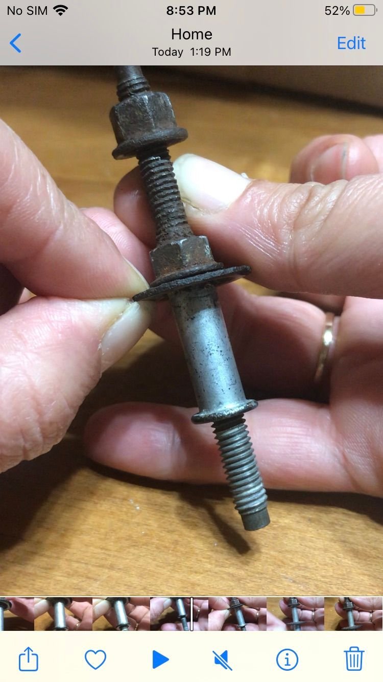

.375 is 3/8 so 3/8 x 16threads per inch, 1 inch long is how i decipher that. however that bolt looks nothing like that, also I would expect it to be metric no sae
but like mentioned above if you can salvage a good one go to the hardware store and match it up. It looks like the isolator sleeve may be removable and used on the next bolt?
