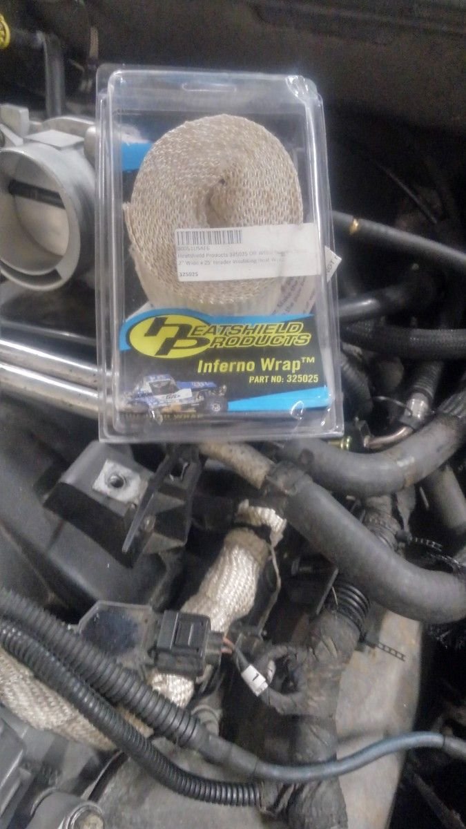

So to wrap the fuel rail... what product are you guys using? Pics?
Old Jan 23, 2022 | 08:54 AM
  #38
steve05ram360's Avatar
steve05ram360
Joined: Jan 2004
Posts: 12,946
Likes: 309
Since 1st jumping on this band wagon way back in 2001, I've used DEI thermal tape https://www.designengineering.com/co...e-tape-2-x-30/ which proved to work excellent but was a PITA to install. Starting with the R53 mini I had before the Dak, I decided to experiment with exhaust wrap https://www.heatshieldproducts.com/i...hield-products I cut a chunk of this stuff, dropped it on a small sheet of sheet metal and hit it for a good long time with a heat gun, then pulled the piece and looked at it with a thermal cam. Looked good to me so installed it with success on the R53. Found similar success on the Dak. Way easier to install, easy to remove and plan to re-do it when I yank the rails for new 4 hole injectors.
home depot - frost king 2” roll foam/foil backing and a bag of 4” zip ties
be mindful around the positive alternator post at the front of the drivers side rail.
insulate with injectors removed leaving the injector clip areas uncovered …
I laid two pieces the length and the. Wrapped around to cover that one up… then Zip tied it all into place.
