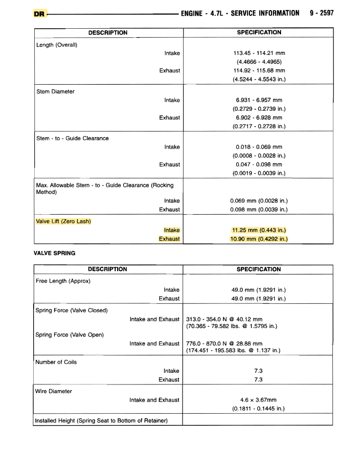

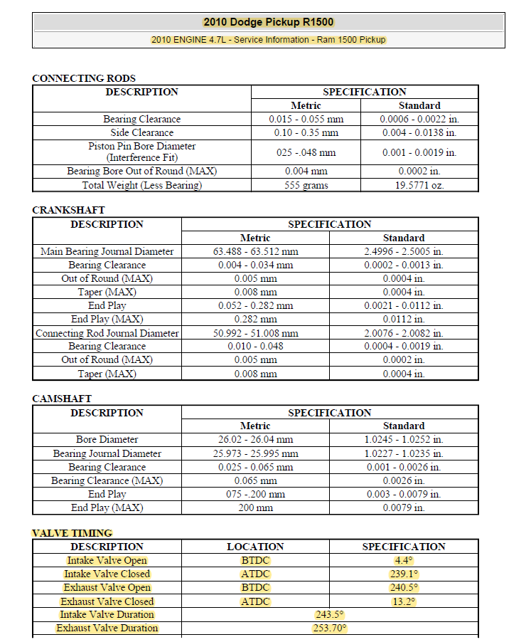

1. Still a 4.7 lol.
2. Unless there's a dyno sheet, the seat-o-the-pants-meter is wildly unreliable but if it makes you feel better......
3. FYI Nick from Air Ram died earlier this year so that resource is gone.
4. Don't bother with the 08+ cams, I had occasion recently to look up the actual specs.....the power increase in the 08+ was done with the heads, more compression and the intake manifold:
Early 4.7 cam specs: .443"/.4292", 243.5°/253.7°, 17.6° overlap (found in 2004 Grand Cherokee manual)
HO cam specs: .4724"/.4292", 236°/250°, 18° overlap (also found in 2004 Grand Cherokee manual)
08+: .443"/.4292", 243.5°/253.7°, 17.6° overlap (found in 2008 Dodge Ram manual and confirmed with 2010 Ram manual)

Thanks for sharing the cam specs... you indicate that the early 4.7 cams are = to the '08+ cams, is there a typo in there? '08 cam installers claimed it was a good mod.

Straight out of the service manuals. I had always heard they were an improvement....turns out everyone was full of ****. Feel free to look for yourself, the manuals are easily found. Here are screenshots:
2004 Grand Cherokee standard 4.7:
2004 Grand Cherokee 4.7 HO:
2008 Ram 4.7:
2010 Ram 4.7

Don't mistake HO cams with the 08+ (apparently you've misread this). HO cams are a good upgrade, the 08+ cams are the same as the normal 99-07 4.7's.

Took a look at the 2001 Dak manual this morning & it indeed matches the '08 & up specs as you mentioned. Thanks for pointing that out.
