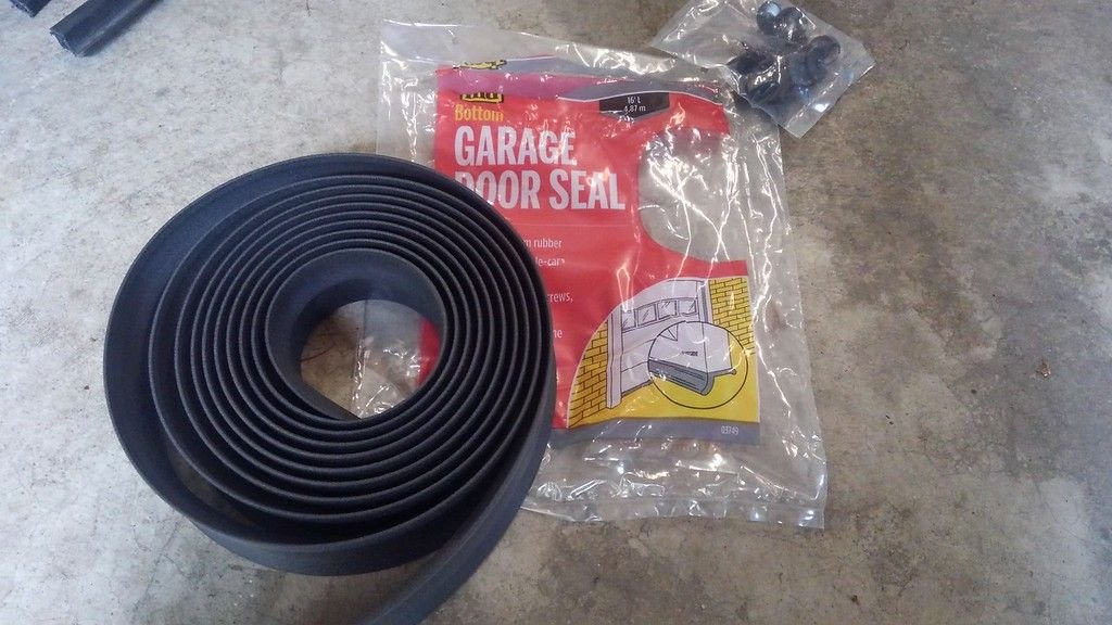

Right off the bat you could go do the bed seal mod and should see immediate change in drag... below is a pic of how I did it on the Ram. You would need to find an appropriate seal and good double back tape to get it in place on the Dak bed... You want to take the seal down to the upper part of the bumper, look at the body line on the ram pic and how it meets the top of the bumper. If you go below that line (on the ram) the bumper becomes a parachute and will add drag. $20~25 bux for the garage door seal and tape at home depot so ROI is quick. Mount the seal on the bed and do not allow it to touch the cab. You would have to look at the seal to see how the coverage would be. On the Ram, I used a seal off a 2014 or newer 1500 Ram. Slides on in seconds. There is no lip to mount this type of seal on the Dak bed.

IIRC there are already 2 smaller seals between the cab and bed.
I will try tomorrow if i could make this mod, so between the cab and the bed, from the top of the bed to the line as you described.
The rubber seal may not touch the cab ? why is that ? i have some seal laying around, but i think it's to wide and it will touch the cab, maybe i will cut it so it's clearing the cab.

the seal will rub the paint off and opens the door for rust. Also, minimal benefit to getting it that close, the air flow down the side would get disturbed and detach from the bed and become turbulent which causes drag. On the ram I have an approx 1/2" gap to the cab from the edge of that seal. Noticeable change in drag in the seat of the pants feel.

If you have a way of data logging the calc load and have a rolling hill route you could test the seals before and after, look at the data to see if there is a change in the calc load. That is what I plan to do when I get to it. One thing I noticed the other day looking at it, if you have the wheel well flares on there, it might actually cause drag right there so it might need tweeking. On the horizontal bed seal, on the ram I found it caused additional drag, enough that it was noticeable. You might also want to play with that one as well. I did not see on on my Dak but I still plan to test it as each truck design is different.
