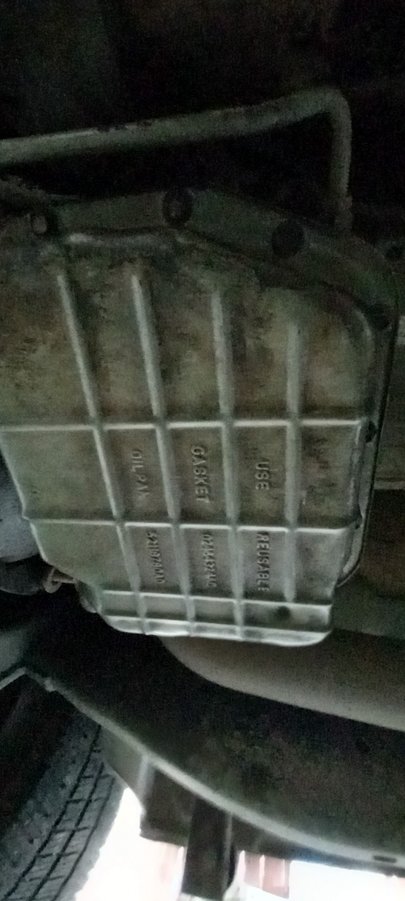

46re I think
it has a corner that sticks out on one end like a turbo 400 and a 45 degree cut corner at other end
My pan but im still not sure what transmission it is

Originally Posted by Randyj63
46re I think
46 never came behind the diesel. Gotta be a 47, or 48.
Supposedly, the 1st gear band isn't used for 1st gear when the shifter is in drive.... it only engages in manual first. You already changed the parts that I would suspect first..... No idea if the output speed sensor would play a role there.

Is that the 48RE?
I think it's 42re p52854096aa tag on side
did that come on my truck
Part number comes back as a 48RE. Which is what I expected.
Need to have pressures tested, and see if they agree with what the electronics are telling the PCM.
