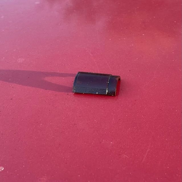

I pull the pan today and found this
What do you guys think it is and could this be why I had no oil pressure at idle? It is a plastic piece.
