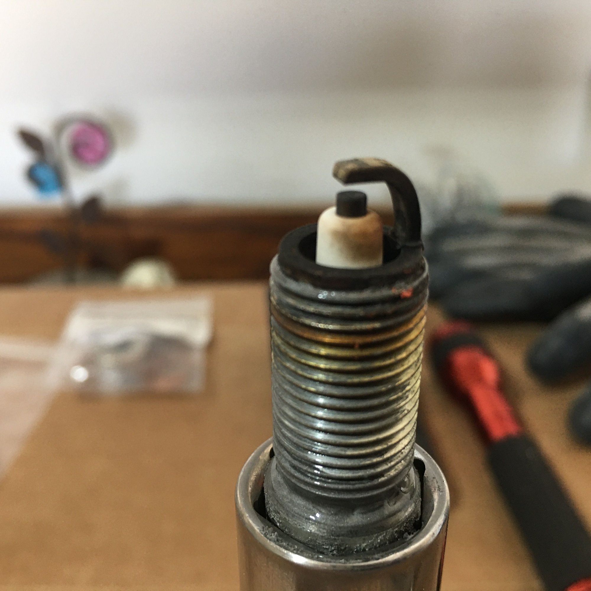

Checked for exhaust leaks & I'd say 99% sure there are no leaks. Checked wires and again no issue. I pulled all plugs & attached 2 photos which are similiar to the rest of the plugs. 1st photo is from bank 1 & second photo is from bank 2. If anything that I see is a fouled plug because its running rich.
I did not cean injectors & plugs are new Champion copper tip.
Old Apr 12, 2022 | 04:15 PM
Posts: 87,385
Likes: 4,211
Actually, the plugs look pretty good.
