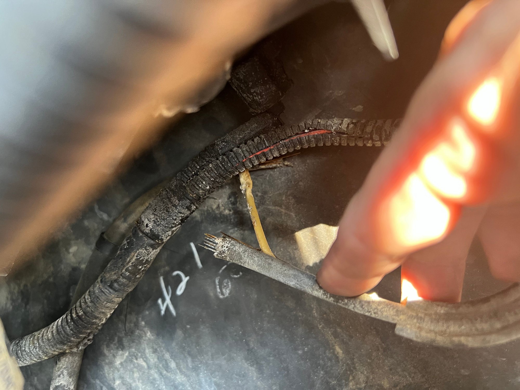

I wanted to check back in as I finally have some answers. It turns out that there is a code being thrown, and that is P0593 Cruise Control Multi-Function Input B Circuit High. However, there is no issue with the cruise control itself, so it could be a short or other wiring issue. The main issue noticed is that my accelerator cable is nearly severed all the way through! So, that’s fix number one IF I could find one! Not in stock anywhere and shows as back ordered (greater than 46 days). 2nd would be to take care of the code by replacing the Bell Crank housing assembly….except that part is discontinued as of 2020 and would retail over $400 if one could be located. 3rd would be to replace the throttle body!
In short, I need to replace 2 parts both of which cannot be found anywhere. Lucky me. If anyone has a lead on the following parts I would appreciate it!
Accelerator Cable: 52010447AB
Bell Crank Housing: 53032456AE
Thanks!
